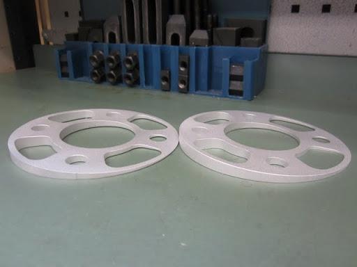

try something like these...
The 60mm centre bore not worth the extra money. Structurally, if it doesn't have the extended hub lip, it's not going to strain the bolts. You might as well buy the annoying little ripspeed shims you see in halfords chav ailse. As opposed to spending £10 extra for easier fitment
I would think just adding camber will make the tyres even closer to the springs.
They look good but as has been suggested I think adding camber may actually make it worse so I have ordered some straight spacers
