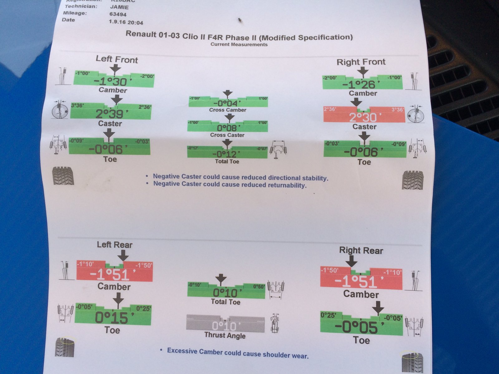

hi guys, going to be doing a few track days at Snetterton this year, would appreciate some advice on what settings to run? I've seen people run as much as 3 degrees? Car is stripped, new cup shocks and cooksport springs. I have camber bolts for the fronts and will shim the rears if needed.
  172
They would mate yeah but it's a ball ache as you have to pull the stub axels off. What did your rears look like? Mine where - 1.5 both sides which I'm happy with.
Mines 1.625 one side and 2.25 the other so was going to put a 40 minute shim in one side to make them both about 1.6-1.7
Sound ok?

This completely depends on the configuration of your car, as a rule of thumb, the stiffer your car, the more static camber you should run. We have a very stiff setup (470lb/in front) and we run 4 degrees. If you're on a fast road spring (250-300 lb/in), you're probably talking around 2.5 degrees on the front. We usually go a degree less on the rear (another rule of thumb) and that gives us a good balance.
As ever with tyres, drive it, measure the temps across the tyres, look at wear and monitor your pressures, then make adjustments accordingly. If you've got the wrong pressure in your tyres, camber will mean nothing. You want to be running 30 psi (+/- 1) when hot.
