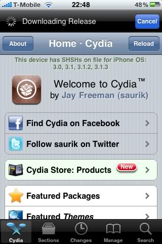

2) If Cydia has saved your SHSHs for 3.1.2 on file, you can follow the procedure on iClarrified to restore genuine 3.1.2 firmware.
To know if you have SHSHs on file, Cydia should look like this:

Ok, so Cydia doesn't have my SHSH, and Ive tried installing genuine apple ipsw 3.1, it fails when iTunes connects with apple servers?! Error says my device s ineligible. Is there a way around this, or am I doing something wrong? Do I need to remove cydia or my unlock prior…
Andy I'm part way through dl'ing your ipsw, but rapidshare hates me.
You can only install firmware older than 3.1.3 if your phone has SHSH stored with Cydia, otherwise the Apple servers will only authorise the current firmware.
