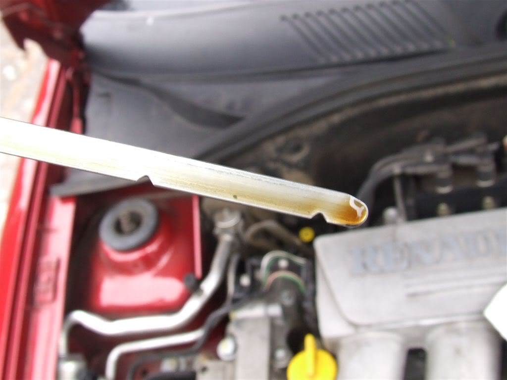

Can serviced, no/very little oil in it??
DrR
Car  VW Golf GTD
Is this right? is the oil super clear or is there no oil in my car?
was the car warm?
it will expand once warm and possibly seem to rise...
Yep..must be cold and on a level surface to get an accurate reading
cold?i always though the car should be warm before checked, as thats the level it will be at when being driven?
It's fine, me being paranoid, car says it's full on the dash :)
Don't test it when it's warm/just been driven as the oil is spread around the engine and not all drained back into the sump where the dip stick is.
^^^^correct that man,also never check the level from the dipstick when u 1st pull it out,always pull it out,wipe it off and check again
aha!
thanks for the corrections not sure where i got warm from! although i think i may be getting confused with checking and changing oil!
