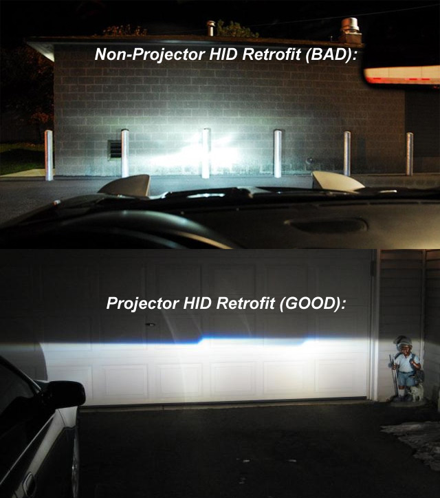

Please make sure if you're getting HID's, that you're getting projector units too.
You will be blinding other road users with the HID in factory reflector housing and the light pattern will not be as good compared to a HID in a HID projector unit.
But yeah your car is a mk2 phase 2.
You can buy projector units and retrofit them into your current headlights, or just buy sport headlights which have HID projectors already. There's normally some for sale in the marketplace section in the forum.
