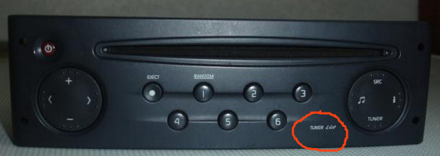

The later clios had an update list radio (its written on the front of it) which is incompatible with the dispaly/stalk from the earlier tuner list radios.
the way to find it see if your stereo has 'Tuner' or 'Update' indicated in photo
If it's Tuner List you'll need an Update List Stereo.
If it's an Update List, you may need to check connections to the centre clock display and stalk.
