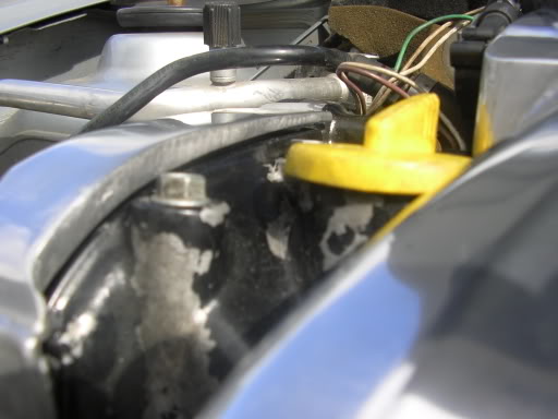

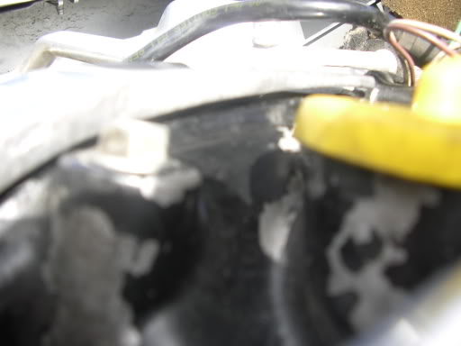

Is there meant to be a gap between the engine mount and the rocker cover as per photos does anyone know??
