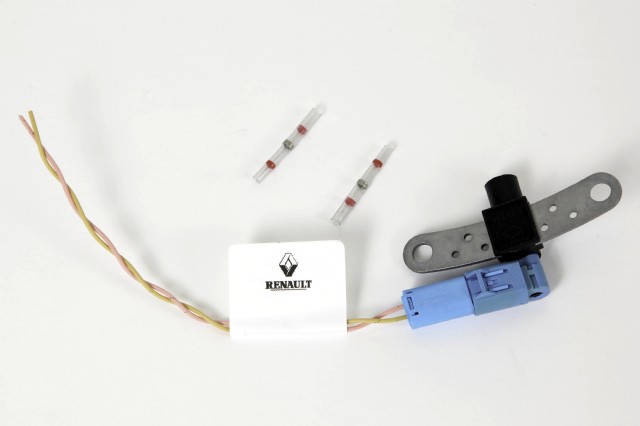

It's probably crank sensor. Check the condition of the connector as well. It could be corroded. If it needs replacing you can get a repair kit from Renault.

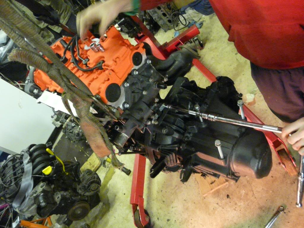

Crank sensor is right on top of the gearbox where it meets the block, a tad out of sight and awkward to get to. If you have a volt meter check for voltage to the coilpack.

Single connector with 2 wires yeah, the loom was a bit iffy and common fault so Renault sold a new connector with loom (The sort KTEC sell)
From memory the loom on these run straight to the ECU, you could run a continuity test from one wire to the ECU pin but it would be a pain in the ass lol

Deffo as advised, change crank sensor and wiring, easy job - ONE job on a 172 that is quite a lot easier than most cars! And it's one sensor that if fails will stop a car in its tracks.

The loom kit thing they give is a ballache to fit due to the wiring, but due to the connectors they supply is easy to do.
