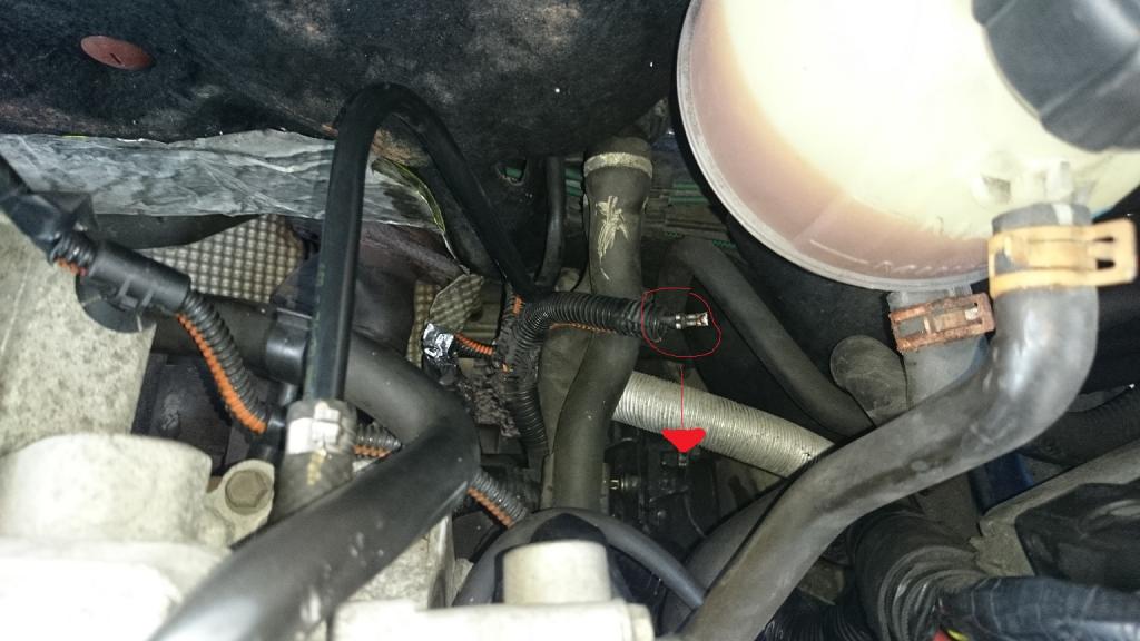

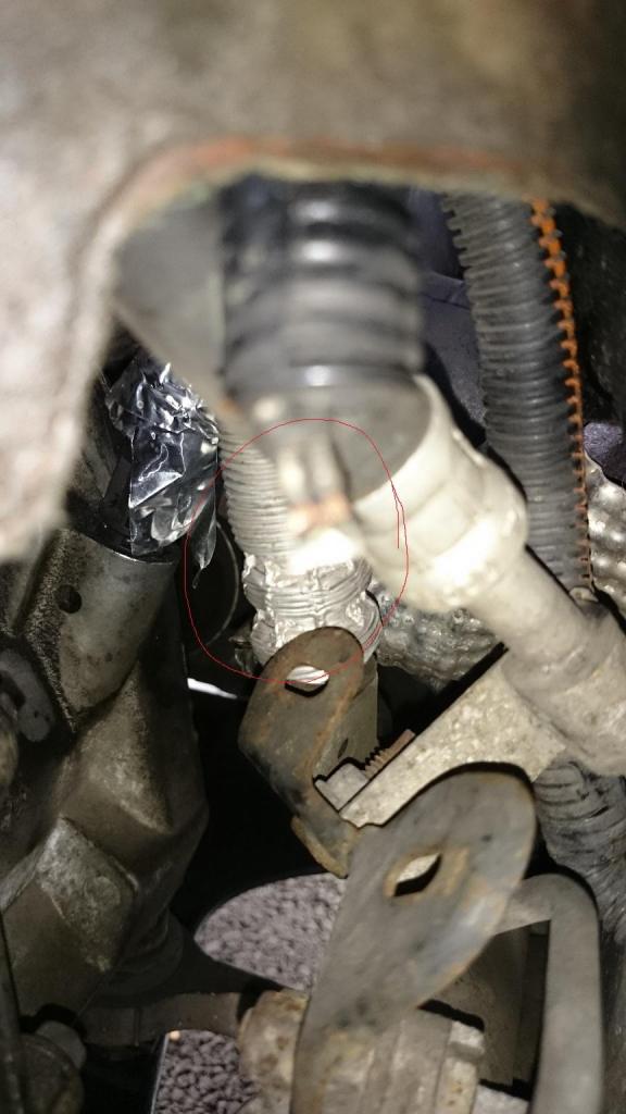

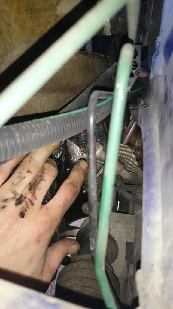

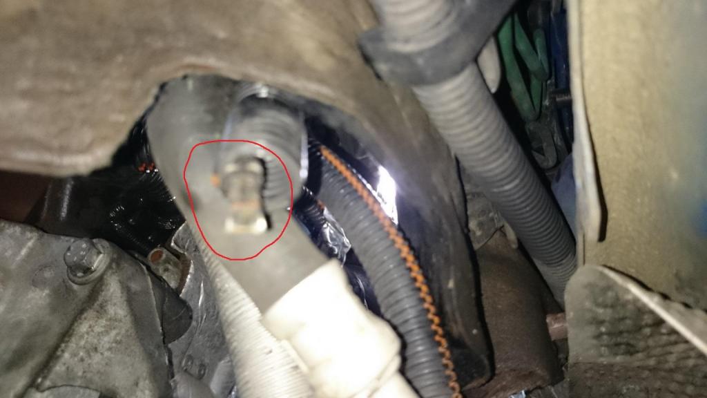

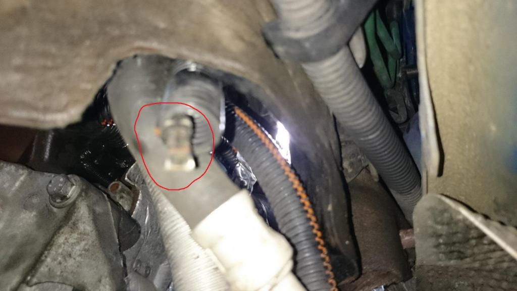

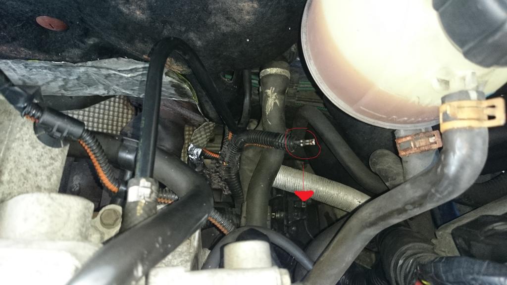

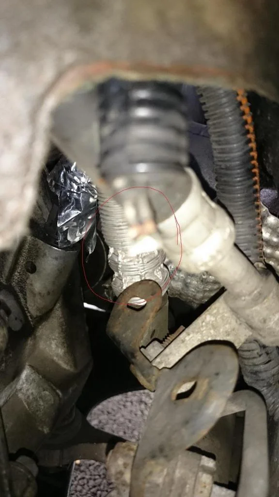

Update, not that anybody cares, but it might help someone if they have a similar problem.
I checked all fuses and relays under the bonnet and everything had a good clean, changed the decoder ring thingy around the key but none of this worked. So i went hunting for a broken earth, checking all earths I could find, two behind the passenger headlight, the strap between the gearbox and the chassis but couldn't find anything wrong until I removed the wheel and arch liner to check the earth coming out the loom and going to the back off the gearbox and hey pressto i found this!
Fixed it back to the gearbox and it started first time :)

Where did it connect to the box?

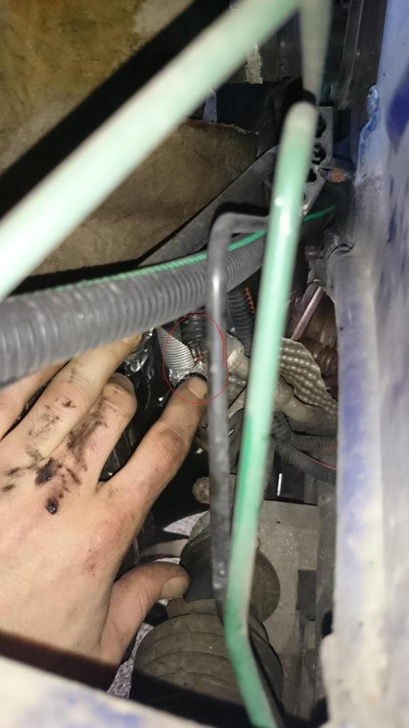

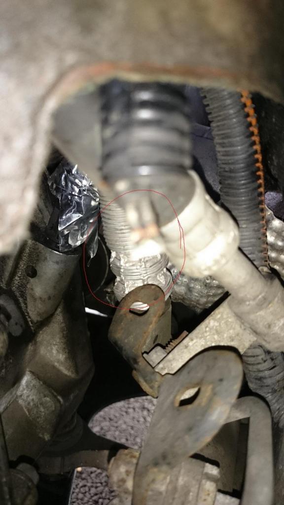

I checked all fuses and relays under the bonnet and everything had a good clean, changed the decoder ring thingy around the key but none of this worked. So i went hunting for a broken earth, checking all earths I could find, two behind the passenger headlight, the strap between the gearbox and the chassis but couldn't find anything wrong until I removed the wheel and arch liner to check the earth coming out the loom and going to the back off the gearbox and hey pressto i found this! View attachment 1188072 View attachment 1188073 View attachment 1188074 View attachment 1188075
Sorry to bring up an old thread but does anybody know where the other end of this earth wire connects to?
Thanks
