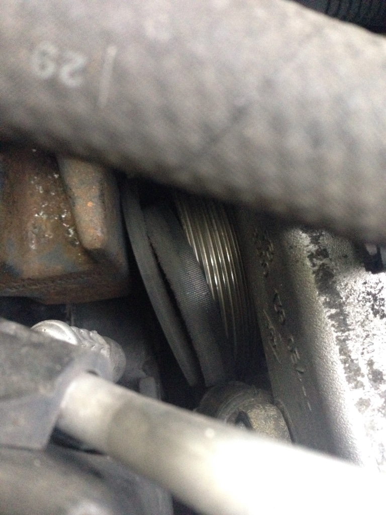

Just had a look, the Cambelt (if that is the belt you an see to the left of the engine cover) has a tear along the middle and has slipped off of the tensioner wheel that it normally sits on. It's not completely off though. Is that a good sign?

There it is :(

That's your aux belt. Not the end of the world mate.
(As long as the part we can't see isn't wrapped around the Cambelt!)
Rent a car for 2 days, get a mobile mechanic to fit a new aux belt kit.

yep thats the aux belt.
not sure how a branch could do that if you cleared it out, thats been properly dragging on something for some time.
you can remove the belt (in its entirety), and then start the car for a short time to see if the knocking is still there. If it is, then its also caused the cambelt to slip and now you have valves hitting your pistons. if not, then chances are you got lucky in the unlucky situation!
the cam belt is to the right of that belt (i.e. behind it if you look from the end of the engine), make sure you done touch that one (its mostly covered with metal/plastics!
Thanks mate. I am mechanically inept though, so I might get someone to have a look at doing that, I'll only make it worse!
