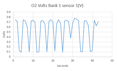

for lambda you really need to graph it and make sure it's switching evenly, no delays, sould give a nice even graph. let me know the figures you get from map sensor. it's very rare for them to fail but i've had three or four over last couple of weeks that have been out on ignition reading and that causes similar issues. had one that was lazy on a focus that was a right headache to work out the fault.
it can be mapped with an iffy lambda but you'll just need to sort it after mapping.

This is the lambda sensor, seems to be switching OK? I presume this is the first pre-cat sensor? It does drop below 0.1 on occasion.
How do i graph the map sensor? Couldn't see it on Torque but wasn't sure what to look for...
