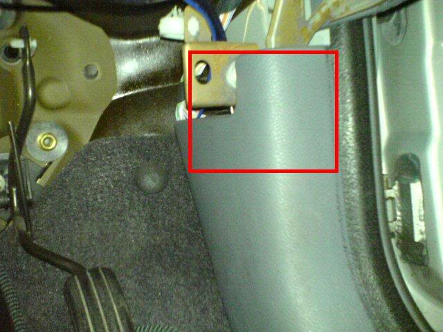

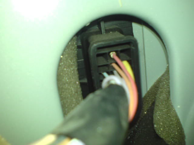

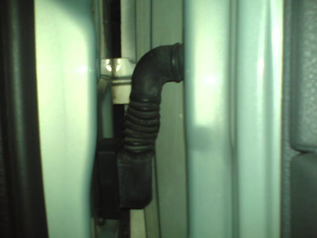

Havin problems with the grommit in the door panel, where the interior wires are lead out into the door, dont know how to take that gromit out to fit new wiring. (understand what im on about? ) Another thin is running the power cable from the amp to the battery, were can i find the hole through the fire wall into the bonnet, or do i have to drill a new one?

if you had done a search you would have found how to put the power cable through the bulkhead into the engine bay.
if you was a club member then you would have seen the 2 guides to put the speaker wire into the doors!:rasp:

You can find it by laying on your back in the passenger foor well and looking up to the corner of the car and youll see it its just 1 cable going through a grommit. follow the cable which comes from the bonnet release lever and this will lead you to it!
the best way to do it is:
pull the power steering fluid resivoir out and move to one side
get some thing sharp and small to make a hole in the grommet from the inside into the engine bay
then poke a screw driver through the car to the engine bay.
then tape the power cable to the screwdriver and pull it back through into the car.
Speaker wire to the doors
pull this multi plug thing apart and then wire the wires straight through it into behind the doors. there is a 2 guides for members
