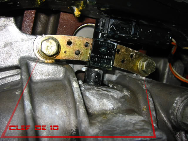

Looks like this
Not my pic

Yes mate easy as, might want to removed the airbox/pipes if you need to. Can miss it, right ontop of the bell housing.
10mm socket on a 1/4" ratchet is ideal, but a 10mm spanner would do the job

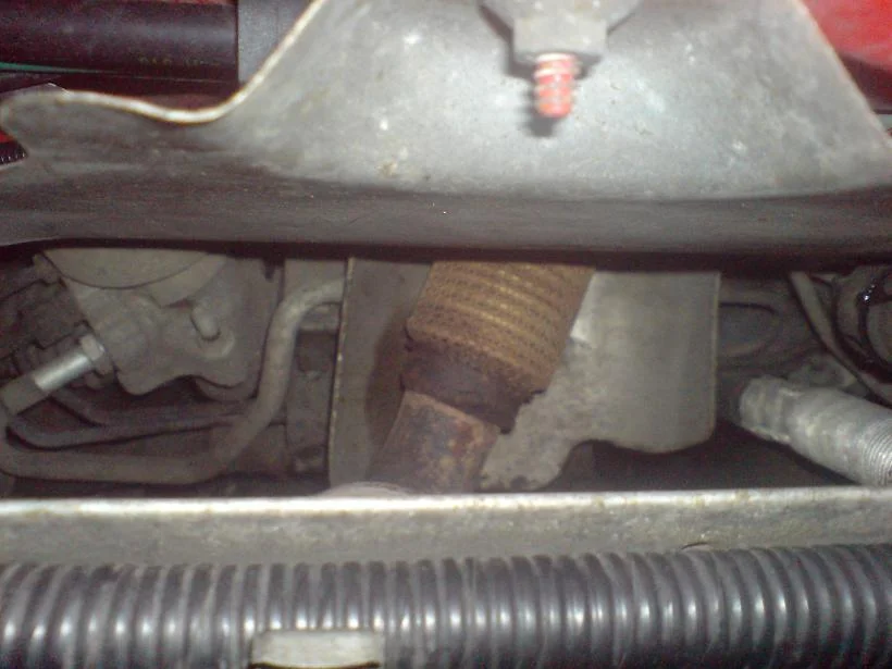

had a look for the sensor just now with no luck all i could see was a filter of some sort.

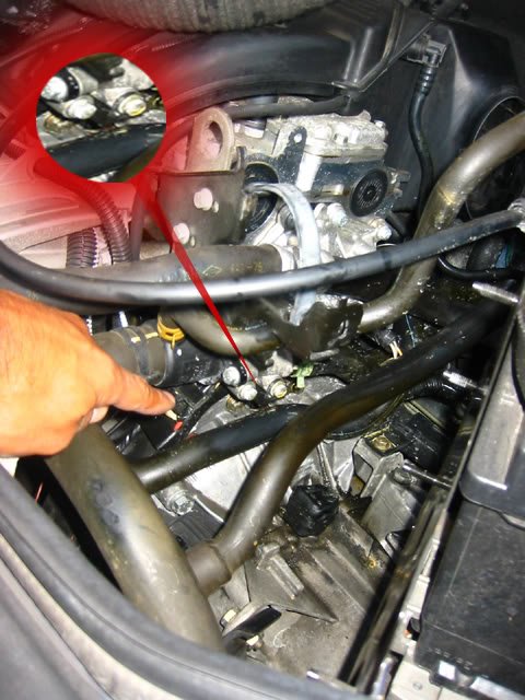

Ok look at the engine, and then to the right slightly, it sits ontop of the gearbox
Again not my pic
got it, checked it, bolts were on tighter than a nun's c*** im thinking of just trading it in for a toyota celica now. its just pissin me off.

Hi guys, I seen this thread and have had a same sort of problem at times. Im looking at this and would like to see if my TDC is the problem, however I had a quick look today and couldnt spot it (at te pics above it looks like its on the left hand side of the engine lump ? ) Here is my bay, could any give me an idea of which area its in, and what I have to move to get access to it on my 172 ?
Many thanks.
