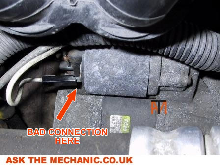

Could be a dirty exciter wire connection on the starter motor. It's only a small spade connector, pull it on and off again and see if it starts then.

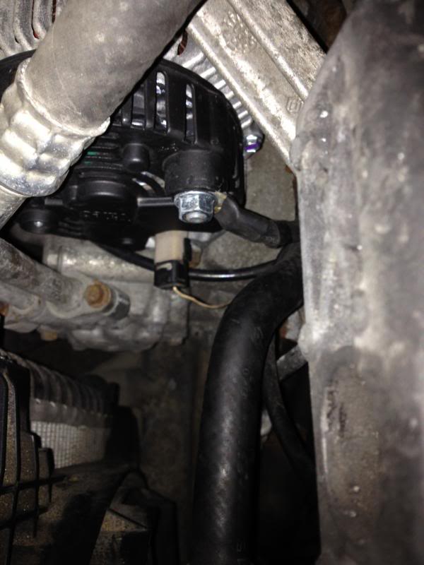

Can anyone put a pic up of where the exciter wire for the starter motor is. can't for the life of me tell where it is. I know its a spade connecter near the exhaust manifold? pic would be really helpful though!

I still can't find the starter motor spade connector on the f4r (172 cup). I'll post a pic up.

roncee, you have to move the heat shield that covers the starter motor, from what I can remember the exciter was on the top of the starter, it's a pain to see it, but you are better off doing this from under the car.
