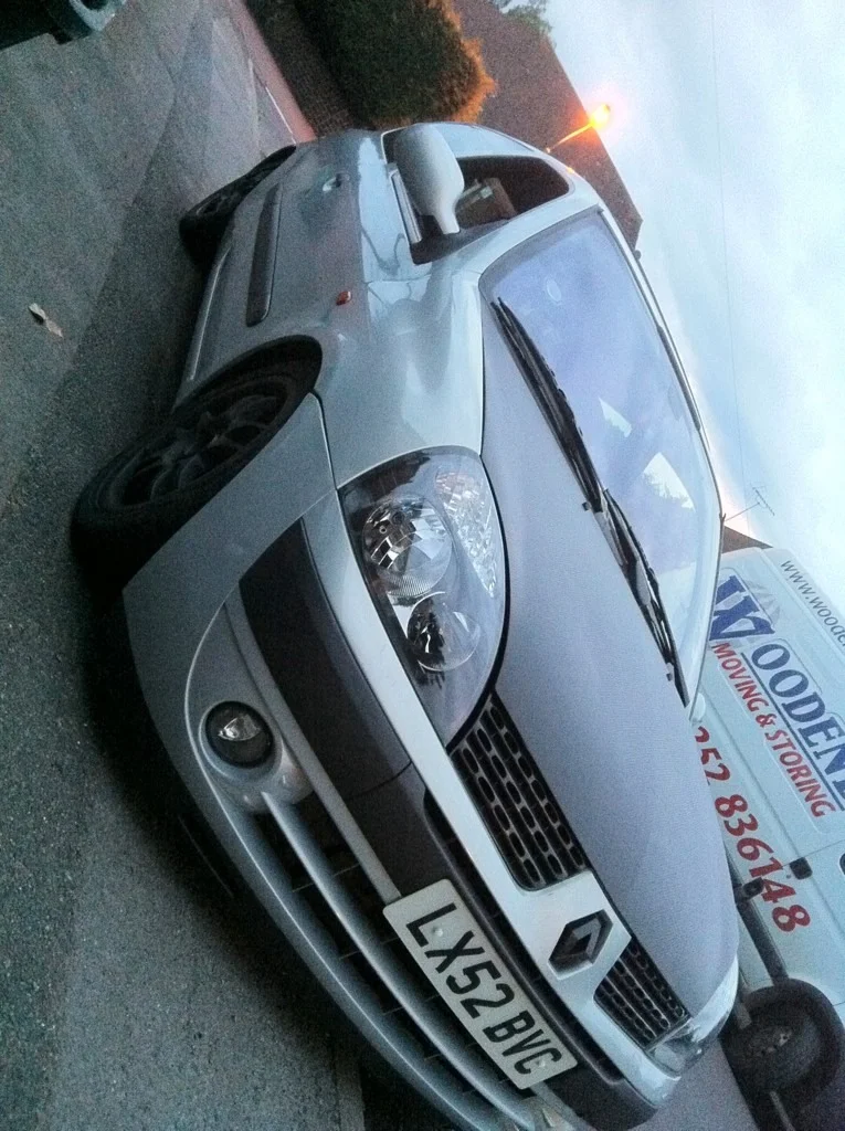

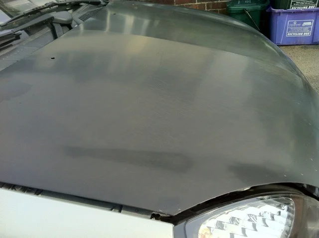

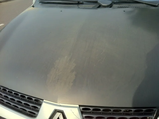

So.. After a few hours of struggling to get it on and all the creases removed, me and my good friend Sam (Ashman1994) have managed to get it on and in mine and his opinion, it's made a massive improvement :) some pics of before .. ( was in a dismal state ) V

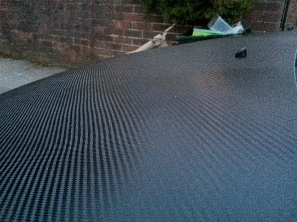

And now some after shots! :)
Pics taken on iPhone so aren't amazing but can see a difference even from them. Tell me what you think!
Ollie :)
