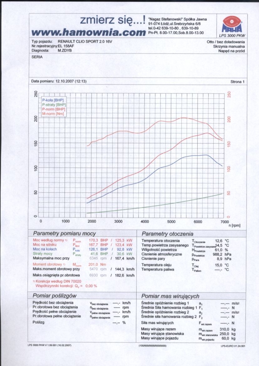

This is my first rr test, car had only decat and air filter
To explain
P-Mot power on flywheel (second RED)
P-koła power on wheels (BLUE)
P-straty power losses (GREEN)
M-Norm torque (RED)
Now with all those things I mention erlier installed, how do You think
power output will change ? Will that 0-5000rpm gap be much weeker than what the car already produce ? What kind of losses are we talking about ? 5% or maybe 30%

i agree that you should do what you want but the guys question was will these cams work with a standard ecu and MOST of the replys was no followed by a cam that would work with this ECU.
theres doing something then theres doing something properly and in order.
you wouldnt put a fully worked head on a 1.2 standard engine likewise you wouldnt put ITB on a stock ecu with stock ECU would you?
cmas give a longer duration then standard.
things that have to be aware of that is mainly ECU or more precise injector duration.
if its not then you WILL run lean AND you do run the risk of blowing the engine up.
Talking to the wrong guy lol.
I started the same thread on polish forum, and the discusion there was also very vivid. Few interesting things was mentioned. I also contacted one of leading chiptuning firms in Poland about remap. I should hear from them tomorrow.
And finally.....
this is what BB Performance wrote me:
"We have seen around 210 bhp on the modifications you have listed. You can map the cams on the standard ECU, as you said the idle is slightly lumpy, but that is that same on any ECU as it is due to the camshafts. If you have any problems with Mapping let us know. Regards Andy. Remember an ECU is simply a computer its the programme that determines the running of the vehicle."
To tell You the truth I got those cams from them on ebay, price was good so I decided, no questions asked. I'm still happy I did that, despite all the different opinions. If all turns out right I'll get what I want, and You'll all get Your answer :)
I hope OMEX will be my last option, since there is so much things yet to be purchased.
You will not get close to 210bhp.
And the points people are making are usually based on second hand information. You car WILL run, it WILL idle and it will be fine to drive. The cams are not so wild that the thing will refuse to run in any half decent capacity at all. You will only encounter some slightly irritating idle traits and occasional stalling when coasting, which is easy enough to counter with the methods i have outlined. The stock ECU will be fine to remap to run those cams, and it will run smoothly, the only thing you will suffer is the lopy idle, and you should still be able to maintain a hot idle of 1000rpm.
However the torque curve is another matter, one that is entirely your own decision to run with.
