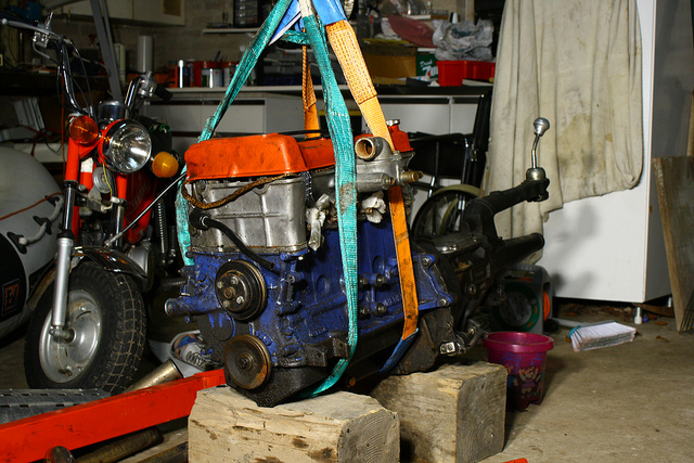

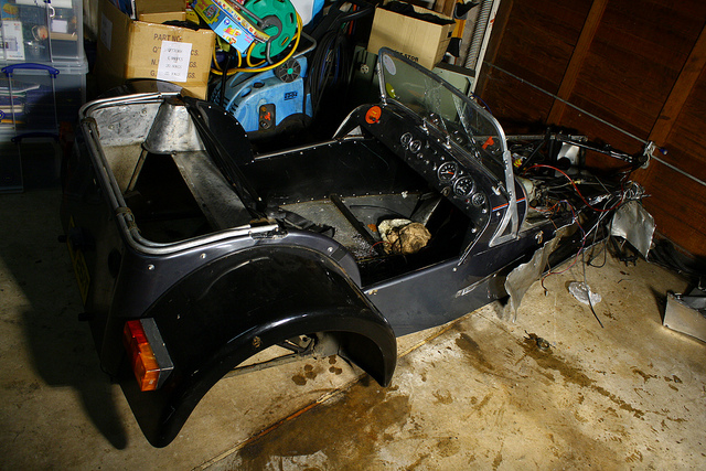

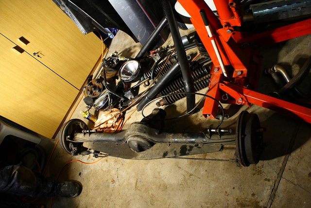

So tonight car was completely stripped and engine out. Next step will be to get a full inspection done on the engine..
Final strip stages by PSJHodgson, on Flickr
Then rebuild the engine it and buy a new chassis!
Iv been told by some1 in the know who has been an viewed the engine in person, that it will be repairable but will have scar wounds (welds) but this all adds character lol!

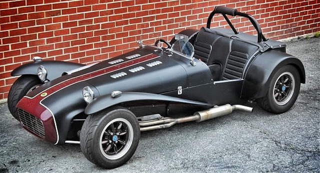

Finally here is another mint 1965 super 7 which was fully restored in California.
Super7 by PSJHodgson, on Flickr

That matt black 7 at the bottom is now in north Wales. I did some work on that in prep for historic racing.
  Italian 3.2 V6
Nice, do tell me more! It's a brilliant example from the photos and FS add I found.. Didn't see how much it fetched though?
  ph1 172
Unfortunately IMO it wasn't a great example in the flesh. Needed quite abit of stuff re-done on it. All of the internal aluminium was re-done, engine was replaced with a cross flow and the original twin cam wasn't as tuned as it stated. We also added to the roll bar to create a small cage and completely re-wired it. New Tillett seat went in too and I re-sprayed the chassis as it wasn't great. I will try and dig out a pic
  Italian 3.2 V6
Shame, looks well in the pictures mind. Do you know how much it sold for by any chance?
Also thanks for sharing :)
  ph1 172
I can't remember the exact figure. Around £26k rings a bell but I could be wrong. Then we did other work which basically consisted of a full rebuild again!
