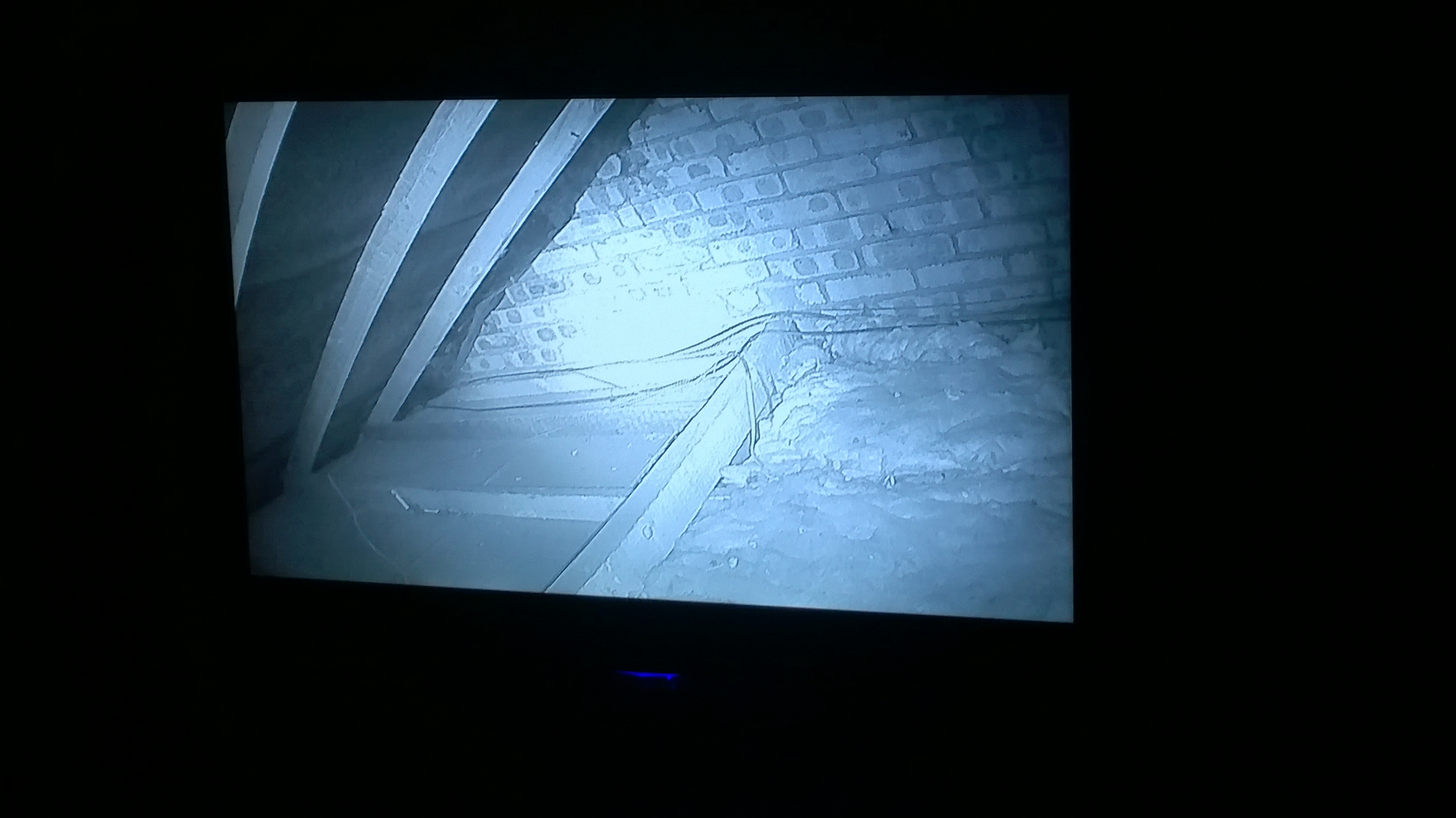

Sorted it @Chrisgti6 :)
LeeRS
I got the one I linked you to first.
They told me they hadn't got one in stock when I got there. After I left and got home, they phoned me to say they had found one.
You were right, it came with an 18m BNC cable so I had to buy a 12v power supply (£7.99) and a BNC to PHONO converter (£3.50)
So for ~£50 I got it rigged up.
I will get a DVR when I put it up outside so I can record but for now it does the job with the live feed.
