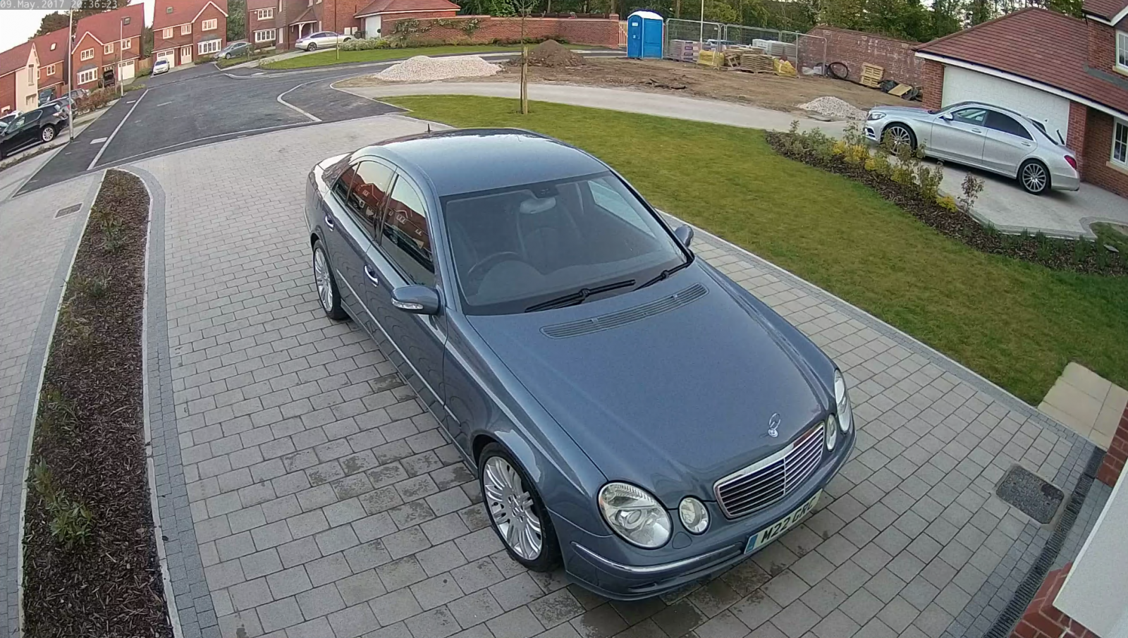

At work we've have a few DS-2CD2332 fitted recently and the image quality is spot on even at night. They connect up to a Qnap NVR but i'd probably be using a low powered PC and a POE switch.
I did have a quick go on the work ones at using the built in recording feature to a shared folder/drive on one of our servers but the file formats came out non standard. Maybe i was doing something wrong but i didn't have time to look further into it. I suppose the downside of using just a PC is the lack of easy connect to a smart phone app but from bits i have read you can still use an application with some port forwarding to each camera (i hope).
GiT
  Shit little Yaris...
Which model do you use?
I'm thinking of the below which seems to give decent reviews.
https://www.amazon.co.uk/dp/B017C4WCES/?tag=cliospnet01-21
4 X DS-2CD2142FWD-IS https://www.amazon.co.uk/dp/B017C4CCI4/?tag=cliospnet01-21
All POE so connected to a POE Hub (X 4 currently). https://www.amazon.co.uk/dp/B017C4CCI4/?tag=cliospnet01-21
Brix J1900 Barebones https://www.amazon.co.uk/dp/B017C4CCI4/?tag=cliospnet01-21
Add 4GB Ram - Small SSD and an external 2TB HHD on USB :)
17 Days continuous 1080i Recording. :D
