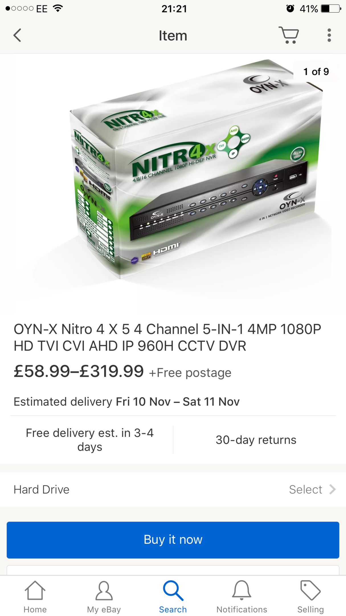

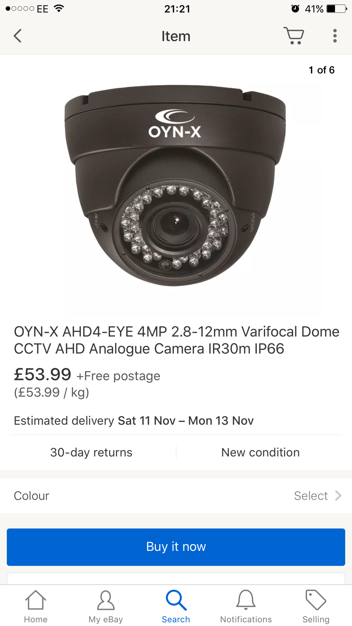

Sorry to hijack this thread, but I've just found these in the house.
If I bought a DVR (eg this one with a wireless adaptor http://www.ebay.co.uk/itm/252714040...49&var=551908838387&ssPageName=STRK:MEBIDX:IT) would it work alright?
