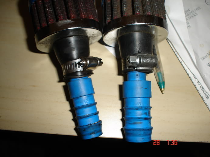

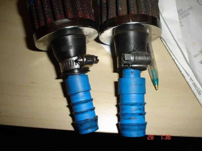

has any one fitted a cda air box to the above was wondering what to do about the idle control as it has no where to go on the air box
u will be left with 2 open pipes 1 is for the iscv and other goes to the block, u will need 2 breather filters 19mm and 16mm to plug in, pic of what they look like. i take it you know that u need an adaptor for the bmc to fit to the tb
