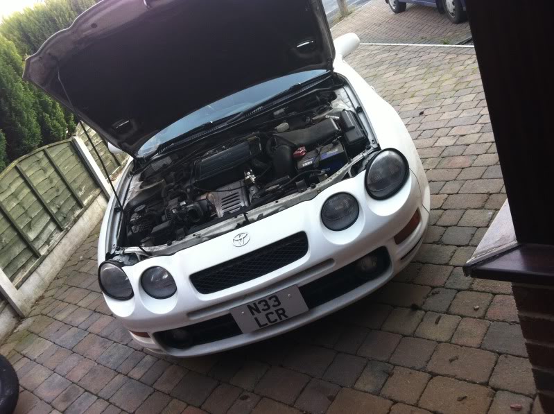

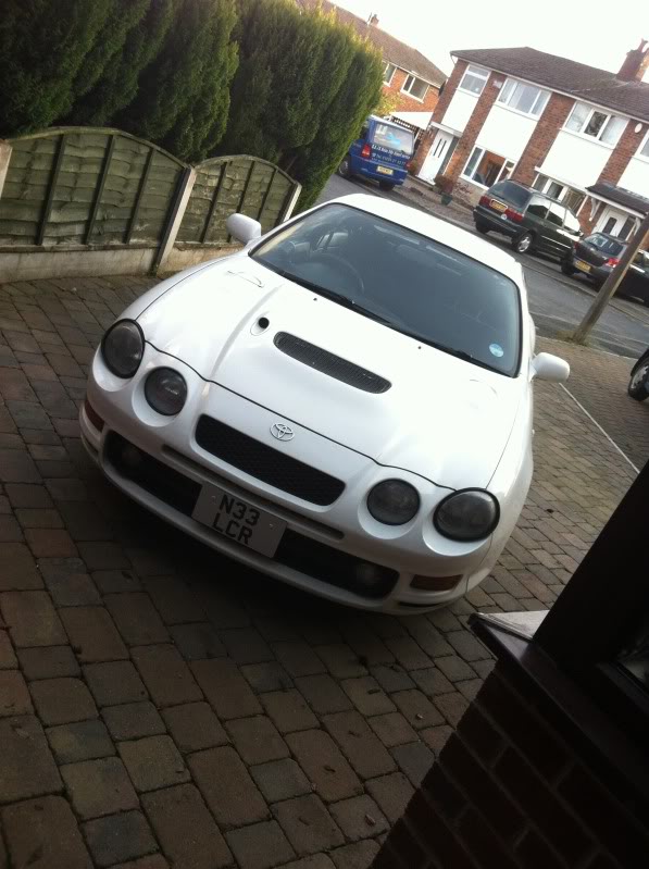

Just a quick pic but I've finally decided to move on from my 172, its been an erm, emotional? 2 years of 172 ownership but with insurance costs getting rediculous I went 'classic' ;)
Its a completely standard GT4 ST205 that I picked up incredibly cheap due to some small niggles that I'm gonna get sorted :)

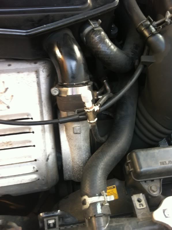

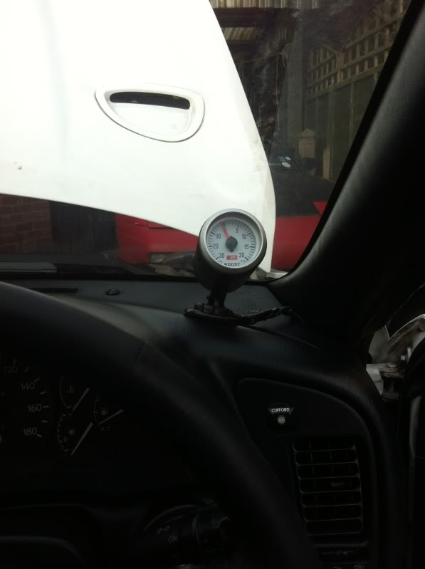

With it being christmas I couldn't afford to do it and so I left it knocking until last week when I had bought a new lower arm, some new ARB bushes and a new o/s CV Joint and inner CV boot as there was some knocking/clicking when turning left from the o/s. I figured while I'm doing this I should invest in some new summer tyres and treat myself to a power upgrade:

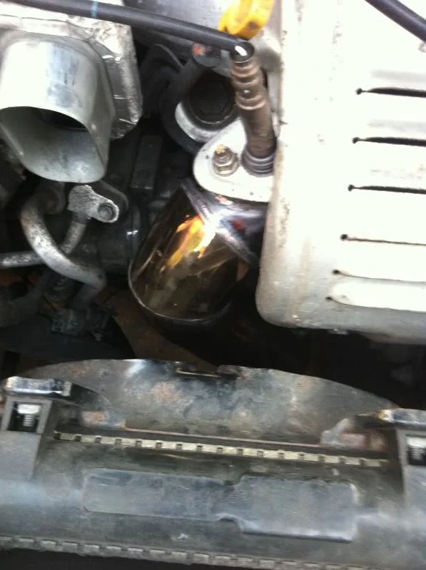

shiny decat:
boost tap :)
boost gauge:
All for a low low price of £85, and according to a specialist (although I'm skeptical) this should be me very close to the 300hp mark :D

Back to the spirited drive, its not all ok. The car has about half a second of hesitation between 4-5k revs now that it didn't have 10 minutes ago, and when stationary theres an awful rattling sound at 4k revs. I've come back home and from what I can see it shouldn't have hit the exhaust although I think that may be the culprit, I hope that is something cheap although I will be annoyed if its the 4 day old decat. Thankfully its booked in at a specialist on tuesday so they can fettle and heat wrap the charge cooler to help it cope with the extra boost. I'll ask them to have a look and make sure I've not killed anything..

After the car cooled down I went out again and though the rattle at 4k is still there the car pulls fine through the revs again :s I think it may he running a bit too hot. This in mind I have a vinyl front number plate coming and will speak to tuning developments about the charge cooler. Hopefully they will be able to come up with something as I don't really want to go down the route of having a FMIC. It might be a good idea to have a look at turnin the boost down a bit as the gauge shows 15psi on full boost which is above the limits of the charge cooler. Ideally it's needs to be 10-11psi. We'll see how it goes with the tap, I may look to an EBC it I can find one at a decent price.
