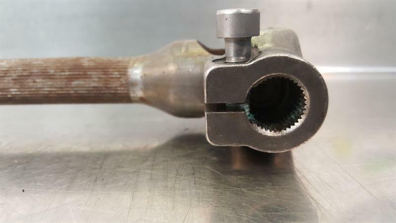

On mine I have epas shaft and also non sport steering rack and I have the end of epas shaft.. like U shaped with a bolt on one side squeezing it on the steering rack pinion shaft.
So to unmate them and fully disconnect one from the other.. you need to undo the bolt, remove it and turn the U shaped part away from the steering rack pinion shaft.
If you only loose the bolt they continue to be engaged.

Sorted buddy i loosened it off from above and rotated 180 and put it back on. Going to adjust the trackrod ends now
