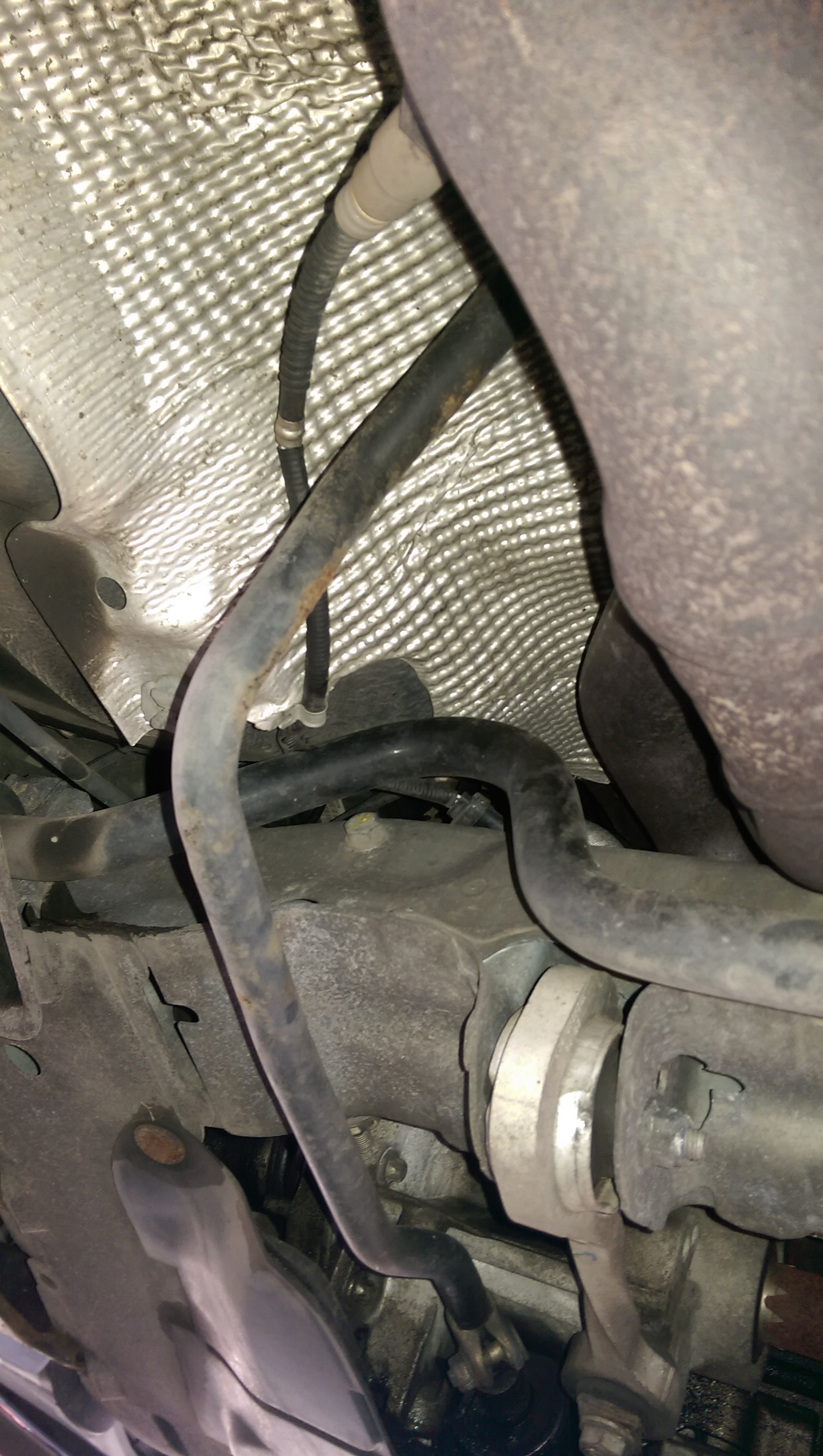

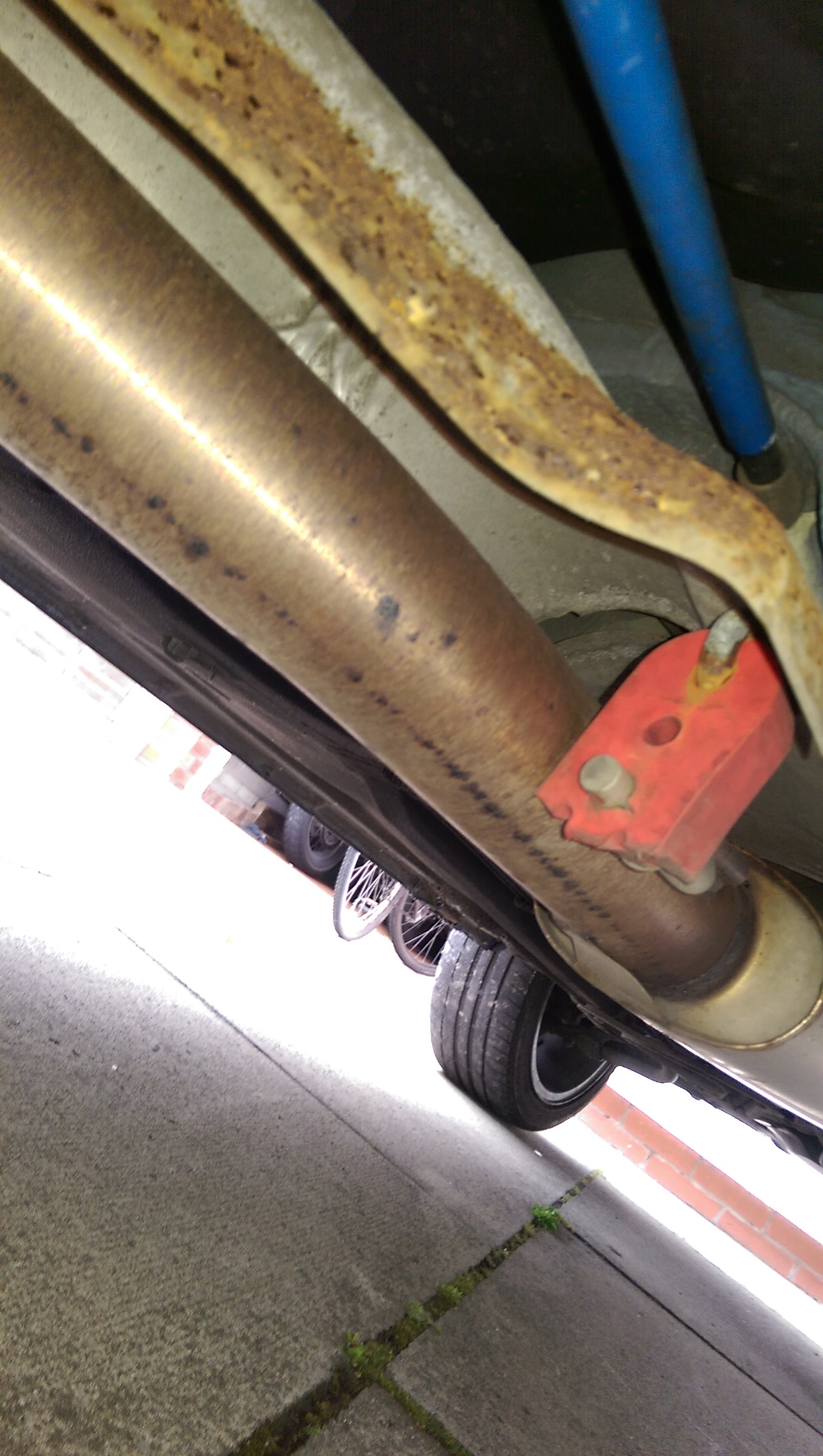

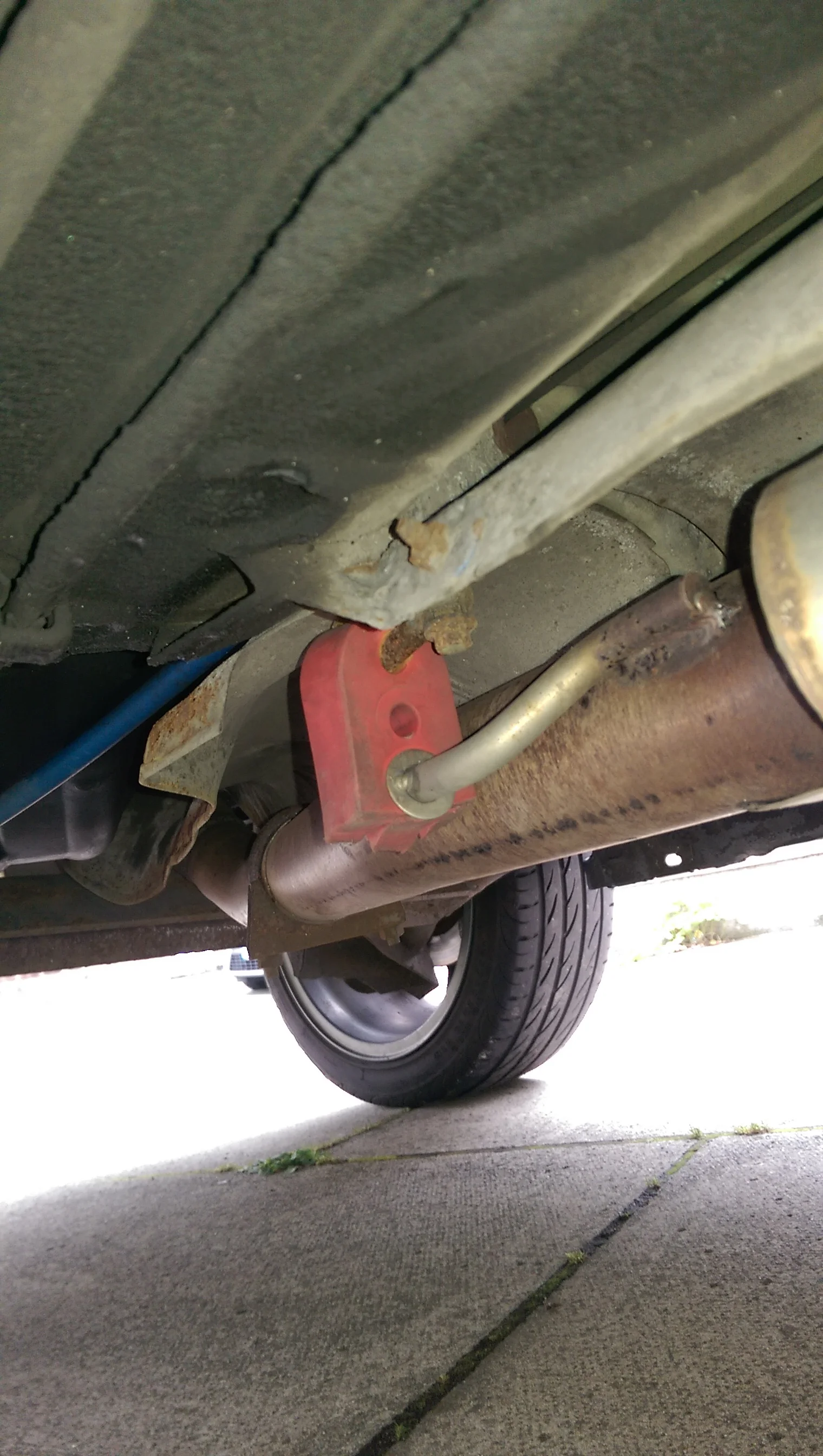

As the thread title reads, I have a knocking sound which sounds like it's coming from the centre of the car. I've had a look underneath and given the exhaust mounts and dogbone mount a good jiggle and they still seem pretty solid. (Centre exhaust mount does have slight cracking - see pics - but it still holds up pretty well)
I did however find what looked like a significant part of the underside of the car which moved a fair amount when I grabbed it and sounded very similar to the knocking I hear when driving.
It's the main black part running parallel to the dogbone mount.
It might be a noob question but the part that seems to move a lot; is it supposed to move so much to cause knocking? Or might it be something not directly visible without removing a few parts?

Black rod looks like gear linkage so it's supposed to move but shouldn't be causing the knocking unless something else is too close to it that shouldn't be.

**Correction**: Had another drive and the sound comes more from rear driver side. Doesn't knock on a smoother road - will have another inspection in that area soon though.
Metallic 'twing' - might be the heat shield knocking on the exhaust? Mine had come loose and used to sound like that when driving with the windows open until I re-secured it.
Had another quick poke around the bottom...
Looks like it might be heat shield after all - found a more loose section right in the place I'm hearing it from so will get it sorted asap.
