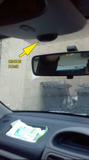

With my '99' Clio hatchback 1.6 Si' that i recently got as a project, the central locking worked now and then (the casing was bust and didnt always connect inside) so i bought a new fob and swapped over the chips. When i press the button now, the light always comes on and makes a good connection BUT the car doesnt respond (lock/unlock).
I have tried every freakin possible fix iv found on the net including each one of these:
Ignition off - disconnect neg. battery lead - ignition on - reconnect neg. battery lead
Take out central locking fuse, press lock button on fob and dashboard once, put fuse back in
Get in car, close doors, hold lock button on dashboard for 5 seconds till car relocks and immob. light stays on, press lock on fob within 10 seconds (various amounts of times)
Put key in ignition, turn to on position then off position around 20 times
Sit in car and press fob and dashboard button several times
Take out central locking sensor from interior light fixture and dry out as moisture can effect sensor from leak in aerial/sunroof
Iv done all this and absolutely nothing works.
I dont get it though, it was working atleast a little bit before and now the connections in the fob are working proper yet the car doesnt respond atall. I read that if the battery is disconnected for so long, the chip can loose its code, but i also read that everything above ^ is supposed to recode the key chip if that happens.
I believe that over having to take the key to Renault for them to recode the key or the car for a ton of money, because i work with IR tech at uni and its not that hard for one sensor to acquaint with the other, both just have to be engaged one way or another.
Iv listed all these methods incase anyone else has this problem and needs to try something because alot of cases have been fixed supposedly by carrying one of these methods out.
