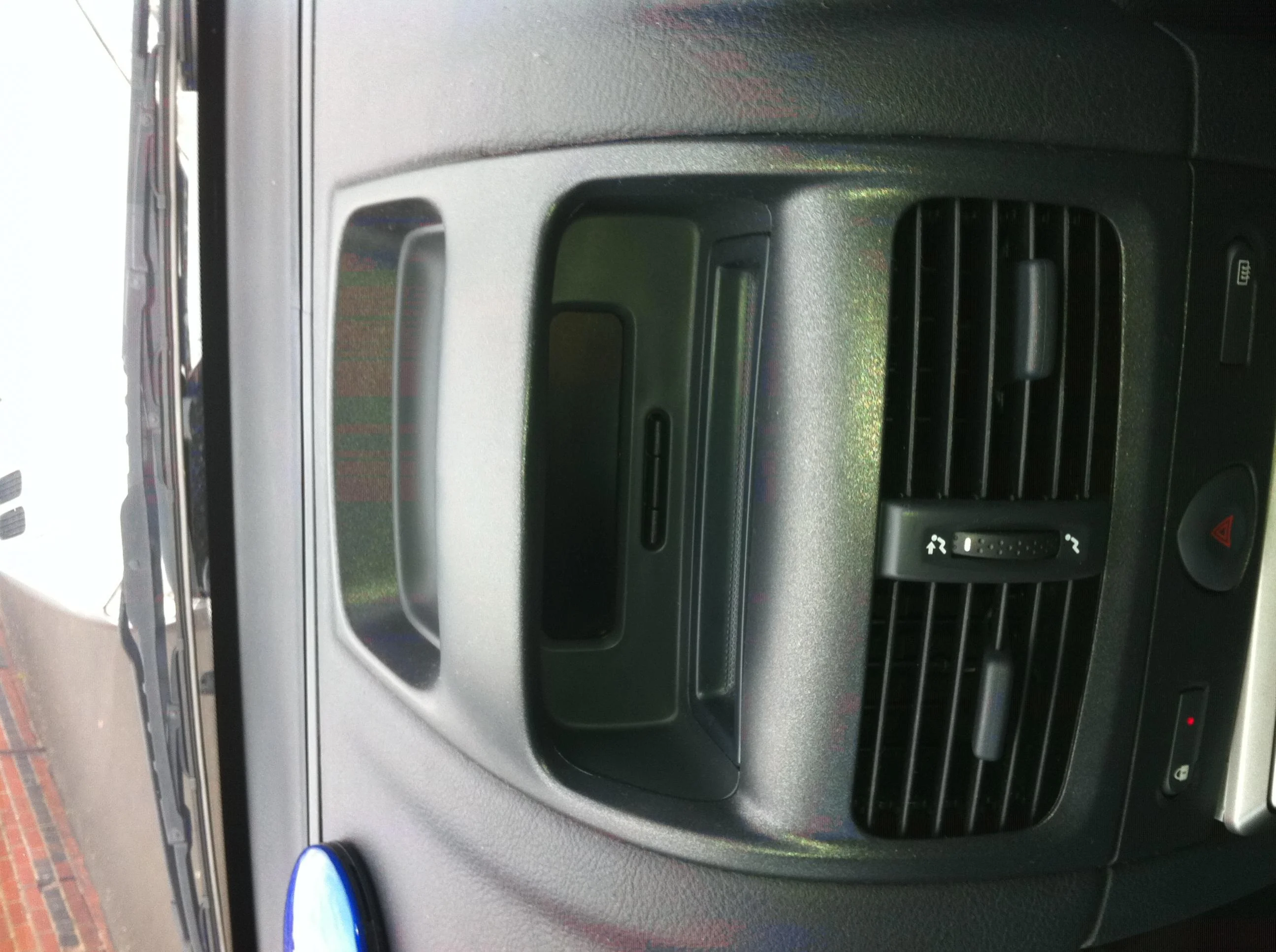

Hi Can someone please advise how to remove the centre dashboard trim (AS PICTURED).

its all part of the top half of dash. remove screws at window air vent, under stearing wheel and on side of dash (where fuse box is) think there could be a couple above glove box door too!
need to take the trim off the front pillars too so dash can be removed
Mine looks like it's been plastic welded from the factory? I'd like to remove it so I can clean it up away from the dash but doesn't look like Renault wanted you to separate the two
You can get it out but they are plastic welded in so you need to break/drill that off. I then used some big washers with small self tappers to put it back in which worked well
