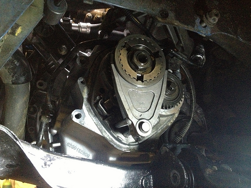

New gears by Jon_KTM, on Flickr
That's what you'll see when you take the end casing off. You need to drop the gearbox slightly as you can't get the end casing off past the chassis leg.
You need a couple of decent pry bars and a decent drift to get a roll pin out.
TBH once you get the end casing off and see it in front of you, you should be able to work it out. Just set yourself a day to do it but I'm a mechanic by trade and had a ramp to hand including all the tools so only took about 2 hours :)
