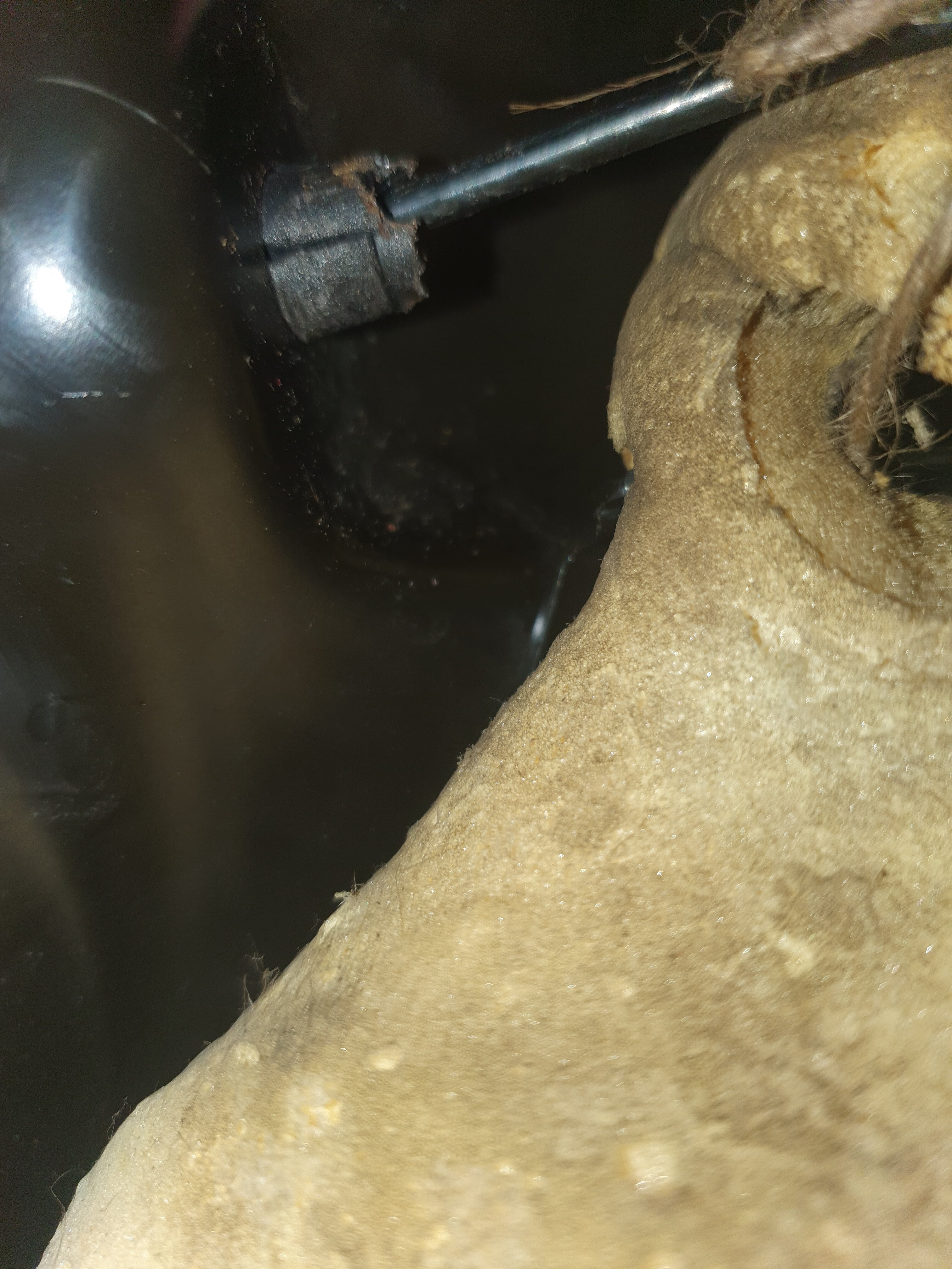

Is this the jobby as I can't get this through the bulkhead. Snapped 2 bits off the top. Which doesn't matter but struggling.
Tried a flame torch and yes scary woth all the stuff under there. Got a cup of water on hand.

Also spent over an hour on just this bit. Total time so far tonight is 3 hours!
1 hour removing battery tray to refit after realising nowhere says the tray, although i had in my mind some reason as easier access to cable routing.
Currently stuck with a cable almost out but not quite. And can't even attempt the new one yet!
I will have so much satisfaction after doing this. But I am getting a little wound up. Plus seeing places where I'd believe bolts or nuts to affix things would be
