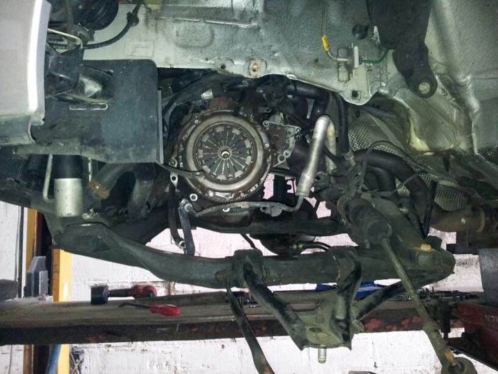

Hi, I'm tasked with changing the gearbox in my Clio tomorrow.
Can anyone provide any pointers, or their experience of doing it?
I've heard conflicting stories regarding the removal - one claiming the whole subframe needs to be dropped to do it, another claiming you can drop it on one side and squeeze it out.
Any help would be much appreciated.
  Clio 172 Ph1.
On my ph1 172 i just lowered the subframe. But i guess it would mean a lot less hassle if you remove it completely.

Remove the subframe it makes it so much easier...
No special tools required, just common sense ;)
  182 Trophy
When removing the subframe, how did you support the engine? I'm guessing an engine brace is a no go with plastic wings?
  Lionel Richie
erm the engine mounts support the engine ;)
what you mean is once the subframe is removed, how do you support the engine as you remove the gearbox
easy, trolley jack under the sump

I won't be working on the floor, so I'm not sure how much use a trolley jack will be :/
I'm working in someone else's workshop tomorrow too, so I'm not too sure there is a working gearbox jack.
  182 Trophy
All done - the wing crane did the trick in the end - we just used the metal tabs as supports.
So much mess for a gearbox though :/
  Lionel Richie
i would've removed the subframe, complete t**t getting the box back in with it in the way, plus you can damage the column doing it the way you are
  182 Trophy
Dropping the whole subframe was considered, but it looked like there was plenty of space this way.
I found the box went back in quite easily to be fair - but we were incredibly lucky throughout and everything went smoothly apart from one of the rear subframe nuts spinning.
The rack was unbolted from the subframe.
