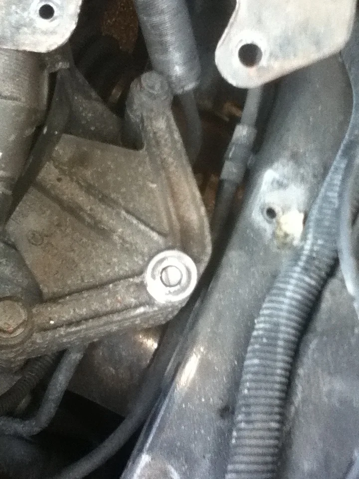

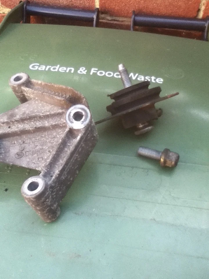

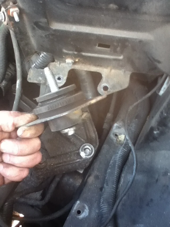

HELP! The main bolt that goes through the rubber has sheared off! What can i do?!
ImageUploadedByTapatalk1347701956.736761.jpgImageUploadedByTapatalk1347701977.406387.jpg

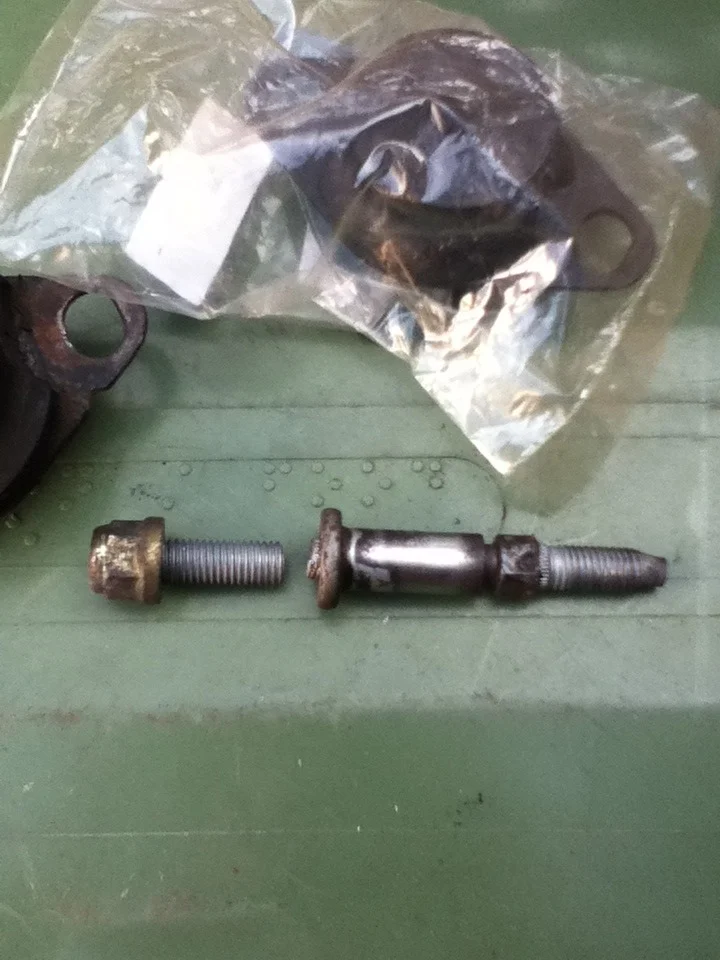

Paddy_g46
Ok, im removed the gearbox bracket thing that the bolt goes through and luckily have it out but now i need a new bolt and this thing looks pretty meaty, doubt ill find 1 to match it anywhere!

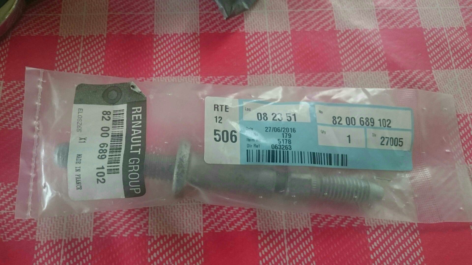

Got it out. Right so do i meed to replace this entire "assembley" or is this bolt more than 1 part? ImageUploadedByTapatalk1347703790.616984.jpg.
Also, i dont suppose anyone could please dig me up a part number?
Paddy_g46
if anyone can help me out with a bolt this weekend then PLEASE get in contact! I would be eternally grateful!
Paddy_g46

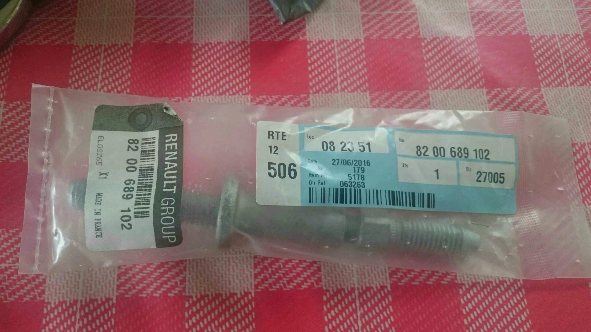

Forum members FTW! Someone came to my rescue this afternoon so the car is back on the road and driving a lot tighter than it ever was before!
  Many.
Pay membership and talk to Adam at renault Wolverhampton, or speak to your local renault dealer, they'll be able to find it easily.
David172
  Clio 172 M135i

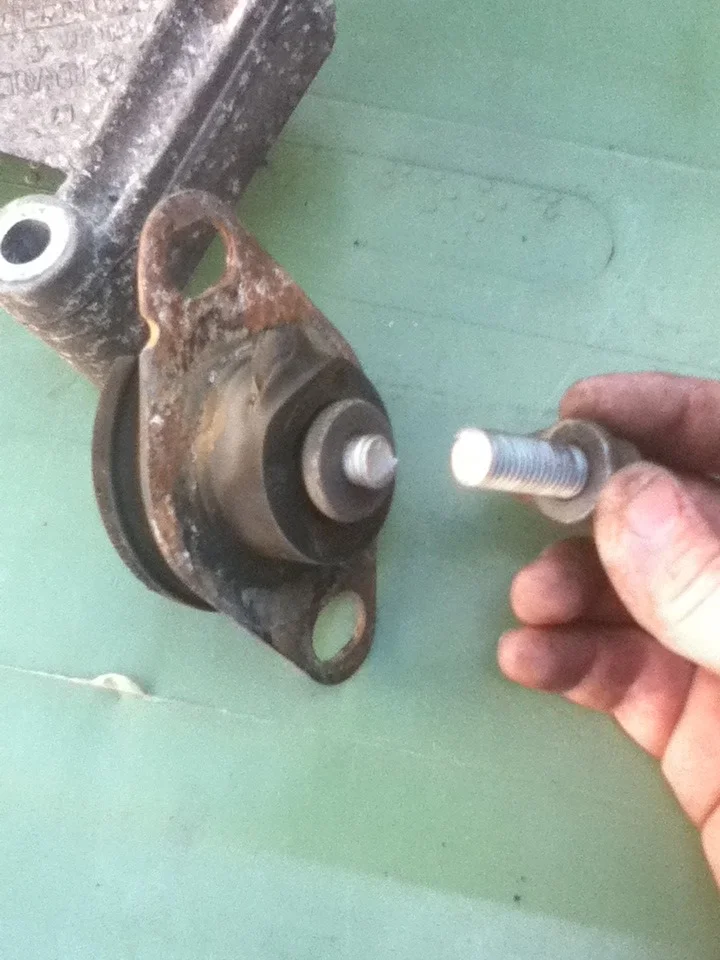

kinda pressed in, it has splines so when you tigthen it up is "cuts" into the mount

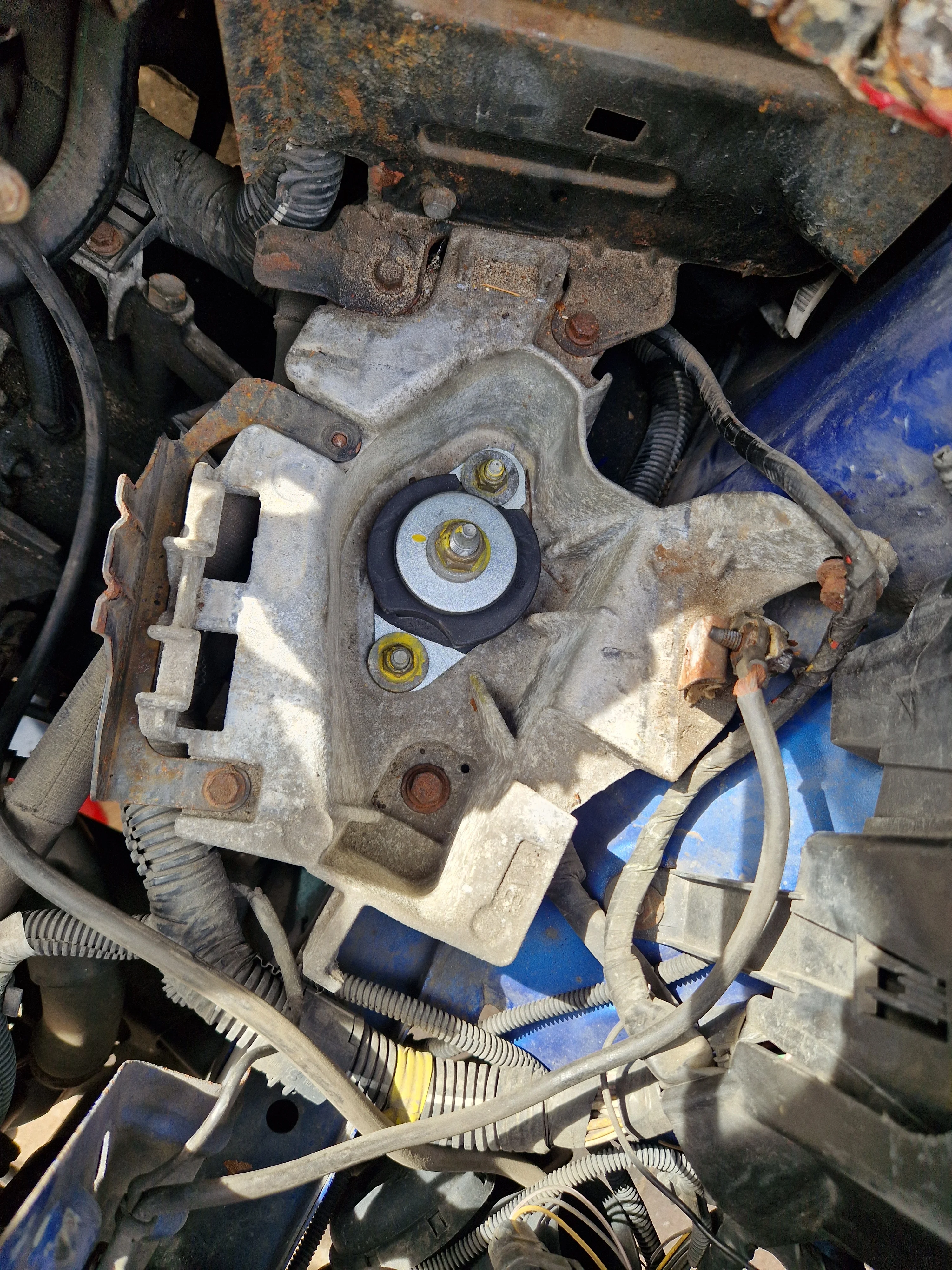

Epic thread revival but does anyone have any tips on how to seperate these two parts before I go at it? I really don't want to damage the big bolt. Thanks!

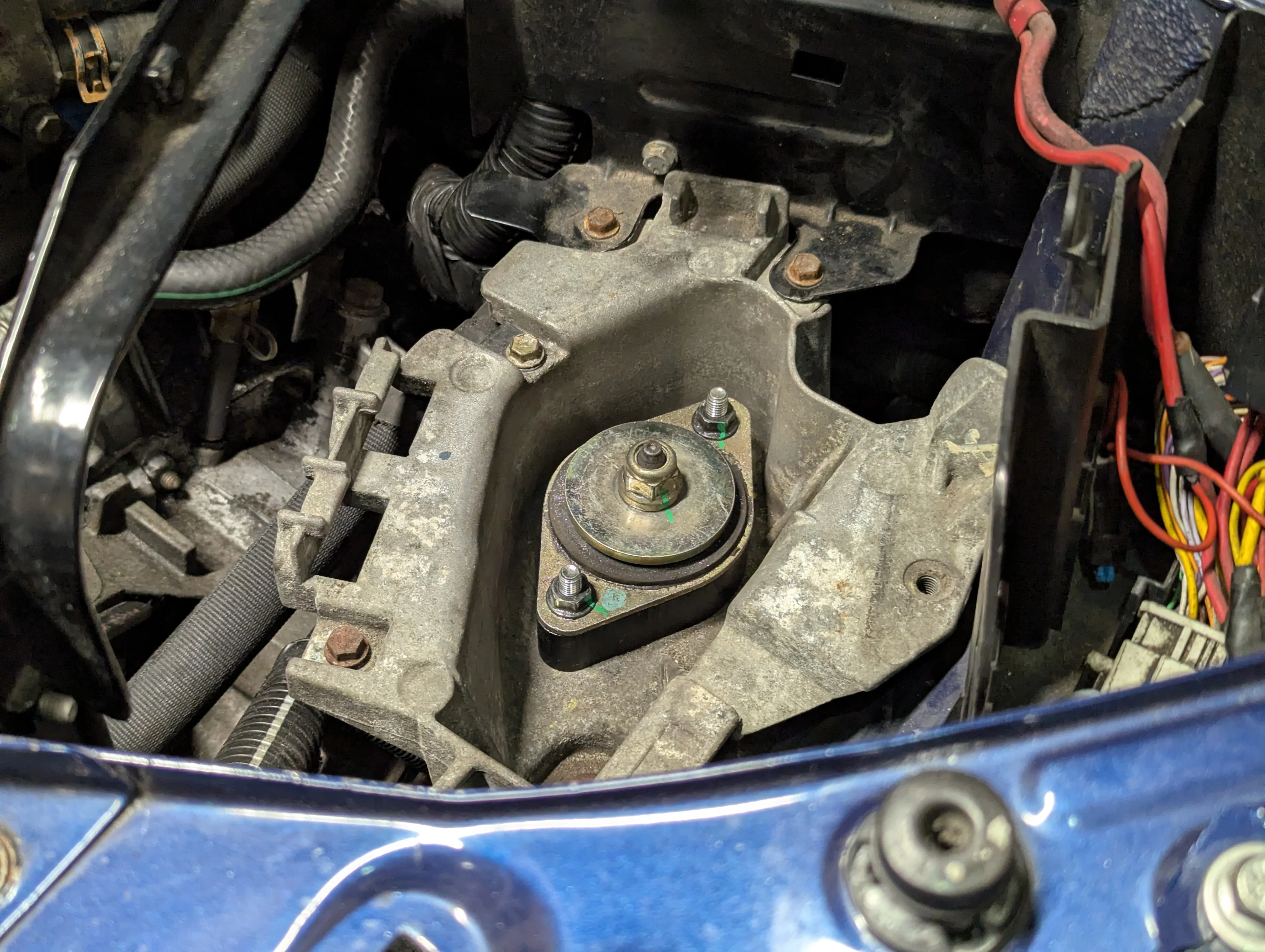

Changed my gearbox mount recently and had issues getting the mount off the big bolt. I left the actually cast mount that connects the box to the chassis in place and just changed the rubber mount in-situ. Was a bit fiddly but definitely achievable.
- using a trolly Jack, Jack the box just enough to support it and take the pressure off the mount.
- take the 3 x nuts off the rubber mount itself (2 that hold it to the cast mount and the one that bolts to the central gearbox bolt)
- using a pair of waterpump pliers, grip the rubber mount at the 9 & 3 positions and give it a good wiggle and pull upwards and it should pop off. You’re trying to break the stiction/any corrosion between the hole of the mount and the splined part of the central gearbox bolt.
hope this help.

I ended up removing the whole spider assembly. As I then had the mount out I just put it in a vice and went to town with a hacksaw and stanley knife. When I could get a grip on the metal part it was easy to loosen off the splines. Had a nightmare getting everything to line up when putting it back together though haha.
Now I know how it all goes together and how the mount is made I would probably do it differently next time!
