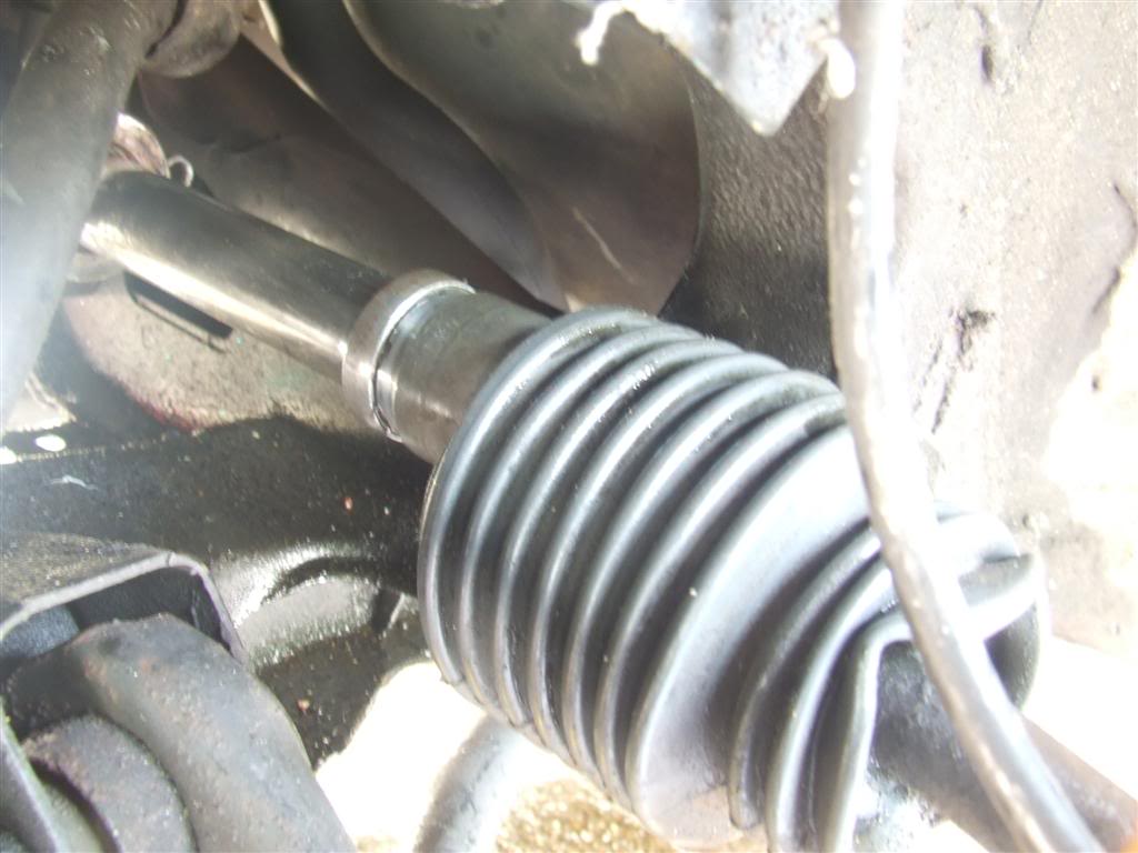

Im trying to change the NS track rod as mines bent (not the track rod end)
but.. how the hell do you unscrew it from the rack? theres no notches or anything on it?

looking at it from that angle, it unscrews counterclockwise yeh?
I can get it to turn a few degrees back and forth quite easily - but refuses to go any more
also, there appears to be some sort of ring on the inner end that can rotate freely (with mole grips) but doesnt unscrew or unclip etc... is that right?

unscrew it, it has a retaining ring that is one way, with the new track rod you should get a new one so dont worry about breaking the old one.

I've tried 'unscrewing' it both ways
doesnt unscrew, only rotates :|

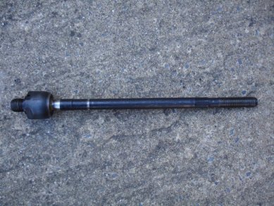

Matteh as Mike said you need to unscrew it where it joins the rack, if its spinning your more than likely turning the wrong part - the control arm itself. If you imagine the arm has a ball on the end, you need to undo the 'socket' bit. I imagine on a valver it's gonna have been on 10+ years so it'll be well tight.
Far left bit you want to turn, the arm will just spin.
http://www.fordprobestore.co.uk/store/images/trackrod1.jpg
