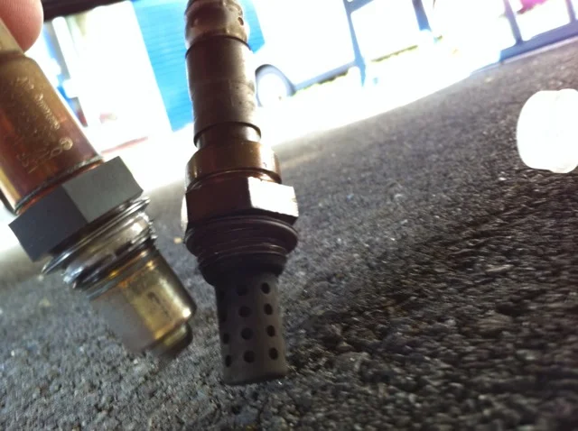

Erm, the bosch replacement from northwest performance is meant to look different right?

  2004 182FF
Guess it must be right. Silky smooth idle, running perfectly.

If the new one is the one on the left, then it looks like your old one was a cheap replacement for the original
