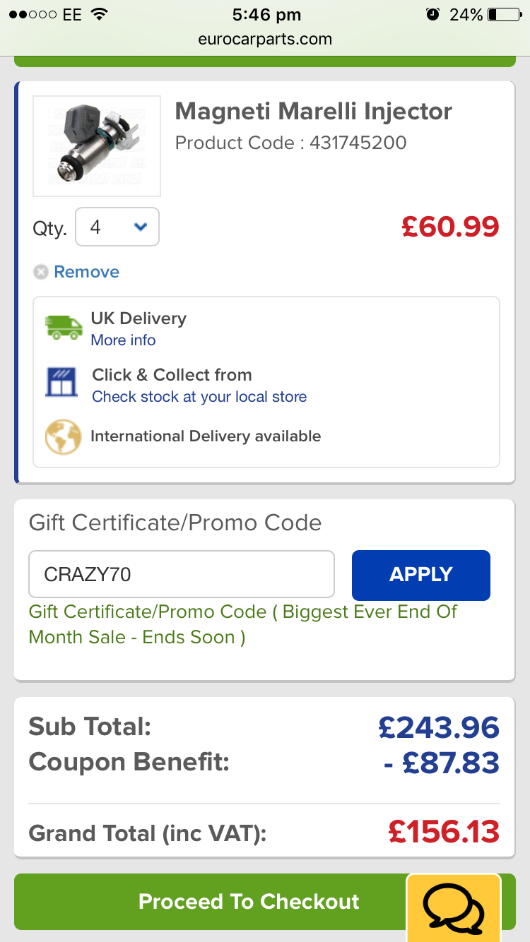

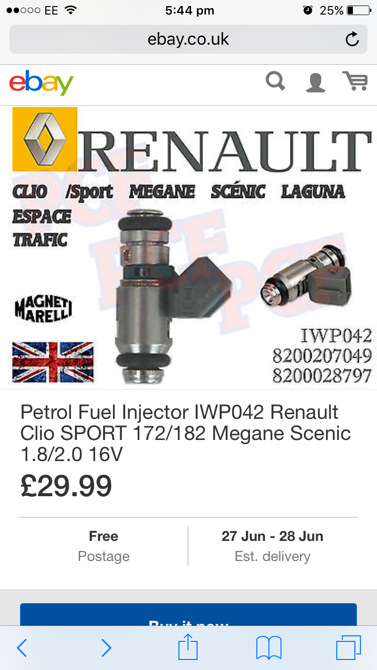

Had a look on ECP and they are £156 with a massive dicount they have on at the moment. Had a look on ebay and genuine renault ones are £29.99 each. Whats the differance? Supposibly they are the same brand

should be the same but i've read that if they don't come with clips they aren't genuine, how true that is i don't know? could just be internet crap!! generally the fakes i've seen don't have the logo etc on the socket.

Buy the ecp ones
Lot of so called genuine on ebay have been fakes
Few threads last year on about fakes
