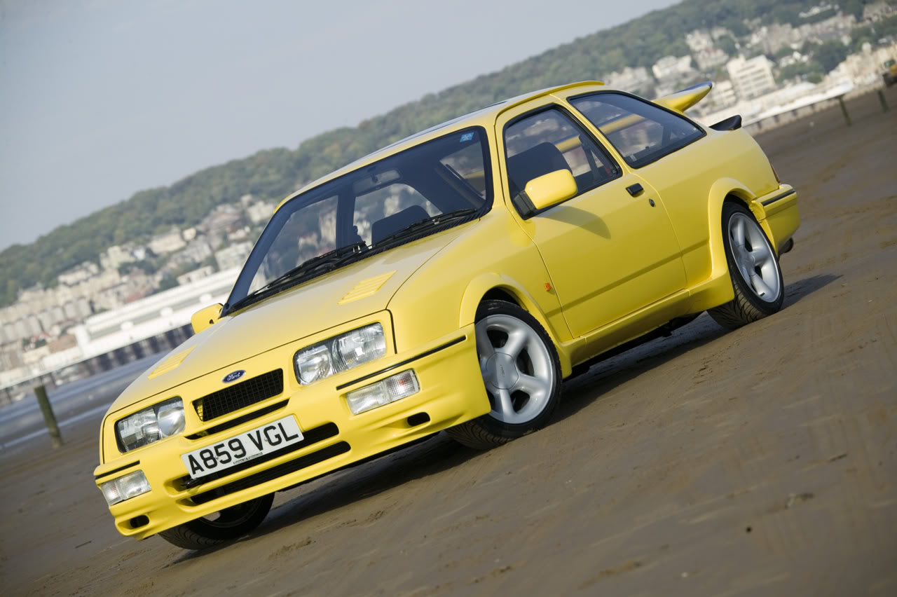

Chips old Sierra??
  53 Clio's & counting
I'm sure chip will be along to verify, I remember it's feature in max power dohnutting on Weston beach lol
His was an A reg (I just googled yellow Sierra)
  A4 DTM/iceberg cup
I was pretty sure that he said his wasn't originally a cossie shell too. I could be very wrong though. Still a good looking car.
  182/RS2/ Turbo/Mk1
Max power?
I think not!
Was cover car for fast ford in December 2005 though, which is probably where you saw it?
And it was more just huge amounts of sideways action than donuts in the pics, although there were a few of those too, lol.

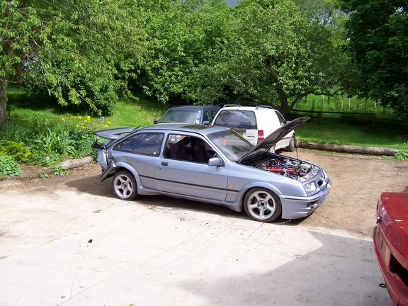

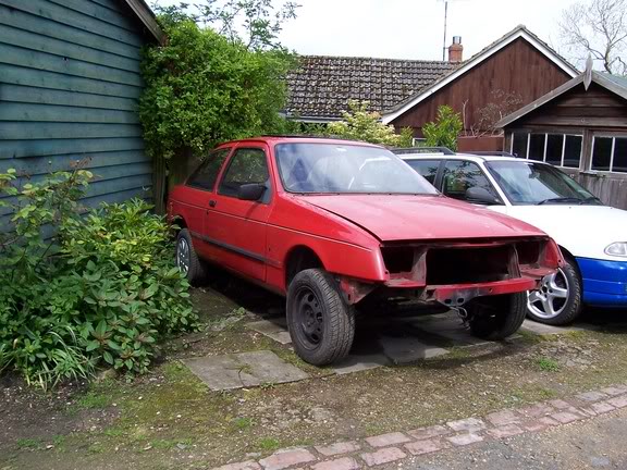

It wasn't, it started out as a red base spec car (I read it the other day)

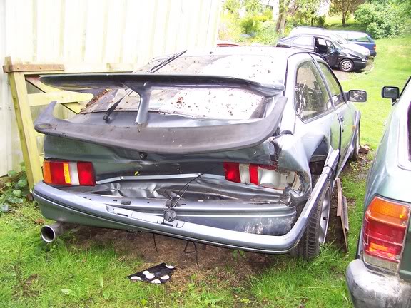

Yeah, I had an RS500, my mate crashed it, and we found a completely mint base model shell that had been in dry storage since the 80s and used that to rebuild it.
The shells arent actually any different by the way, its only a logbook difference, like a trophy shell compared to a 182 shell.

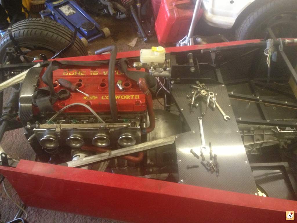

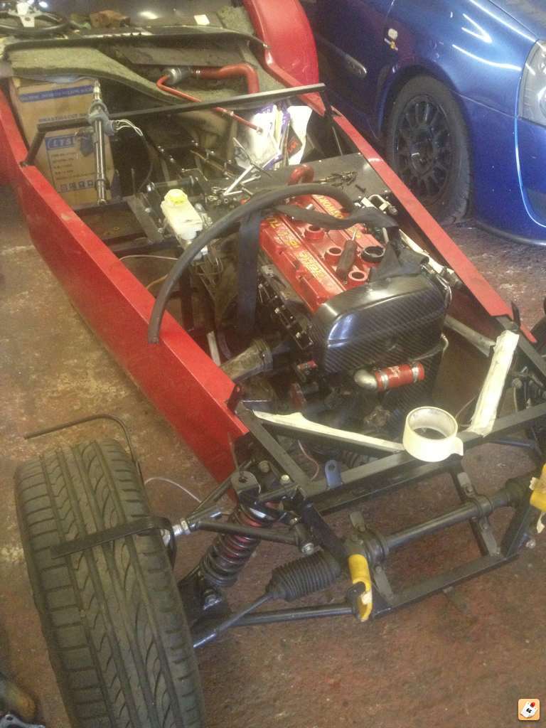

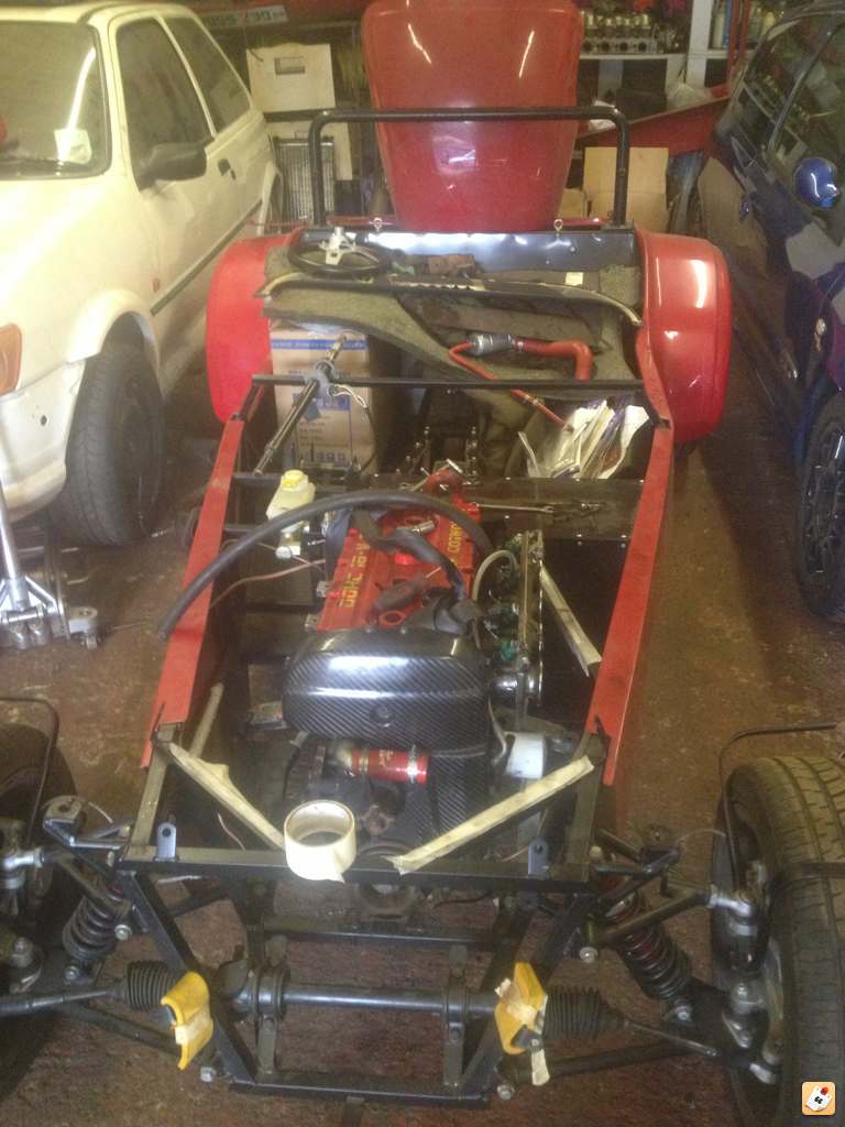

Long overdue but here we go!
Got round to Chips at the weekend and removed the heart from his Serria and I think a little of his own heart too.
I wasted no time getting to work.
The engine and box are a tight fit but it looks quite easy to modify the chassis to get it perfect. It literally needs a small notch to clear the starter motor mounting on the bell housing and a slight mod to allow the inlet to fit. Looks less than an hours work. :)
Only issue I've found so far that's going to take a bit of technical thinking is the steering bar runs right through the alternator so I need to run a different one, possibly on the other side of the engine.
Also the 2wd exhaust manifold is far too big to fit in so I need to source a 4wd one as the are much more compact and still capable of flowing 400bhp.

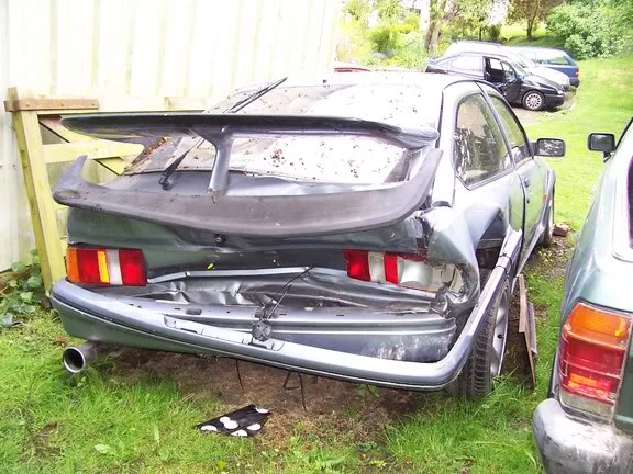

I bet you were gutted when that happened to it? I'd have cried.
How comes you broke the yellow car up?

TBH I was far more bothered about my mate going to hospital than my car getting towed away!
No longer had a use for it and Mike wanted the engine and box so it seemed to make sense.
Fair play Chip. Sorry to hear about your mates accident, it must have been bad (I'll shut up now!)
  182/RS2/ Turbo/Mk1
TBH if he hadnt have been hurt at all I would have probably hospitalised him anyway as if he was fine I then would have been worried about the car and hence angry, LOL
We're still great mates today, I guess stuff like this is a good test of friendship, as soon as he was conscious though he was offering me different options for paying me back, such as him breaking it and making up an short fall in value etc, in the end we settled on him finding a new shell and rebuilding it for me, although I ended up doing some of the engine stuff and just let him have all the crap jobs like all the loom and sound deadening etc, lol. And then things like the paint and the new bits I paid for all of as that was stuff I wanted different anyway.
