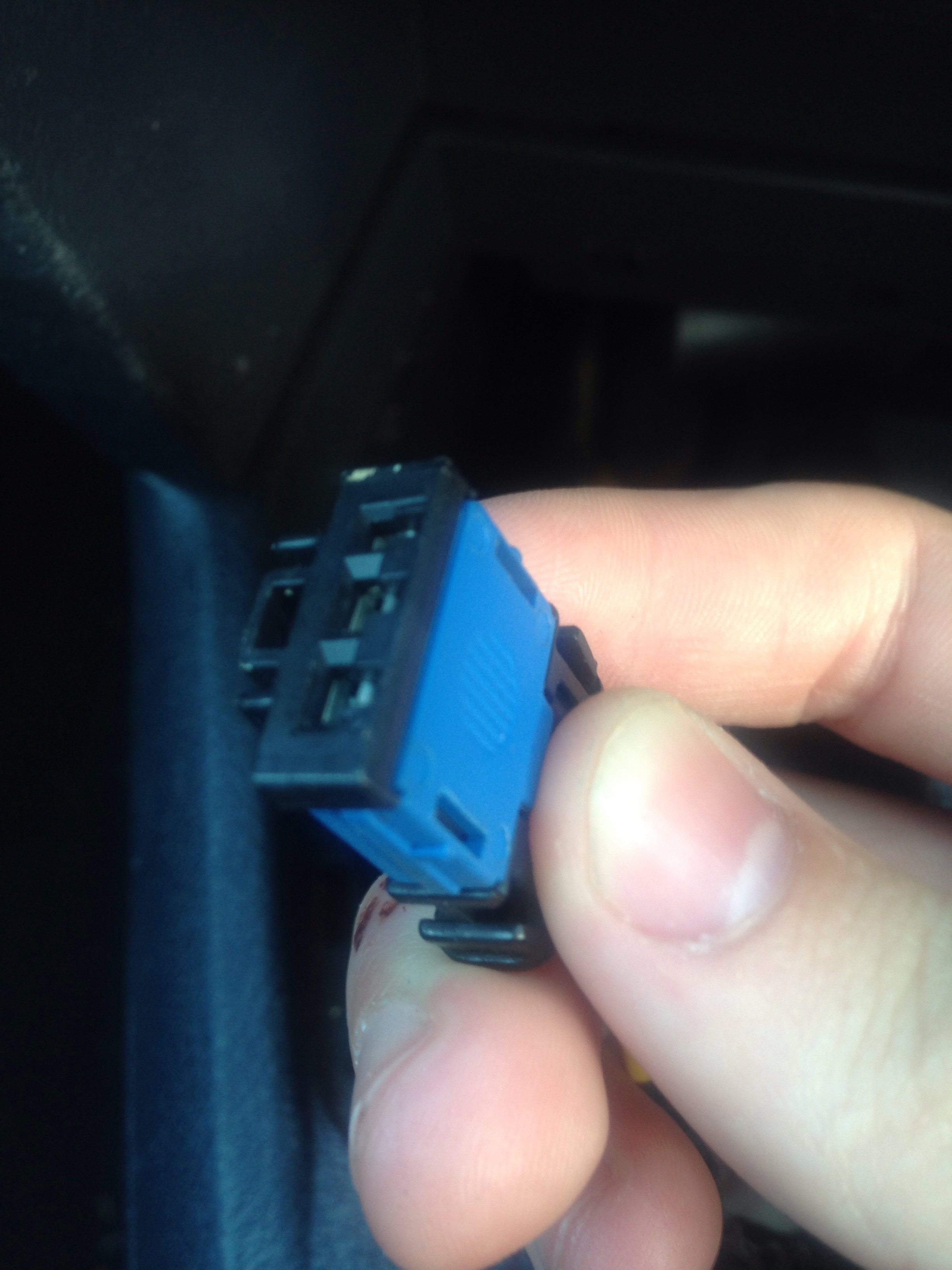

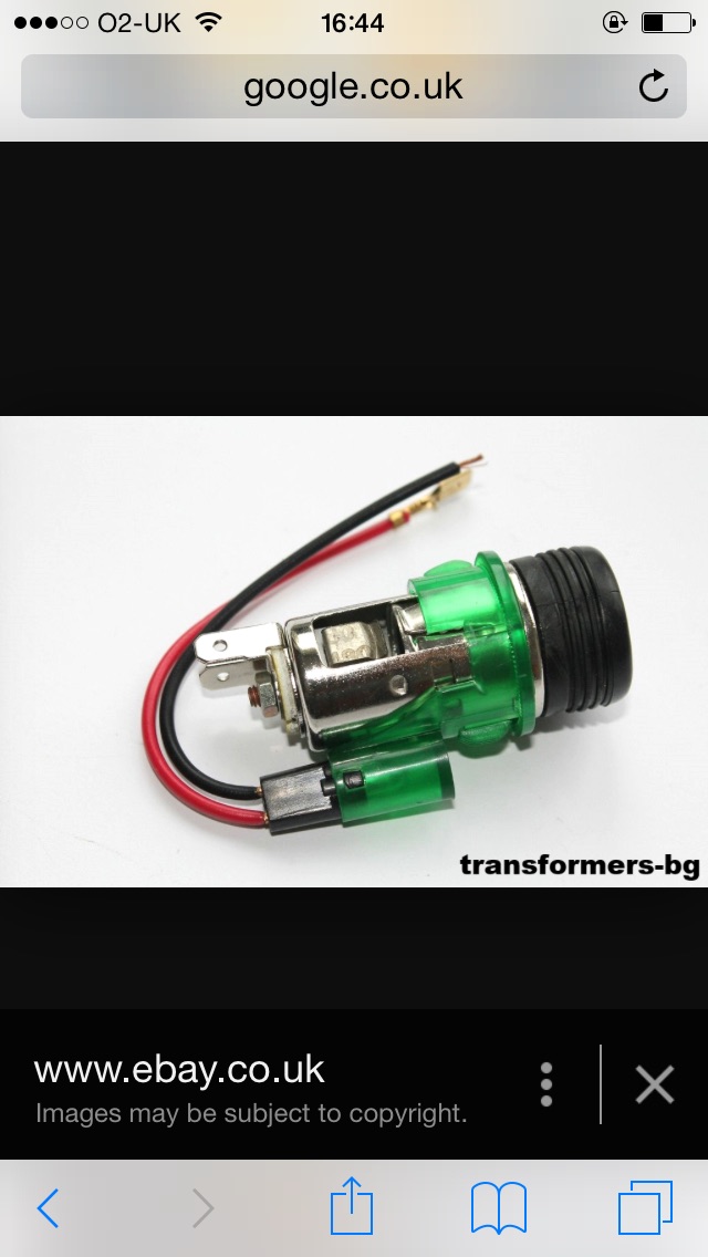

I own a Renault Clio 1.2 mk2 2006 Campus sport, I need a replacement cigarette lighter; I bought one from Amazon which comes with two wire connections (Amazon picture attached) however the connection I need instead requires a port to connect them (own picture attached).. Any help would be much appreciate as I cannot find a replacement lighter socket at all!
I had the same problem in a megane and found it much easier just to go to the breakers and get the cigarette lighter and the piece of trim it was sitting in and just fit that, so that's what I would recommend. As far as the replacement you've bought goes, it'd just be a matter of removing the connector and joining the corresponding wires to the lighter itself.
