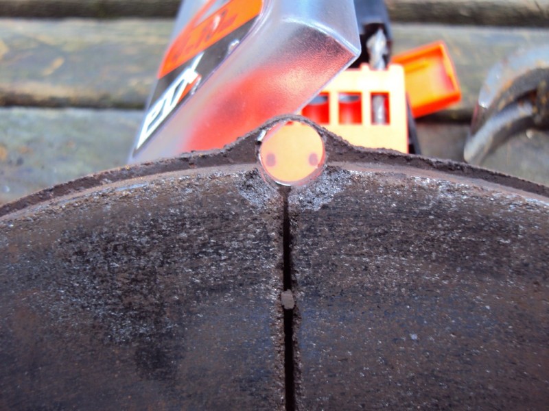

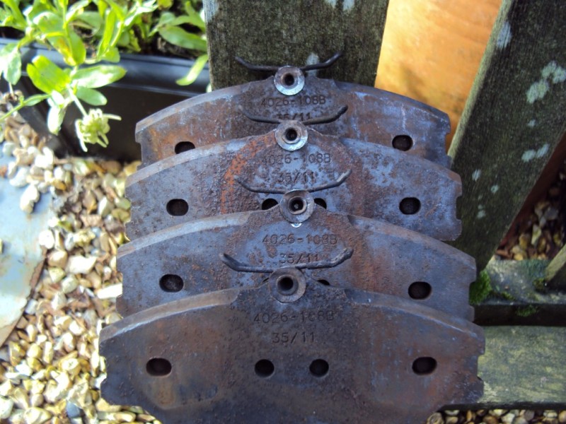

Fitted my CL pads back on today but retrofitted some anti rattle clips for anyone whos interested, not the neatest job, but they worked perfectly :)
Shitty mintex pads removed from car, the clip pop off using a screwdriver and hammer pretty easy. Drill holes in CL pads, hit new clips in :)
