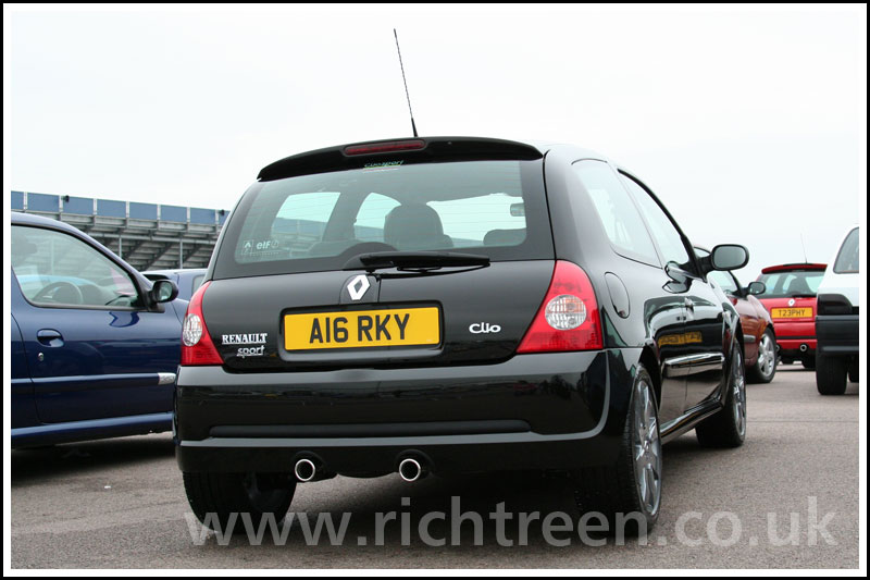

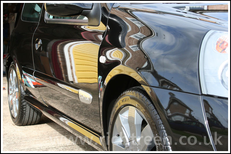

  106 GTi
Last ones I had where not that great as the FCS was really dull.
Rest here.
Best recentish ones where when I cleaned it up back in March tbh
Full Gallery here http://www.richtreen.co.uk/images/concours/
  H22A7 Accord Type R
okay, Rich, i have looked at all your pictures and have came to a few assumptions.........
1 - Your car is not your daily driver, 2 - car care is your hobby, 3 - has the car ever seen above 70 (stone chips??) and 4 - that is minter than when it leaves Renault!!
  106 GTi
1. Indeed it is not.
2. It is.
3. It has chips :( most have been touched up and polished though.
4. That is the aim!
