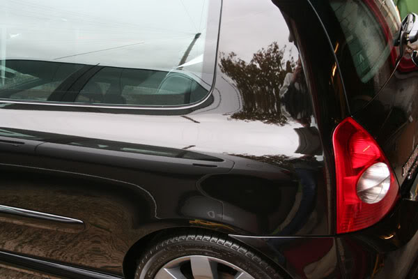

On Inferno you need a nice clear looking Carnuba wax that allows the metallic flake to pop
I would look at Poorboys Nattys Blue, P21s concours look wax or Meguiars #16.
The first two are easier to use and look slightly better IMO than the #16 but it will last longer but can be a pain to use.
