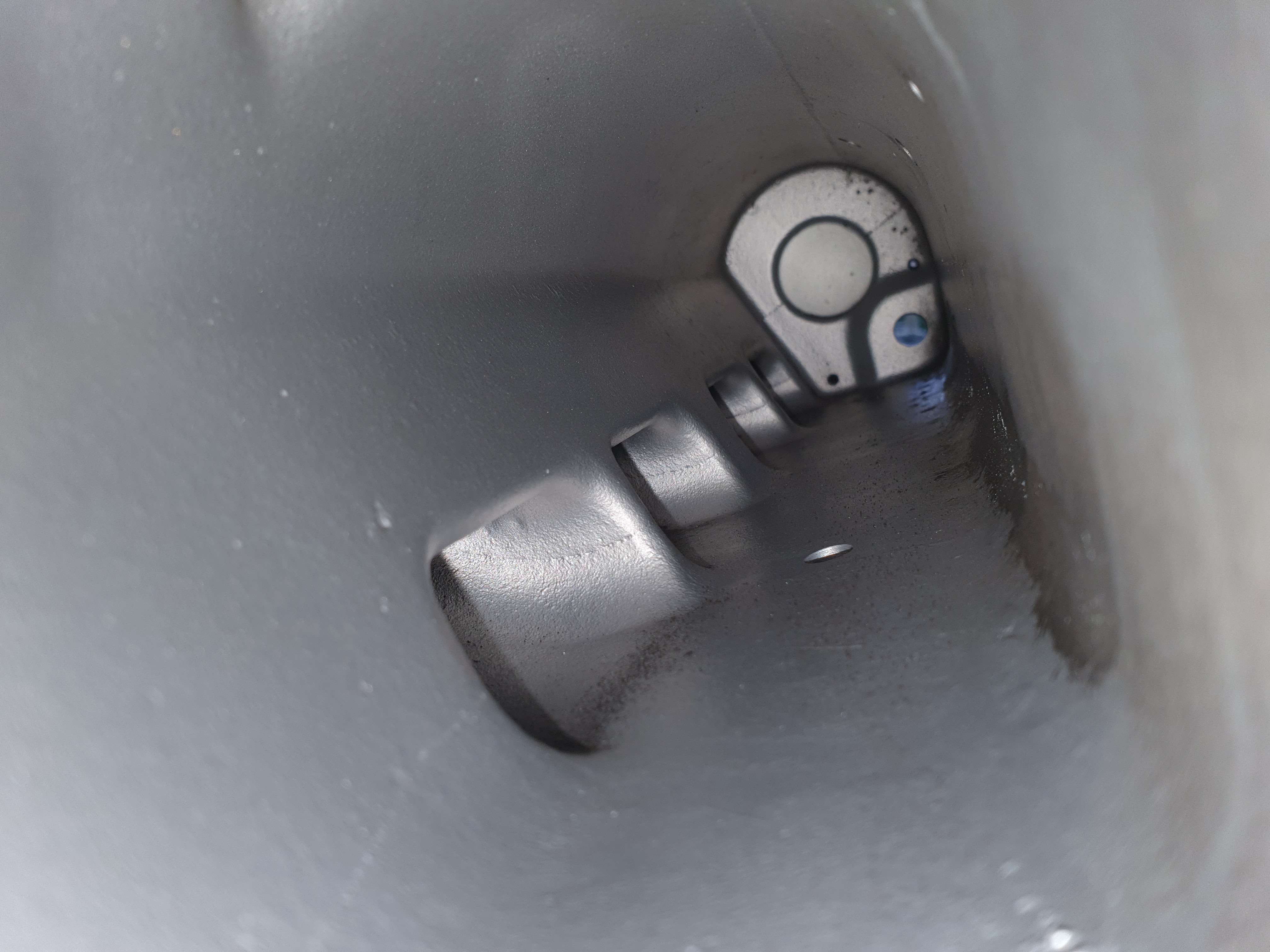

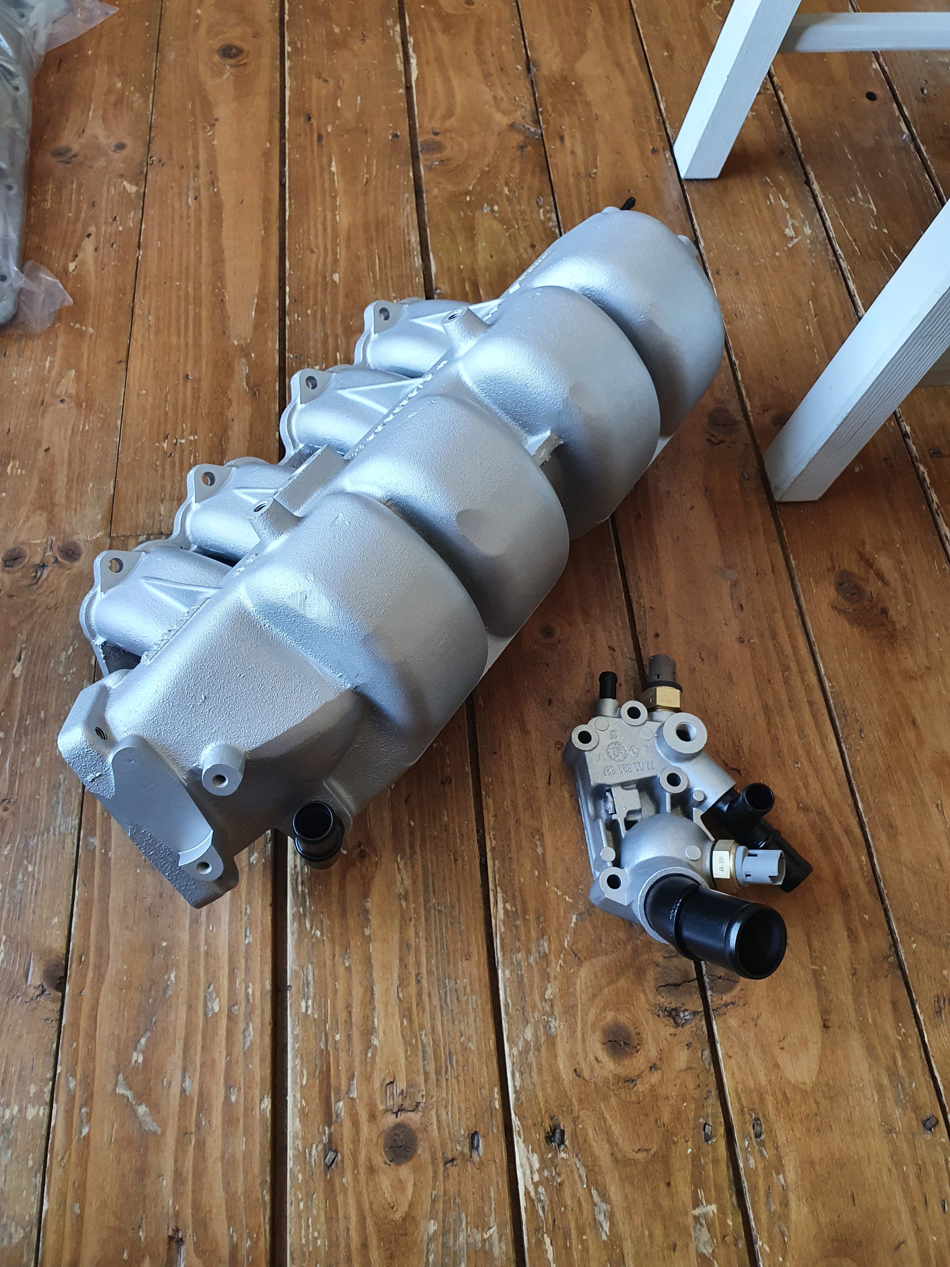

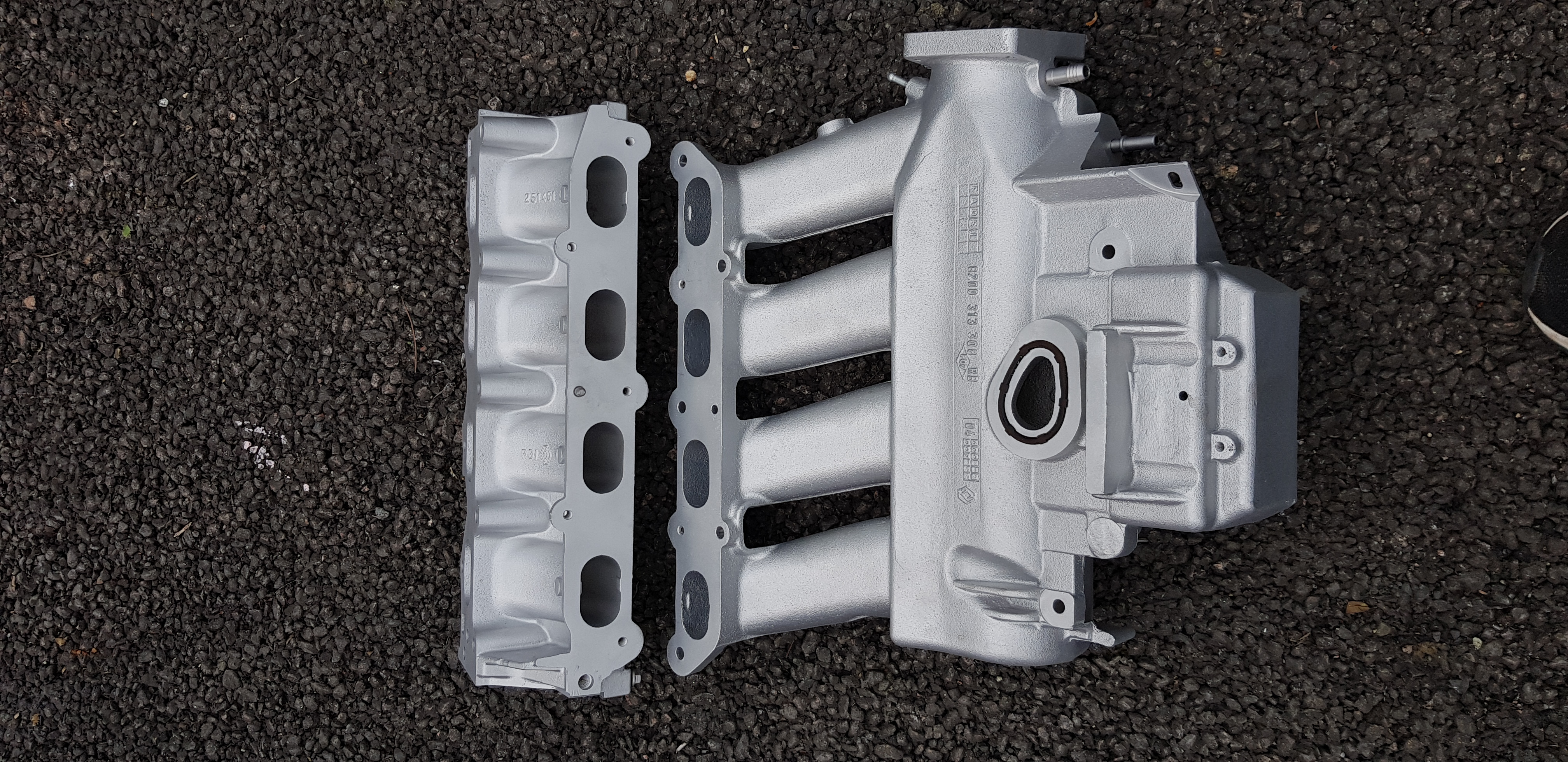

So iv had my inlet aquablasted on my 16v, all looks clean but a friend of mine recently had the same work done and a load of grit got into his engine as there must have been some left in the inlet
This has concerned me a bit as I can't see any obvious grit in mine and have run a hose through it.
The dark dirt you can see seems to be stuck to the inlets as if it's a mix of grease and dirt and doesn't seem to want to budge with a hose
What are my options? Even been contemplating finding another inlet just incase as I don't want to trash my engine

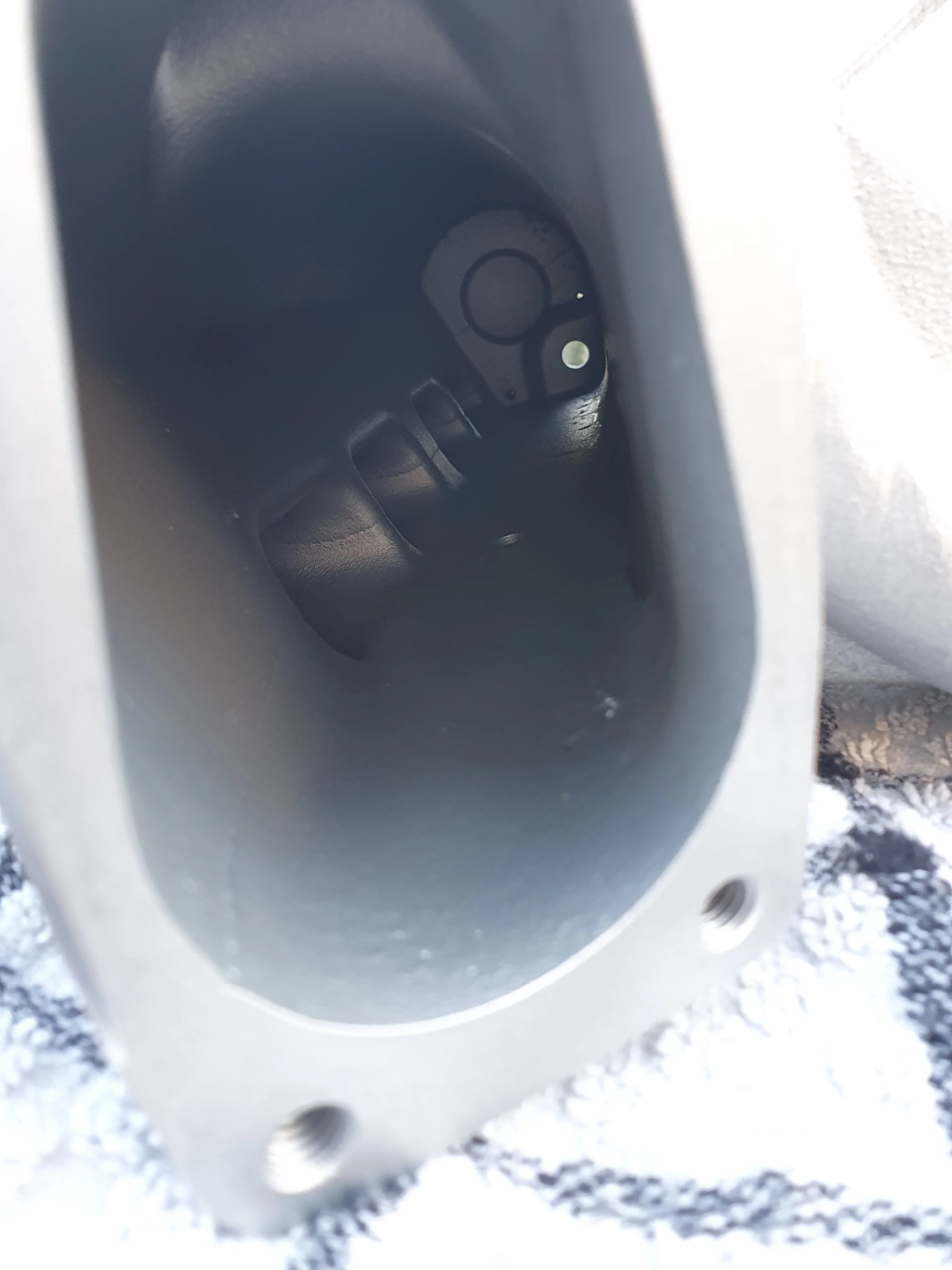

I recently had my inlet vapour blasted and they advised me to wash it out thoroughly before fitting it, which I did and haven't had any issues.
They don't wash it out, so cannot guarantee all the tiny blast particles have been removed.
I did pretty much what @Touring_Rob suggests, and just for good measure blew a heat gun through to dry it
Having had another look at your photos I don't think the greasy bits are too much of an issue, they just look like oily deposits from the breathers that haven't been fully removed by the blasting, so were probably always there.
No evidence of the tiny balls that might have caused your friend's issues
Yeah the inlet was stinking (30 years worth of greasy dirt)
Do you think it's worth spraying some light oil inside so just incase there is any more grit left in there it might catch some of it?

Think il give it another flush with the hose then just to make sure
Thanks for the reassurance from both of you tho 👍
when i ported mine, i used plenty of oven cleaner spray and jet washed it out for waaaaaaaaaay longer than i needed to.
I might just try spraying in some engine degreaser and giving it another brush/wash out. If you shift some of those remaining oily bits I reckon you'll definitely have cleared all the loose particles as well.
A question for the experts: out of interest what components would be damaged by a few of the blast particles? I would have thought they would mostly just get blasted out of the exhaust? Scored cylinder bores? I have no idea really.
If you're paranoid then take it somewhere with a big ultrasonic cleaner for a good wash. That should get rid of anything that's left.

Literally everything! Valve guides, bores - lots ends up in the oil too.
Although that would be a decent amount - a small particles won't do much. His inlet looks pretty clean as is so I think he will be fine. I had a rocker cover blasted years ago from a ford CVH. They have an oil separator in them. Just before install I gave it a whack and about a coffee mug full of blasting grit came out!
