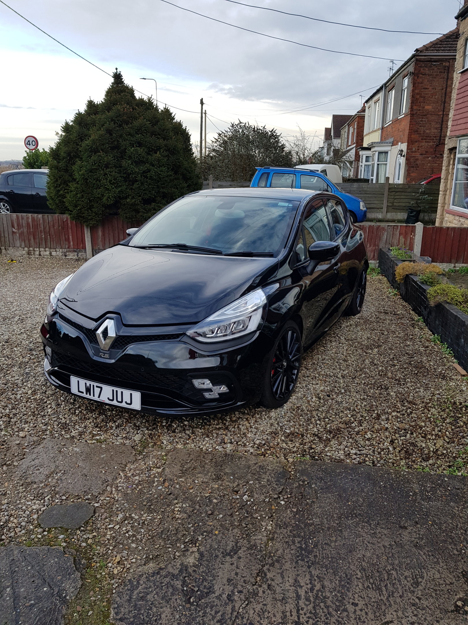

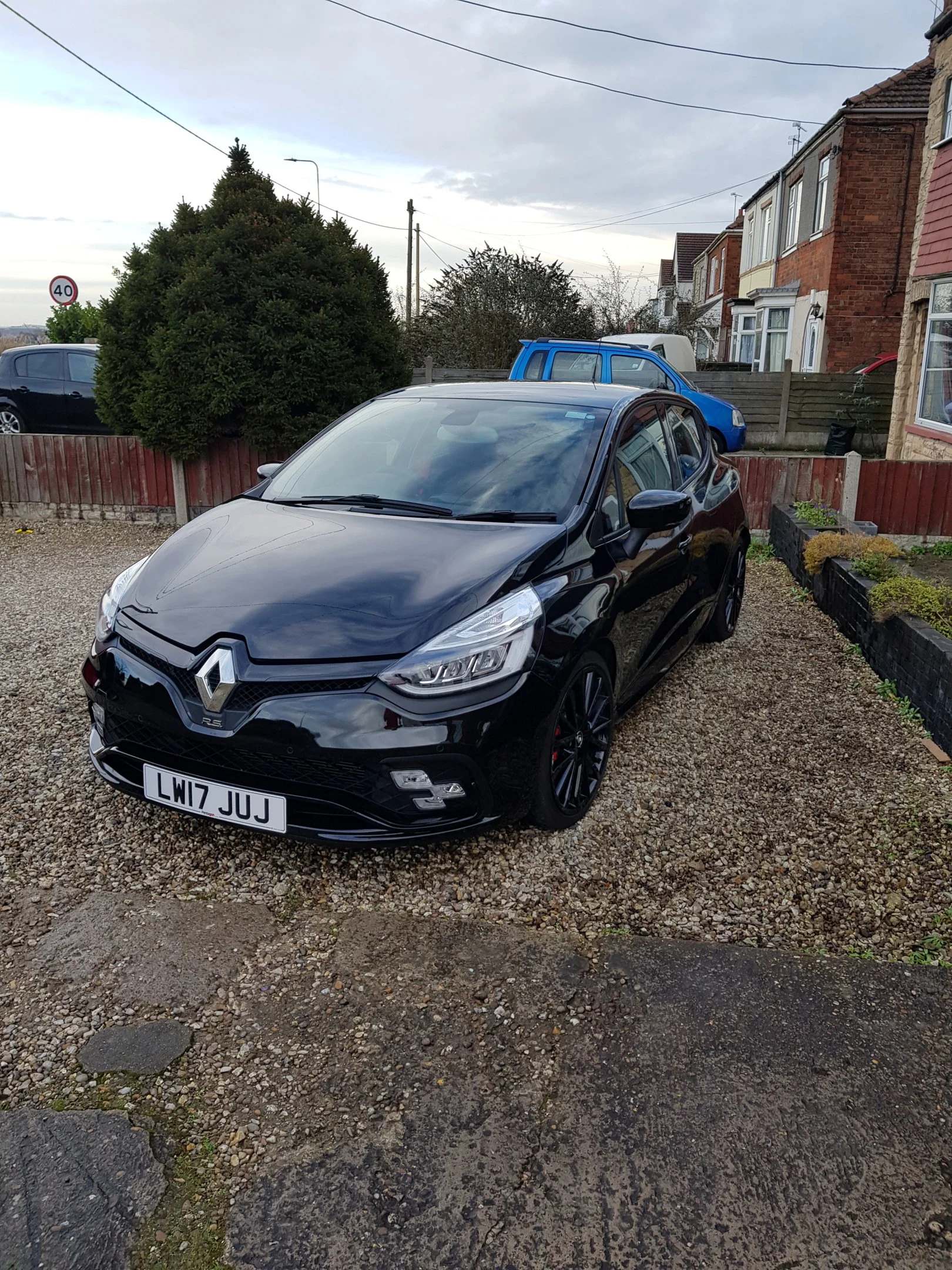

Alright Guys,
I have bought a RS Clio Trophy 220 in black. After picking it up I have seen swirl marks in the paint and I want them gone.
What's the best stuff to clean the car with and what's a good wax/polish to use.

You’ll need a DA polishing machine if you want to remove the swirls.

It’s definitely worth investing in something like a DAS6 pro http://www.cleanyourcar.co.uk/polis.../das-6-pro-dual-action-polisher/prod_673.html
You’ll use it loads. Even after you’ve got the swirls out you can use it a couple of times a year to get the paint proper glossy with glazes and very fine polishes.
They’re proper easy to use and there’s loads of tutorials on YouTube.

Megs Scratch 2.0 is more of a cutting compound, so you're more than likely to be inducing swirls just by the nature of it.
Think of it like T-Cut.
You'll need a finer finishing polish to safely remove swirls.

Worth getting some decent microfibre cloths as well, because cheap ones will cause light swirling and marring.
You want soft and plush ones for paintwork.
These are nice and soft: https://www.amazon.co.uk/dp/B00BK79YUO/?tag=cliospnet01-21

Best to just reiterate the basics.. Two buckets for washing, lambswool mitts (I use two, one for the cleaner half of the car and one for everywhere else), drying with a large soft microfibre cloth rather than a chamois, clay bar decontamination before using any sort of polish (I use the simple Meguiars kit), I don't use a polishing machine but get good results just doing it by hand with a small application pad, simple wax/sealant treatment (even ArmorAll Shield does a decent job).

That's ok, it depends how deep you want to go into cleaning/valeting/detailing. You can remove swirls with just a good clean, clay and polish by hand and then add some protetion with a wax including liquid waxes. I use Autoglym Super Resin Polish, nothing special but it does the job applied with a simple soft applicating pad and then buffed with a soft polishing cloth. In my opinion the clay is the most important step as that is removing all the contaminants that are causing your swirls in the first place, my Clio had been polished without decontamination first and it was that polishing that caused all the swirls!

SRP does contain a few swirl fillers, so you won't get a 100% true finish but it's good enough for the hobbyist car cleaner.

I just want to look right and not like some of the black cars you see, when the sun hits them all you see is the swirls.
Probably more my own fault for getting a black car (something I said I didn't want again but it looked so good).

If you’ve got the facelift trophy, be warned the gloss black on the alloys scratches from a stiff breeze, be sure to use the softest brushes you can when cleaning them. I found this out the hard way :(

Thanks man! So far I've been using a mitt on them! Shame about yours though :(
