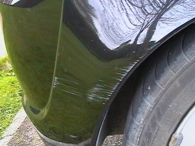

Also could you give me some advice on how to remove this mark. Would scratch x work on it?

The scartch to me looks like it will improve with a good polish, but doubt anything other than a repaint will sort it 100%.
The PC is popular as it is random orbital so is effective on swirls but hard to mess up and damaged paint and burn through as you can with a Rotary. The safety maragin and the fact it works well makes it as a good choice.
