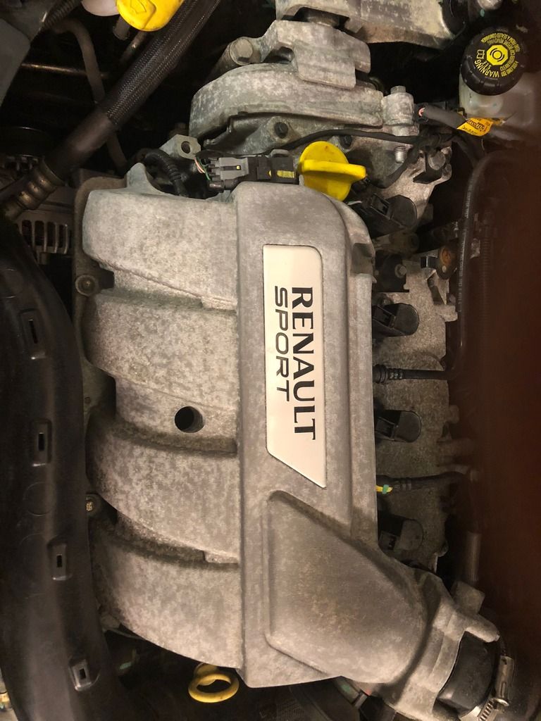

I have just bought a 2010 Renault Clio RS 200 and would like to clean the oxidisation off the aluminium parts of the inlet manifold etc as they are quire badly corroded / oxidised. Any thoughts on the easiest way of doing this? is there a cleaner that will remove it or is it a case of wire brushing? Also if I get it cleaned off is there a recommended paint to paint it with to stop it happening again.I've used some aerosol engine paints, and after a while they've gone to look awful, faded etc.
Any pointers would be gratefully received!

i'd give that a go with a stiff bristled nylon brush first and then a quick wipe over with gt85/wd etc. i reckon that should just about sort it.

I'll give those suggestions a try. Closing the bonnet might be the answer but I suspect it will niggle at me.

Autosmart Alu brite seems to work wonders - only done the engine undertray on the M3 and a test patch on the inlet of the 182 but it cleans everything off.
