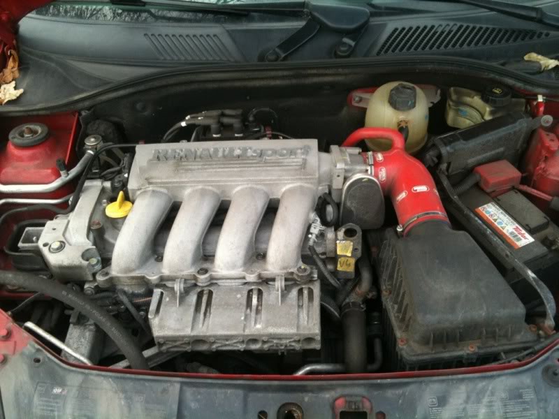

What’s the best approach to cleaning the engine as best as possible to remove oil, grime and general crap.
Doing track days I want to be able to come back from track, clean down the engine and be ready to go again.
As it stands, the bay is grimey and would be hard to tell if there was a new oil leak after a day on track.
I want to be able to give it a good going over, without having to remove the engine and go full aqua blast.
I don’t mind getting my hands dirty and spending time doing it but just wondering what the best approach is.
Obviously i will be taking off inlet manifold, elbow to air filter etc and wondered what other people did for a general clean of the bay.
It doesn’t need to be show spec but would like to be able to notice a new oil leak when it arises.

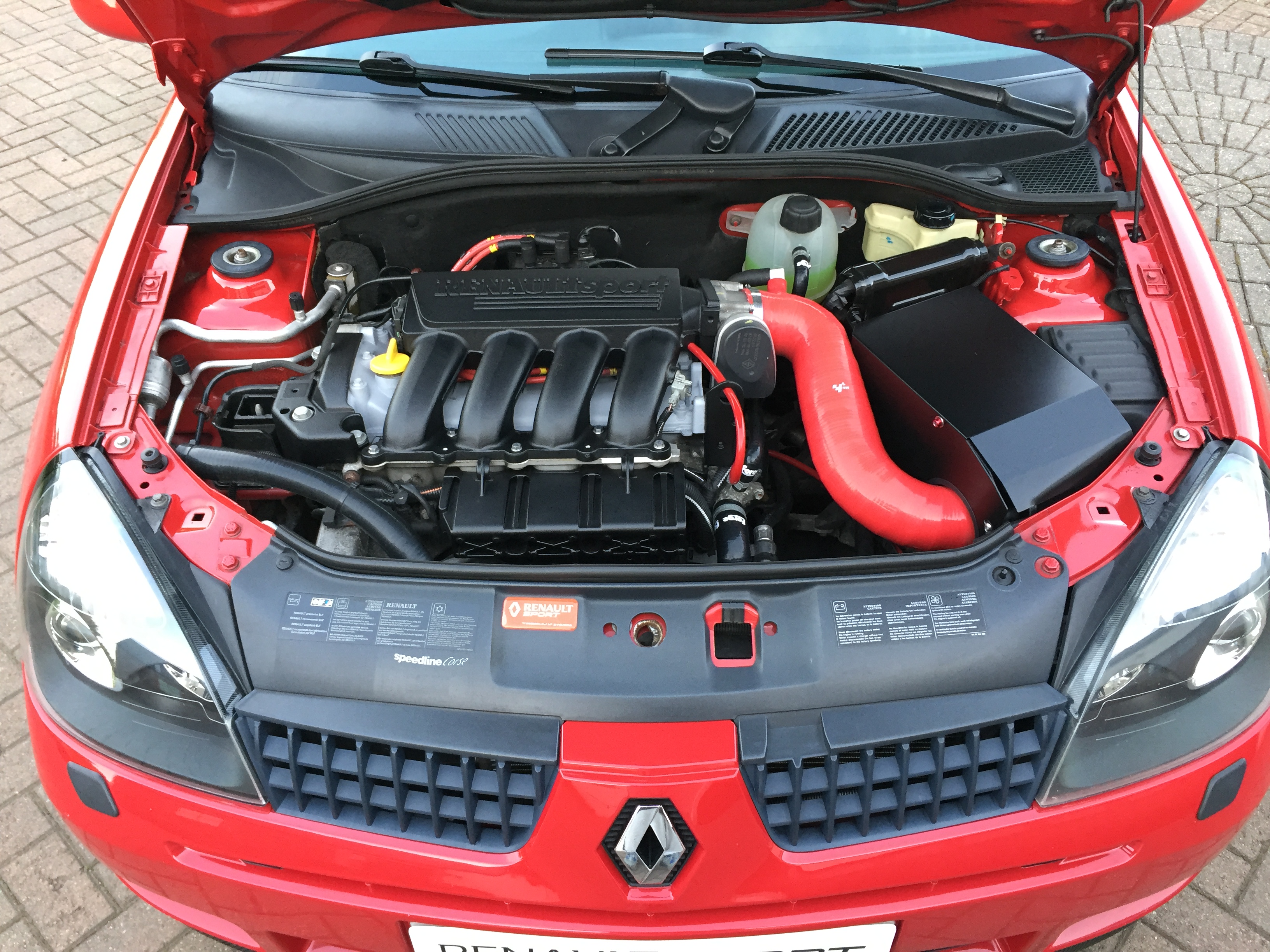

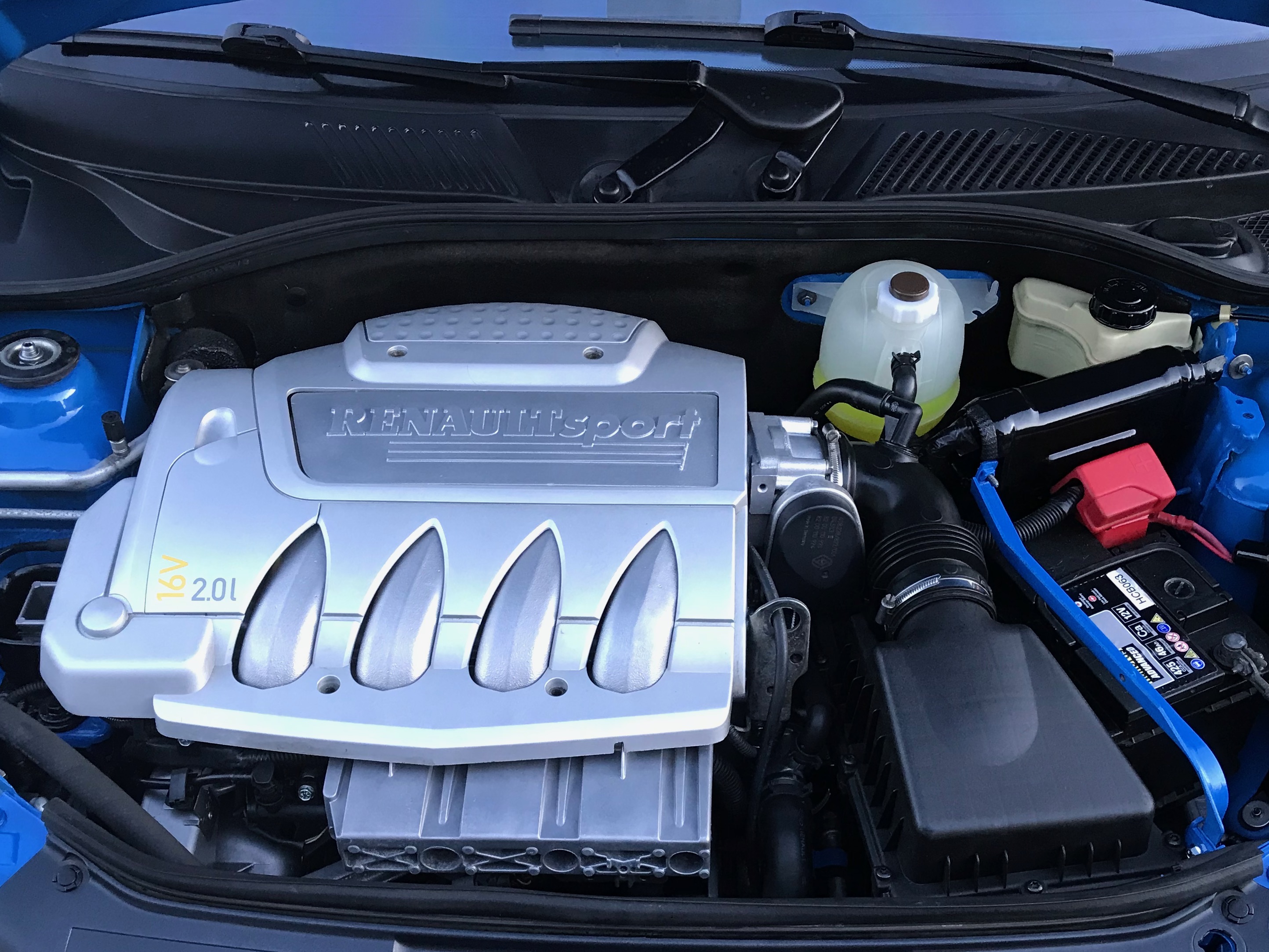

This is what I want the finish to be like. So just shed load of TFR and a steam cleaner?

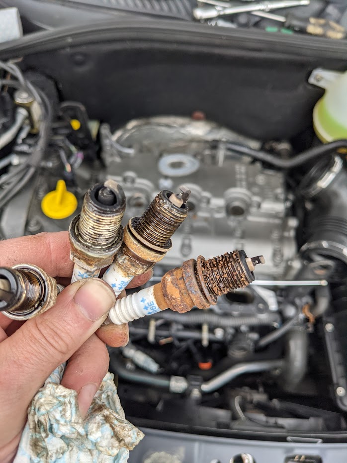

This is my spark plugs a few weeks later (they were a month old)... good reminder to not fill the holes up with water!

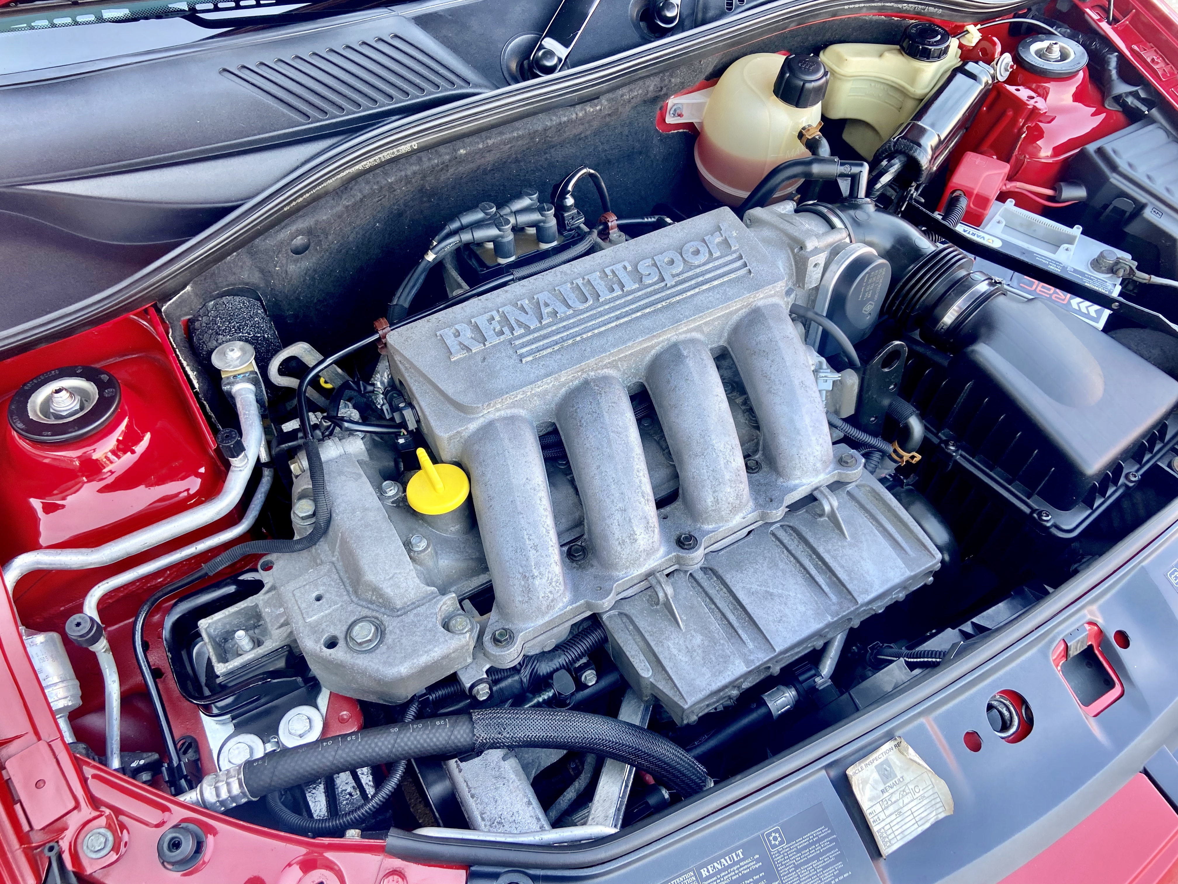

TBF i had my engine out on the above picture. I used a degreaser to wash all the oil off, then painted the block with Black VHT paint, touched the rocker cover up with VHT Silver paint (using artist brushes) and had everything else aqua blasted. On the plastics I just used a degreaser, then back to black plastic restorer.

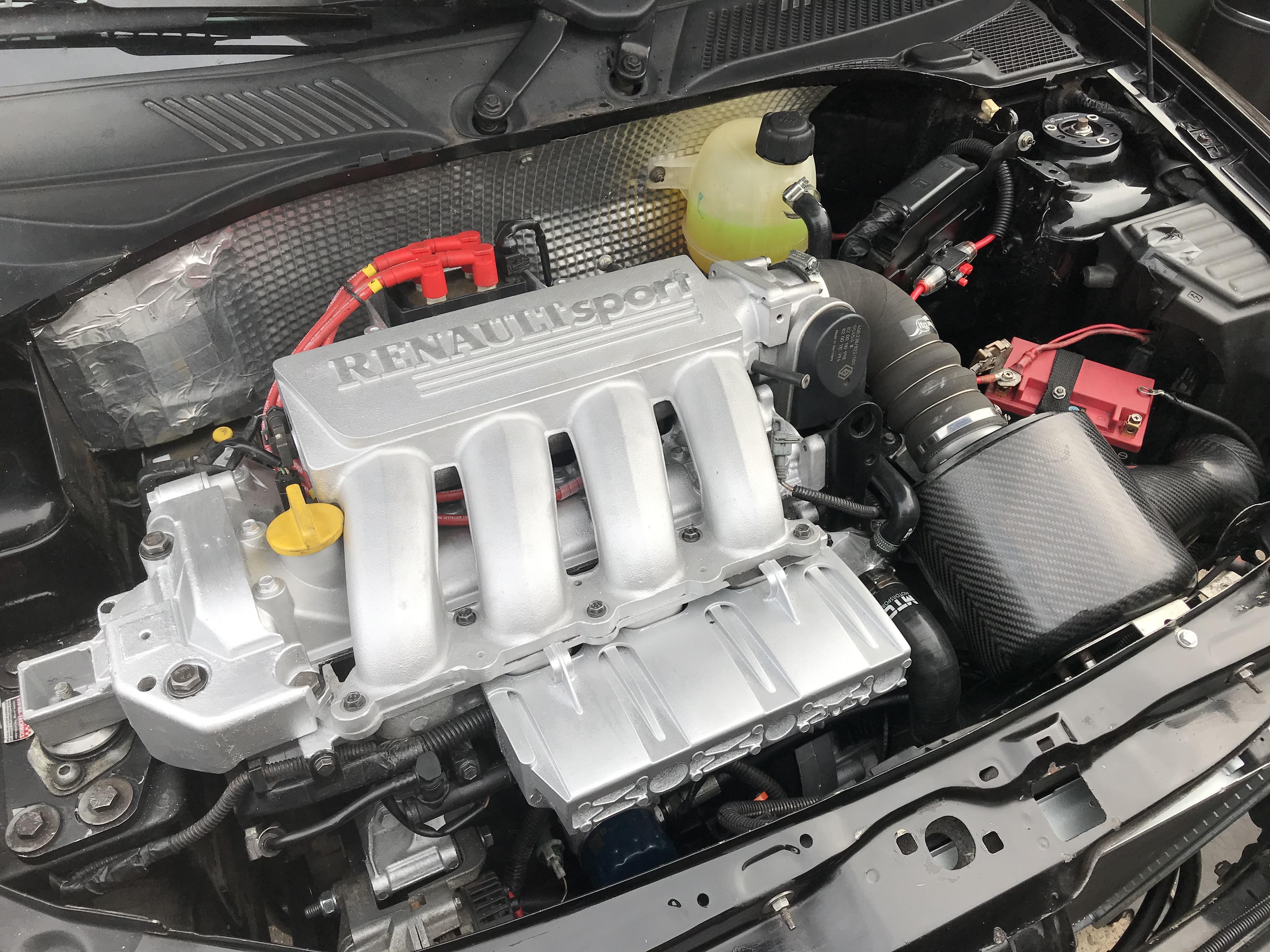

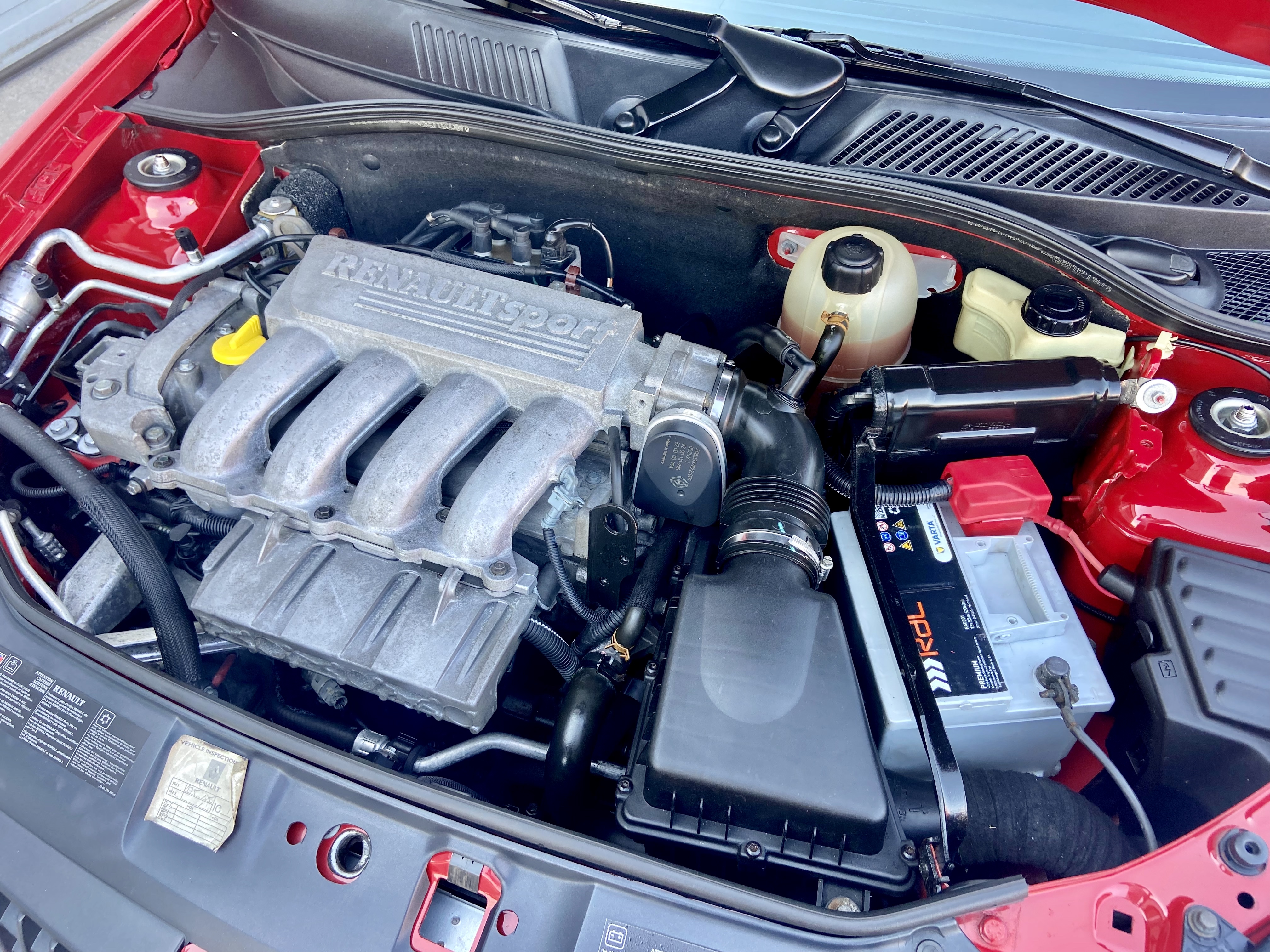

I have done an engine in situ though, see pic below from my track car. And used the same technique as above. The inlet, rocker cover, fuel rail guard etc was Halfords VHT Silver.
Any quality degreaser will work on anything under the arches, driveshafts etc.... Once it's all clean use paint, VHT, etc.....to make it all pop.
Don't be scared to strip things back as far as you can, so once you build it back up, you get the effect of the whole engine being clean.

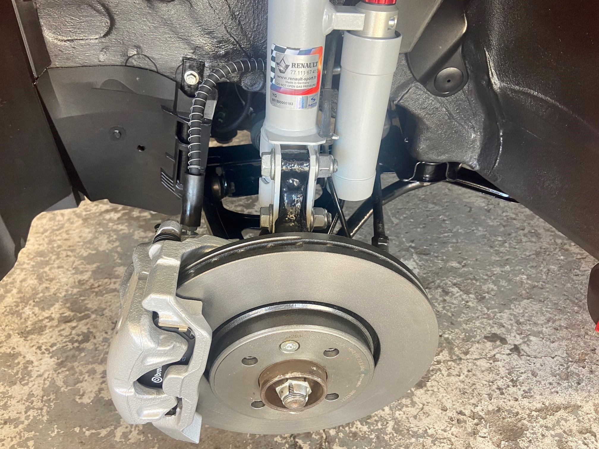

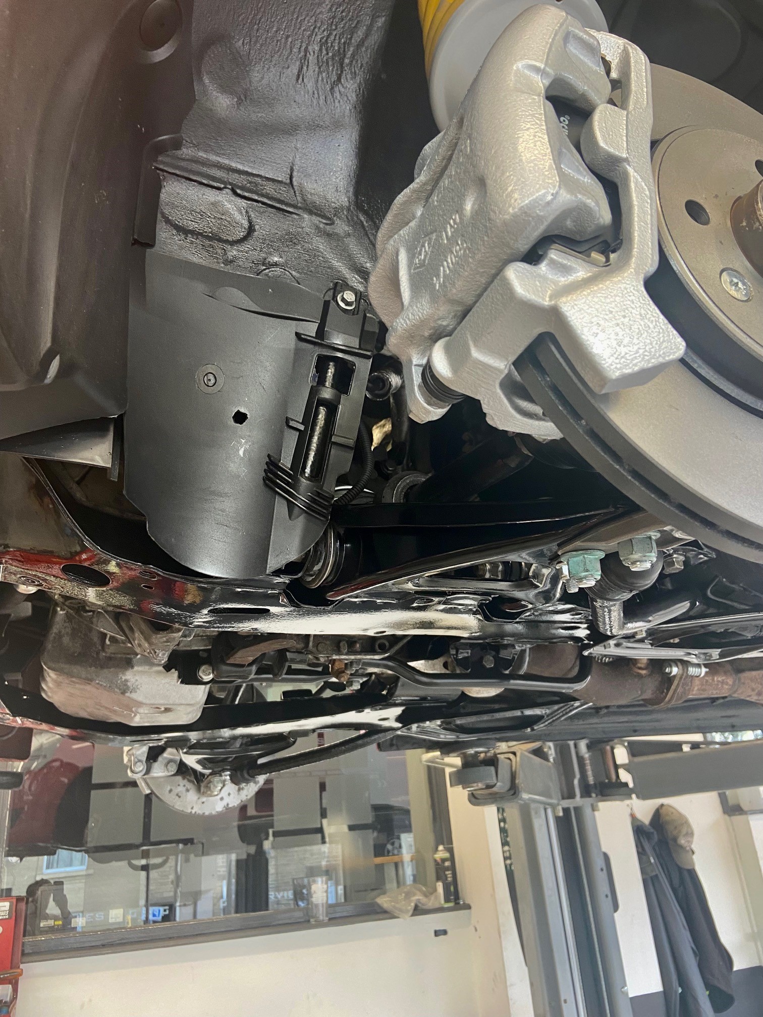

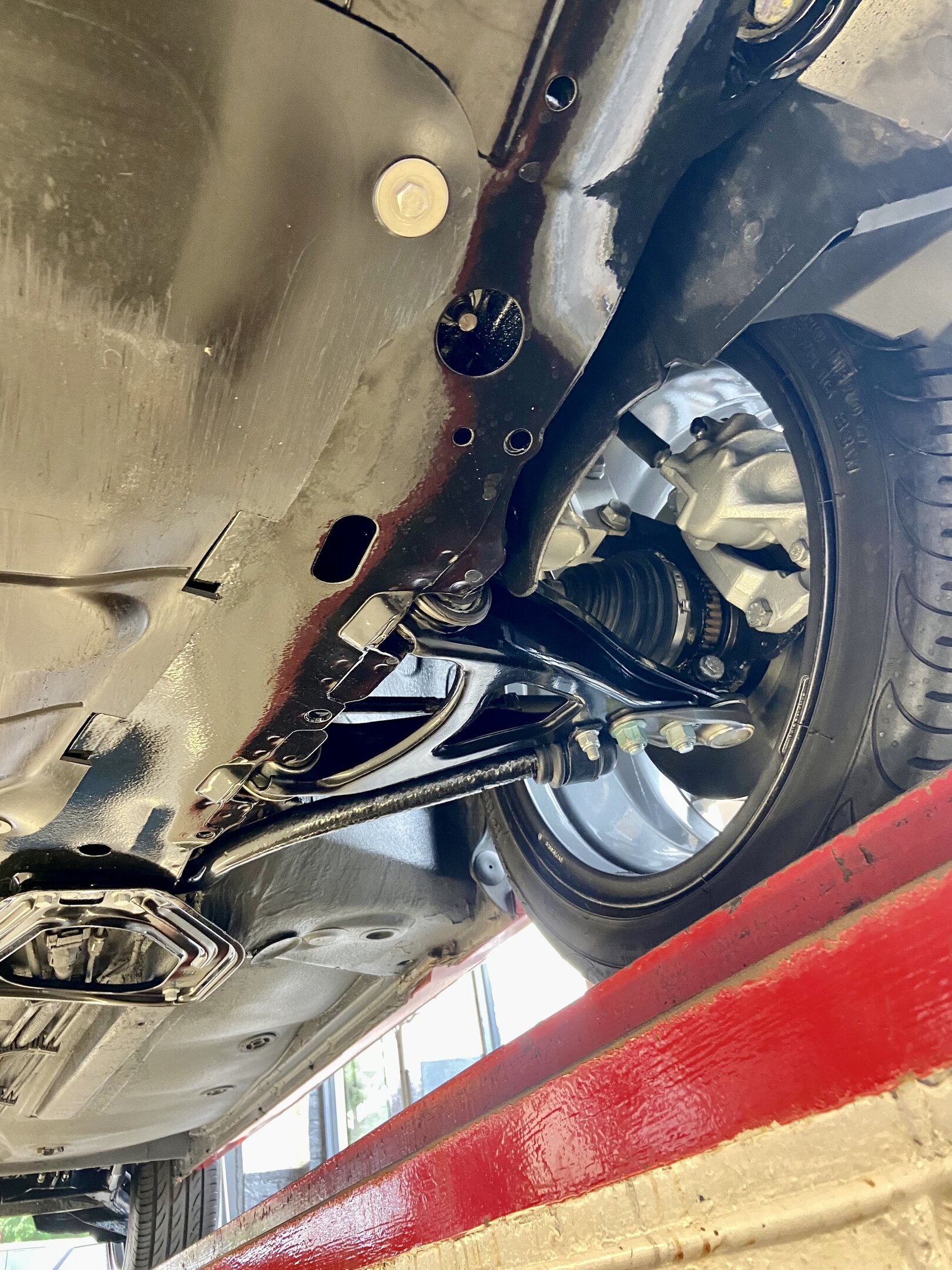

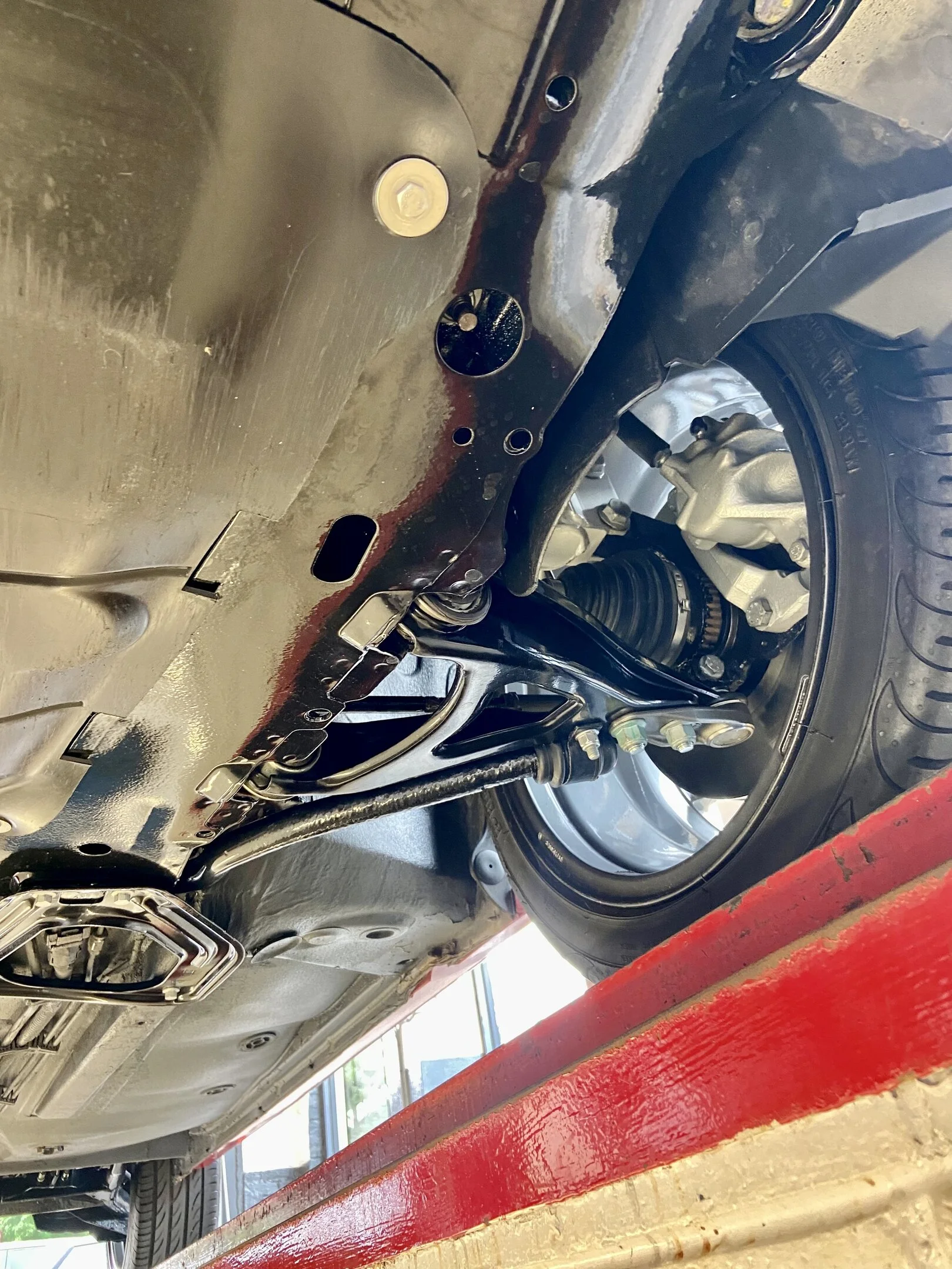

I wish I had talent to take out engine's Mr Underhill :) - that's why I'm only trusted with a Steam Cleaner -
I was lucky to jet wash the underneath on a garage ramp before doing the gravitec and lanoguard protector -
Yours is the best one on here IMHO. Goals.....

Even on a ramp, I don't think a jet wash would get mine looking like that 😂
