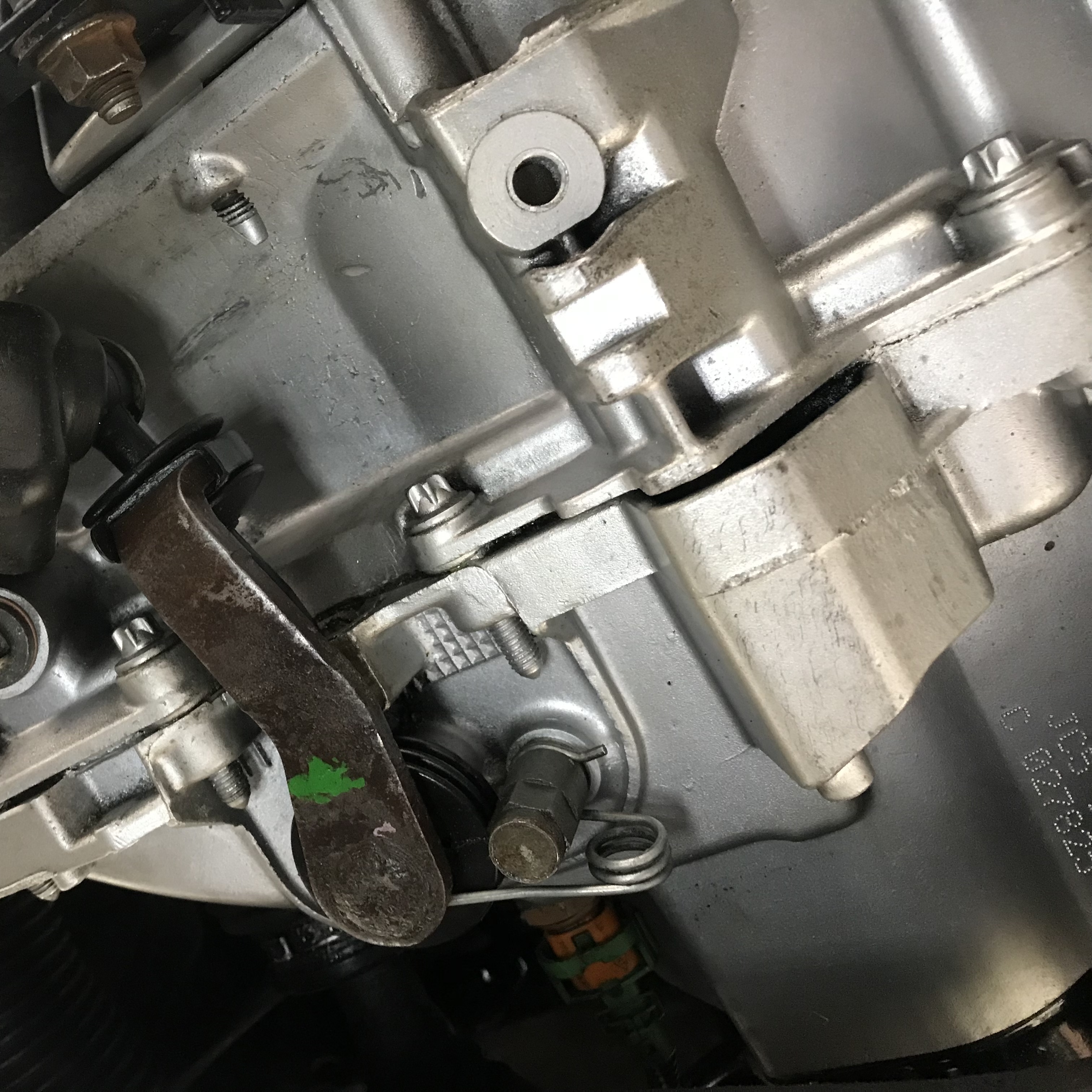

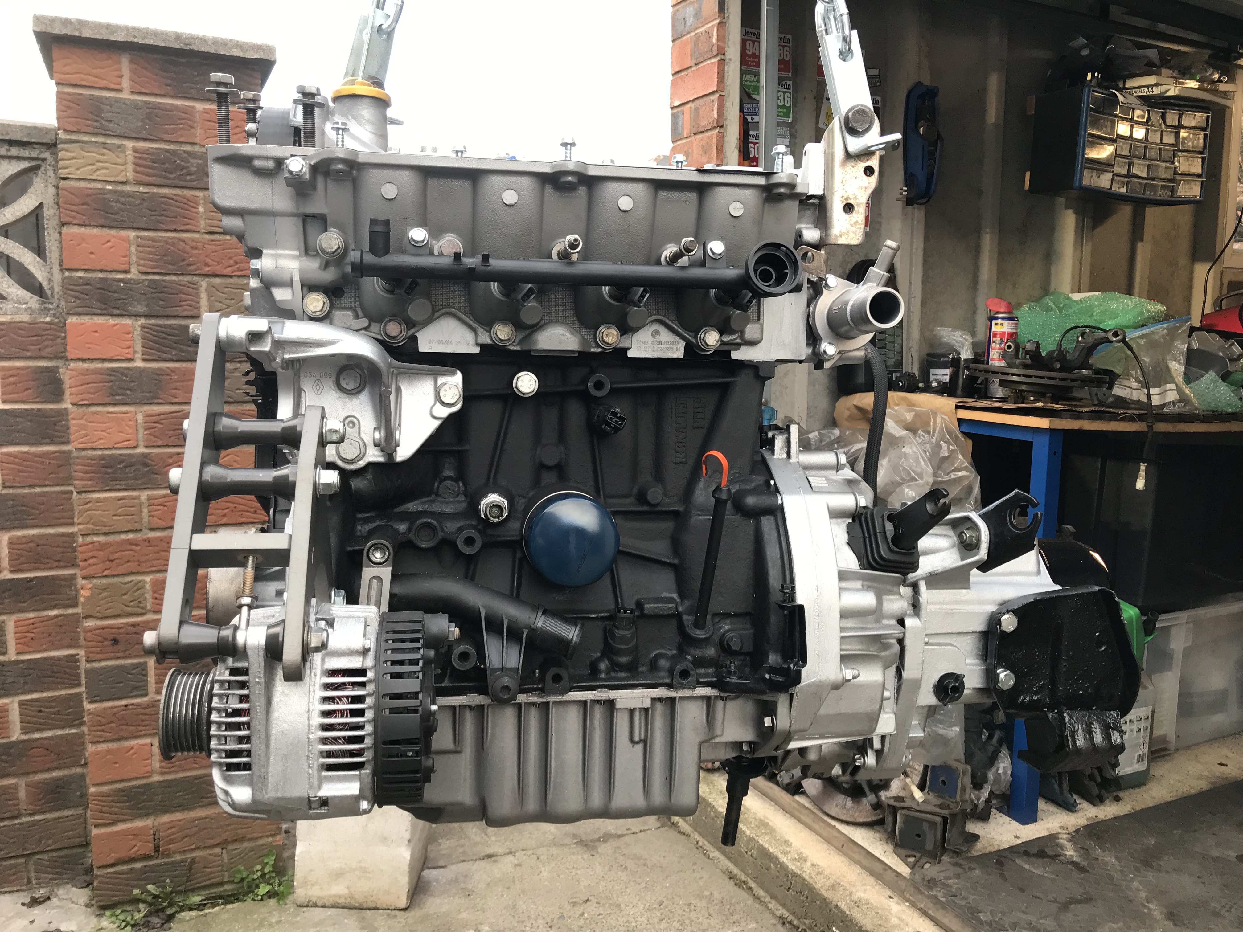

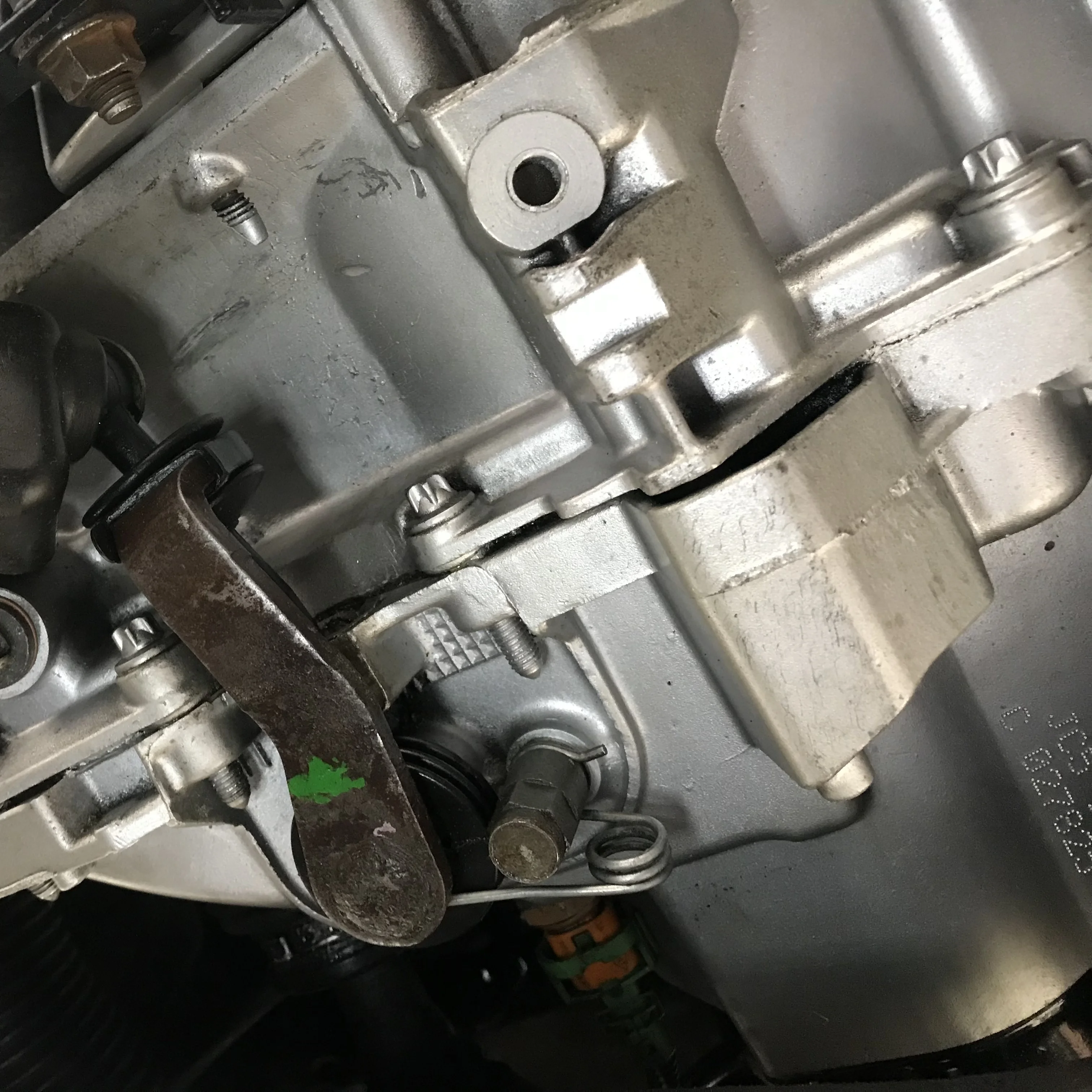

This is mine. Gearbox degreased then painted with VHT. Sump, Upper and lower inlet, fuel rail, thermostat housing all aqua blasted.

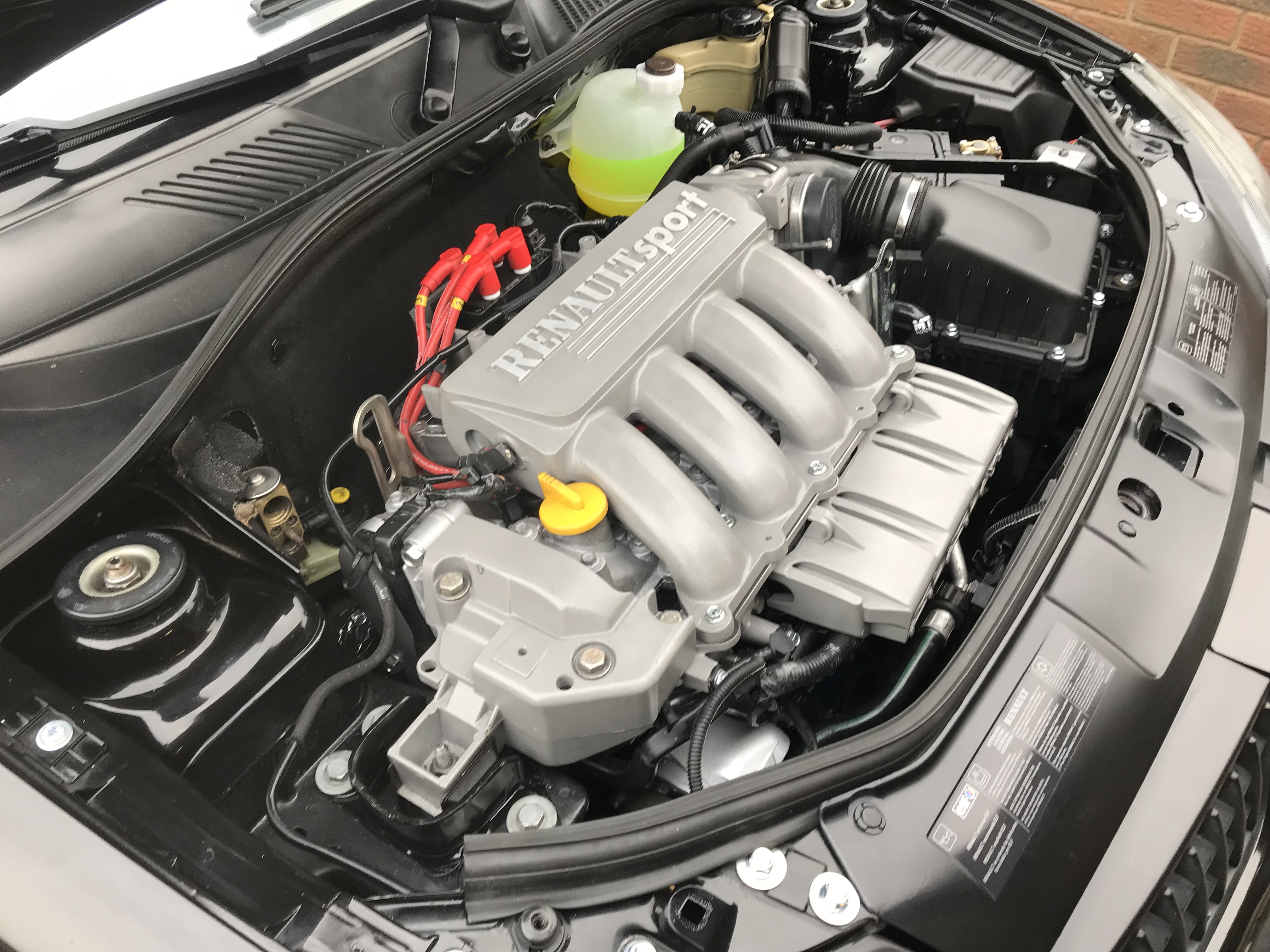

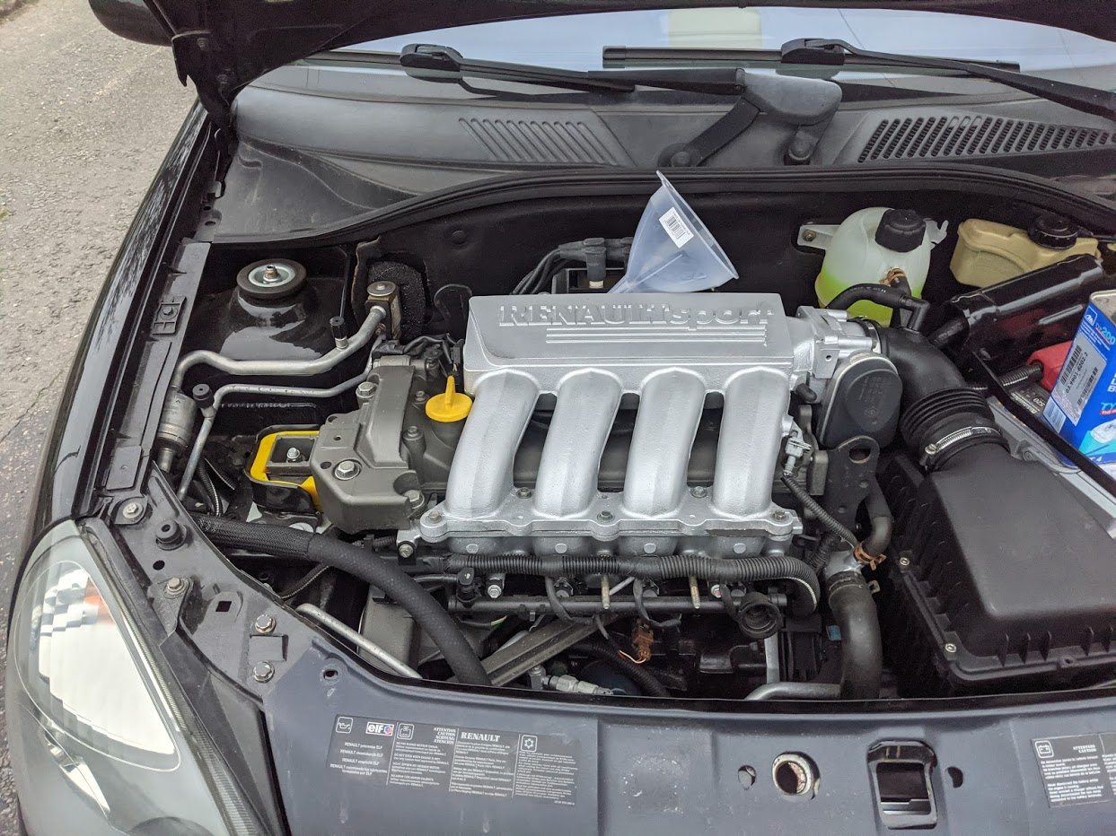

Thats the Eastwood Aluma on my inlet manifold after about a year. I would use it again.

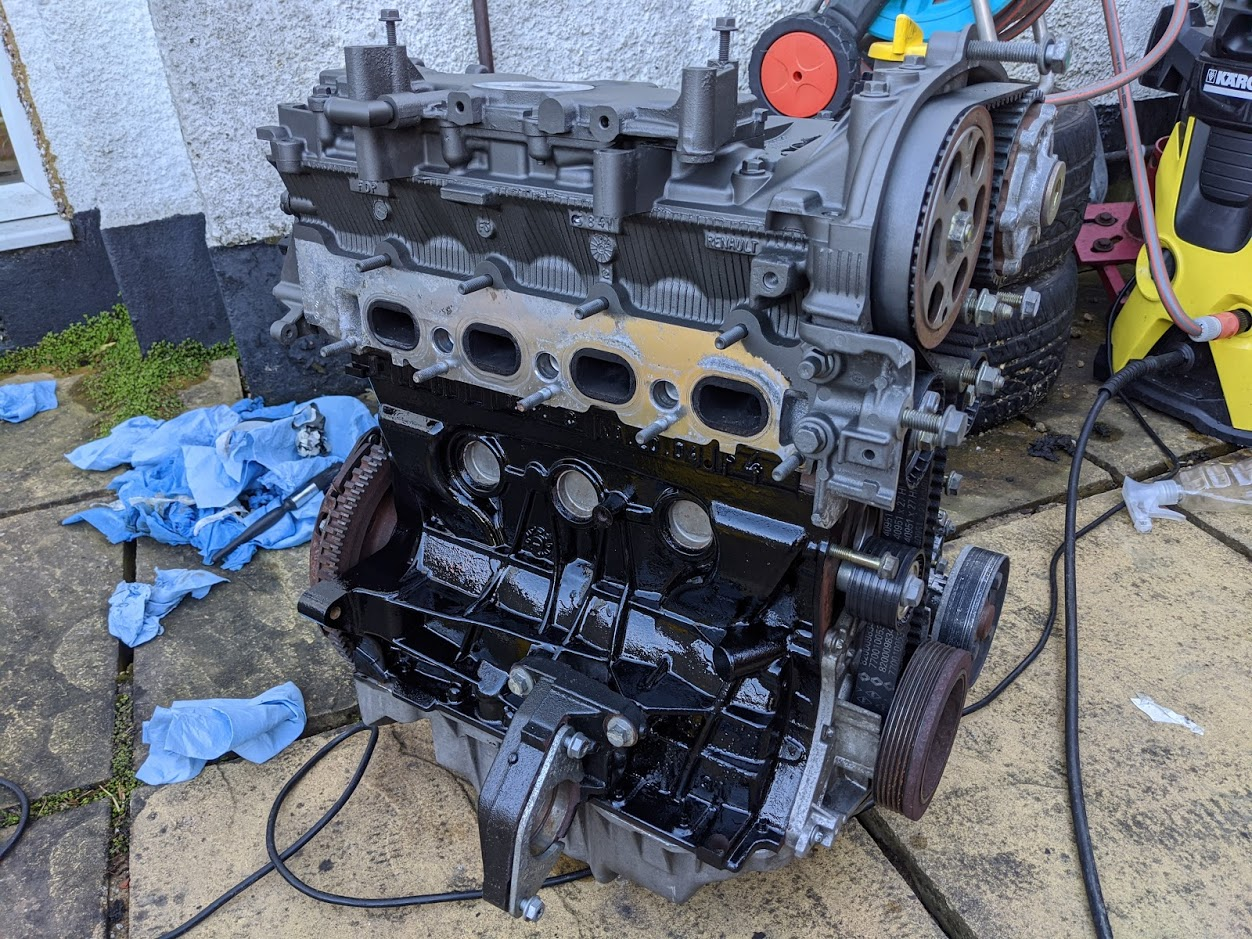

This is block brush painted with some VHT engine block enamel - still fine several years later having gotten dirty, jet washed off, covered in PAS fluid when my pump died. The engine block looks about the same still, certainly no rust. The rocker cover was painted using some eastwood cast steel (I think) paint and thats been s**t, while the aluminum eastwood paint has been durable.
Doing it all again I would take a boot full of parts to a vapor blasters and pay the money, I'd probably 2K paint the bits next time round too.
