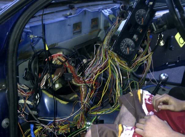

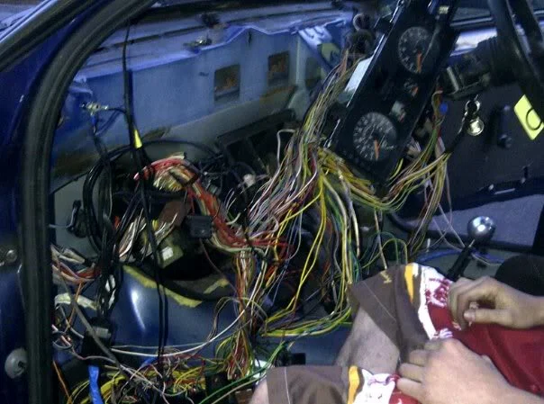

i cut down my own loom in my mk1! will be doing it again to my mk2 track car. its stressful stuff, but nothing overly complicated!
all i did was made sure everything worked whilst unplugged then slowly and carefully worked back through the loom to the fuse box, the only thing that becomes an issue is shared earths!!
you can do it yourself, but my one piece of advice would be this
DO NOT RUSH!! i took my time and fell for the not linking shared earths back up!! scared myself to death until i figured out what i had done tbh, thought it would be new loom time!!
it was quite unnerving at this point!
