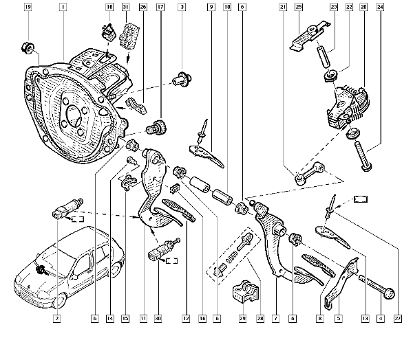

Here is a set up of the 182 clutch pedal assembly - Ive had a few in the past were the clutch ratchet mechansim has failed. Personally i would shine a torch up there and continuously press / de-press the pedal and check for any movement or damage to the mechanism / cable.
