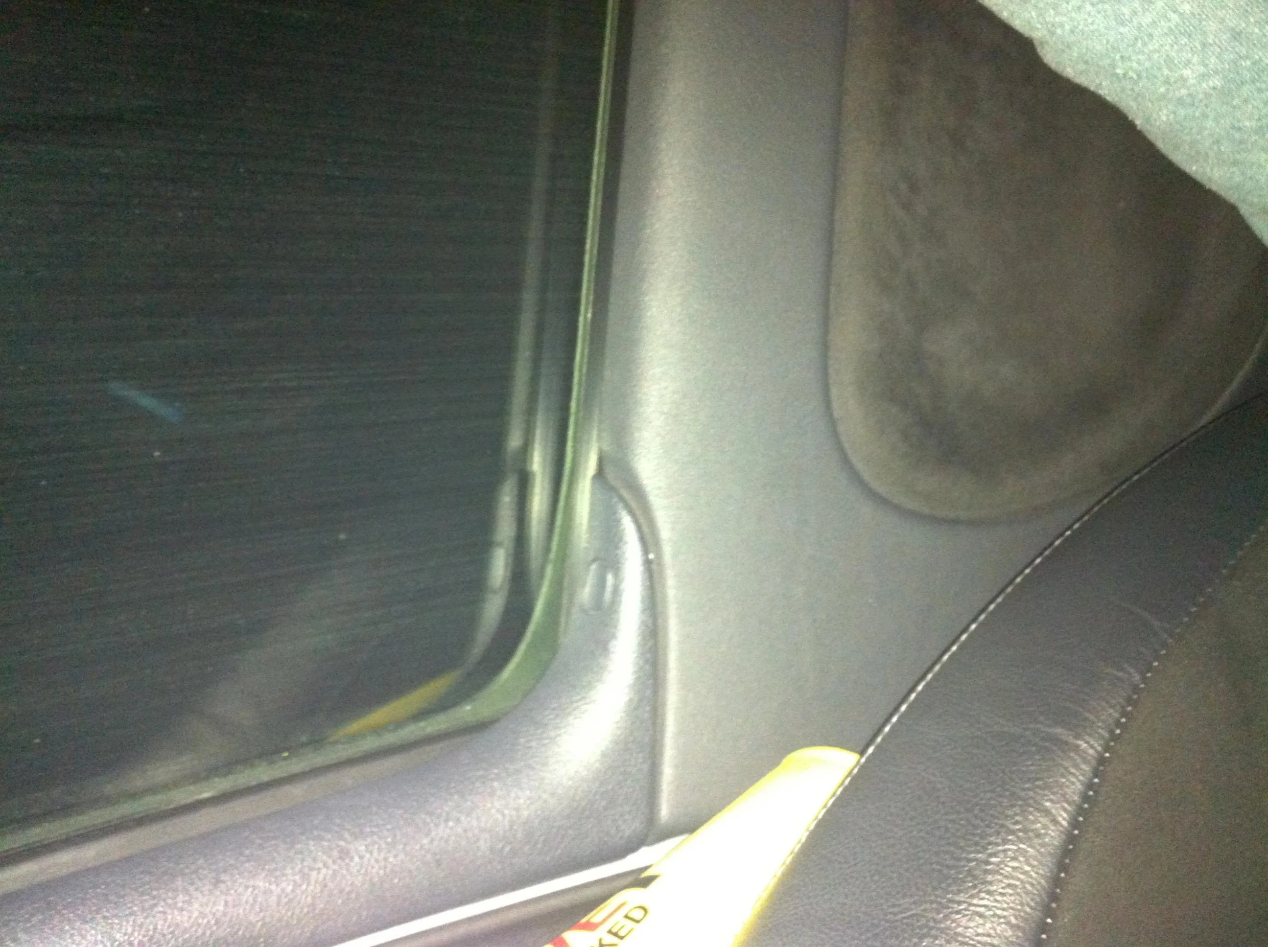

Folks,
I am hearing a dull click from my passenger door when I fully lower then raise its window.
The noise comes from the top left of the door card behind the plastic piece of trim.
It is in the first stage of raising and final stage of lowering that this noise is very noticeable, doesn't sound healthy but there are no other signs of any faults.
help please!
Apologies for the picture orientation.

sound like bracket that holds the glass as moved (corroded) the noise is glass popping in n out off line
