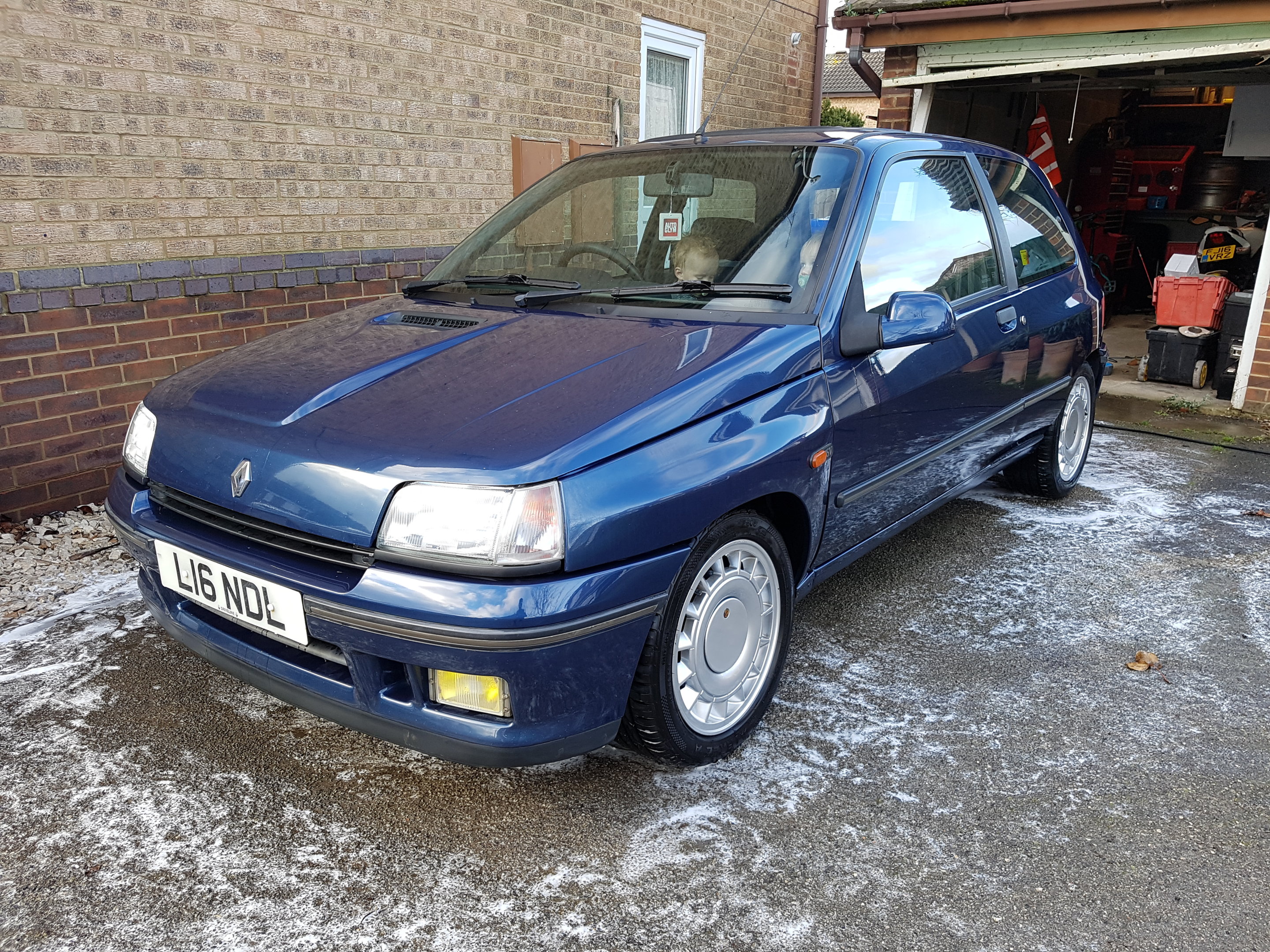

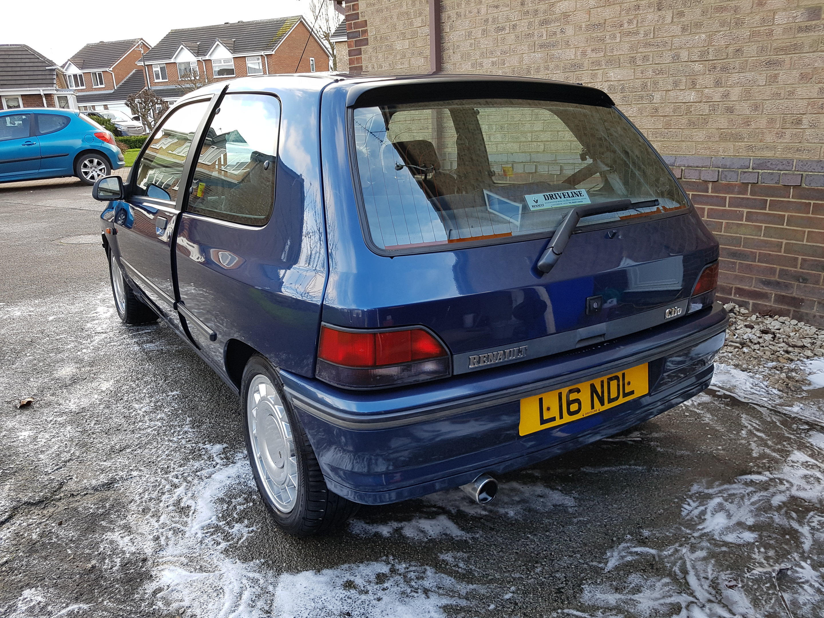

The car itself is primarily a 1 owner car with 106k on the clock with full main dealer service history once a year until 2011. It the passed through a couple of hands with next to no mileage being done until I spotted it for sale locally.

The car itself is primarily a 1 owner car with 106k on the clock with full main dealer service history once a year until 2011. It the passed through a couple of hands with next to no mileage being done until I spotted it for sale locally. View attachment 1354959 View attachment 1354960

great looking car, dealer plates still on it etc from the looks, guessing its completely bone stock?
wide investment to leave as is and run/maintain it. appreciating classics now and that looks a good example! nice buy!
That looks f**king mint, I am 'well jel', as the kids say!
Make sure to clean the lips on the rear arches and, if you're driving it over winter on salty roads, it would be worth removing the arch liners and giving it a good wash down in all the nooks and crannies once they've stopped salting. (So March? lol)
I would ask how much you paid but I don't want to know the answer if you got a bargain!!
