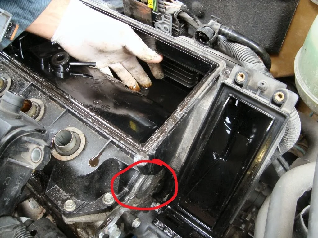

I have a mk2 Clio 1.2 16v and today I came back to it and found it'd decided to dump rather a lot of oil on the floor!
After getting the airbox our of the way, it looks like a little cap on the end of the camshaft has come off, letting oil pour out. This is on the right side of the engine, just to the left of the airbox and above the thermostat. I've circled the cap in the attached picture (which isn't of my car, just off google).
Does anyone know what this is called & where I can get it?
Also, is there anything more major to check for before just putting a new cap on & driving it again?

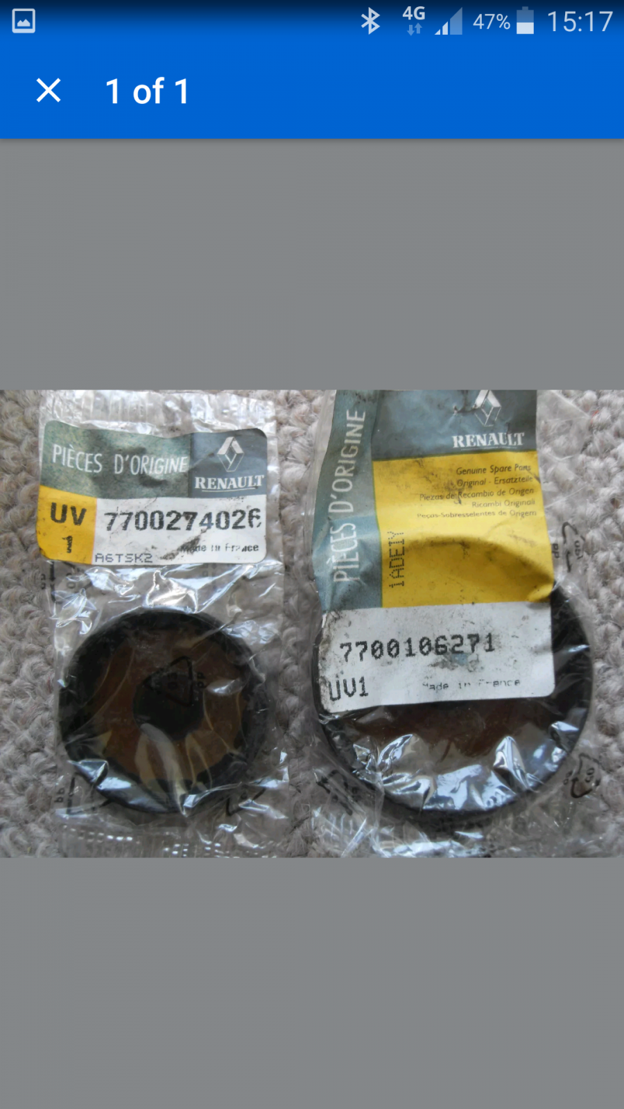

These are the ones for the sport engines but I believe theyll fit all 16v?? Google the part numbers and see mate
  Mk2 Clio 1.2 16v
Thanks :)
Googling the part numbers seems to suggest it fits all the 16v engines down to the 1.4, but the 1.2 wasn't listed.
It's a starting point though, I'll call Renault tomorrow & see if they've got the equivalent part for my engine.

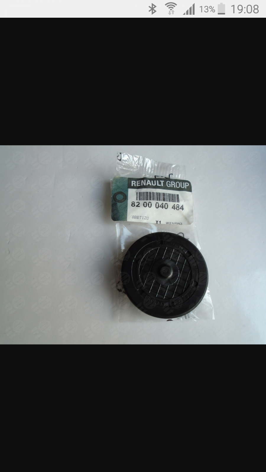

Worth a thread revival as it's just happened to my daughter's 1.2. Renault got one for me next day £7.25. For a feckin bath-plug. What a p1ss-poor design.
I was very lucky though, as I'd driven about 15 miles before getting home and having a look (tell-tale sign being the smell of burning - never a good thing! :D )
Used up a fair bit of oil (just recently serviced too FFS). Thankfully the cap just taps back into place. I tapped it 95% of the way in, leaving a small lip.
