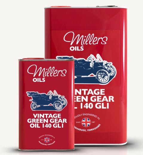

Sounds like your box of cogs might be churning completely the wrong fluid.
Sounds like Automatic or vintage gearoil if not coolant.
" Automatic transmission fluid (ATF) is a kind of transmission fluid used in vehicles with self-shifting or automatic transmissions. It is typically coloured red or green to distinguish it from motor oil and other fluids in the vehicle. "
" Green Gear Oil, GL1 (SAE 90, SAE 140), provides the lowest level of performance and is suitable for vintage transmissions. It is very similar to engine oil, having a very low additive content, but is available in much higher (thicker) viscosities to suit gearboxes with unsophisticated oil seals. "
